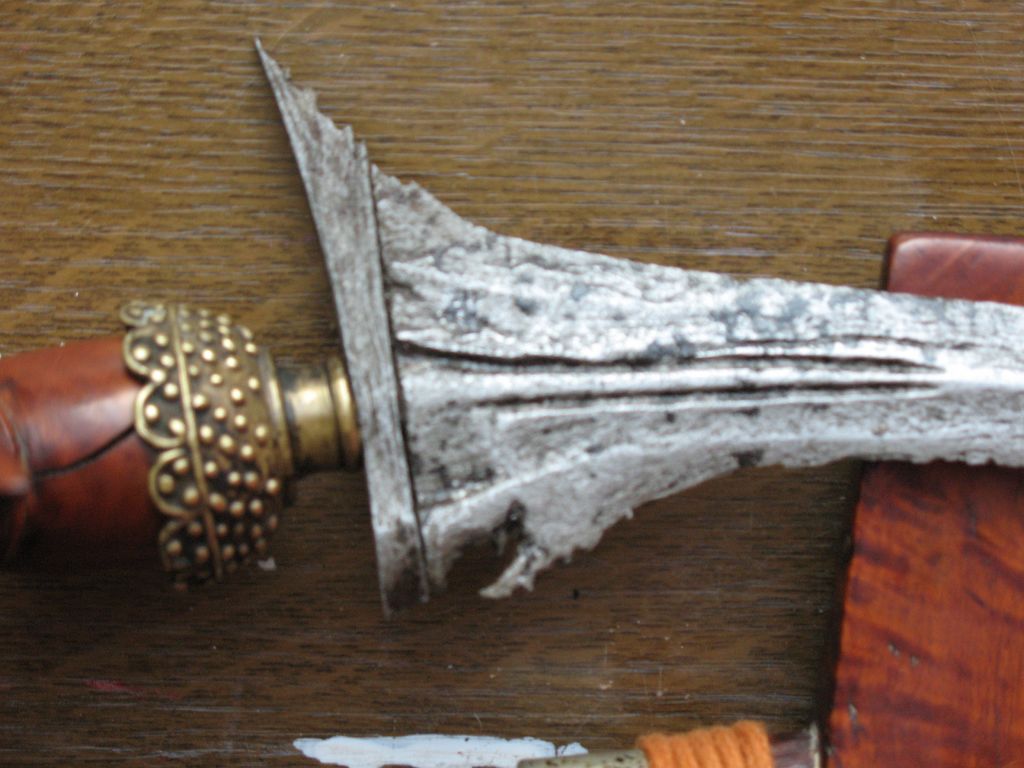

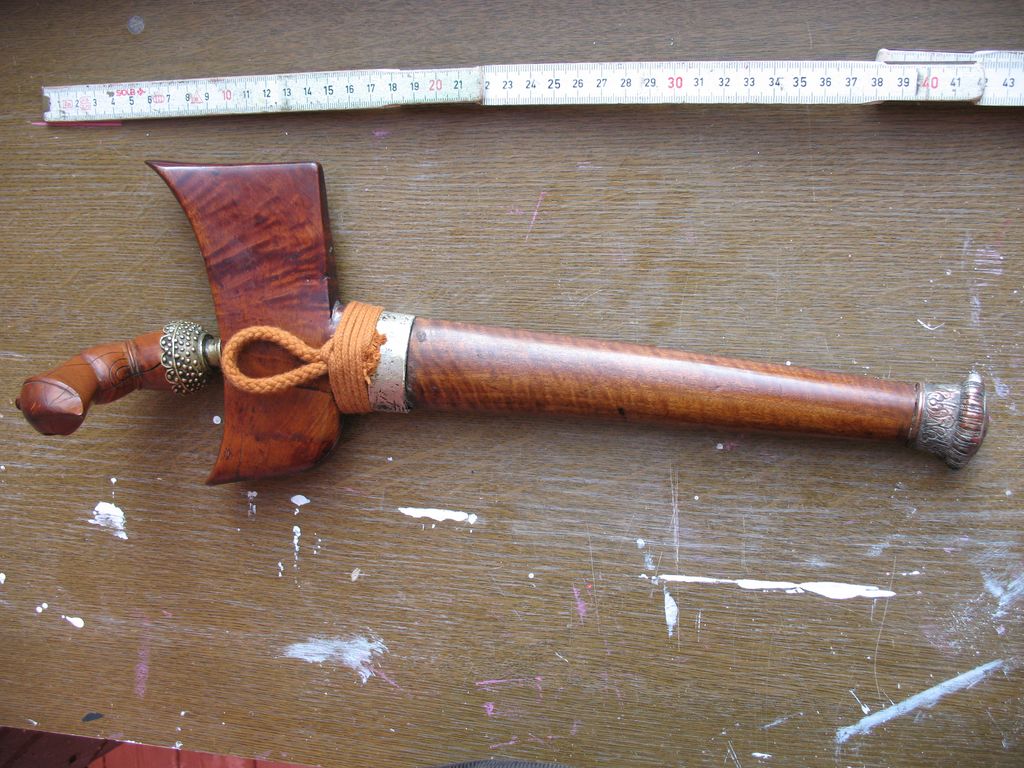

Please give some comments on this keris ?
It was offered as Bugis, but probably more Sumatra or....

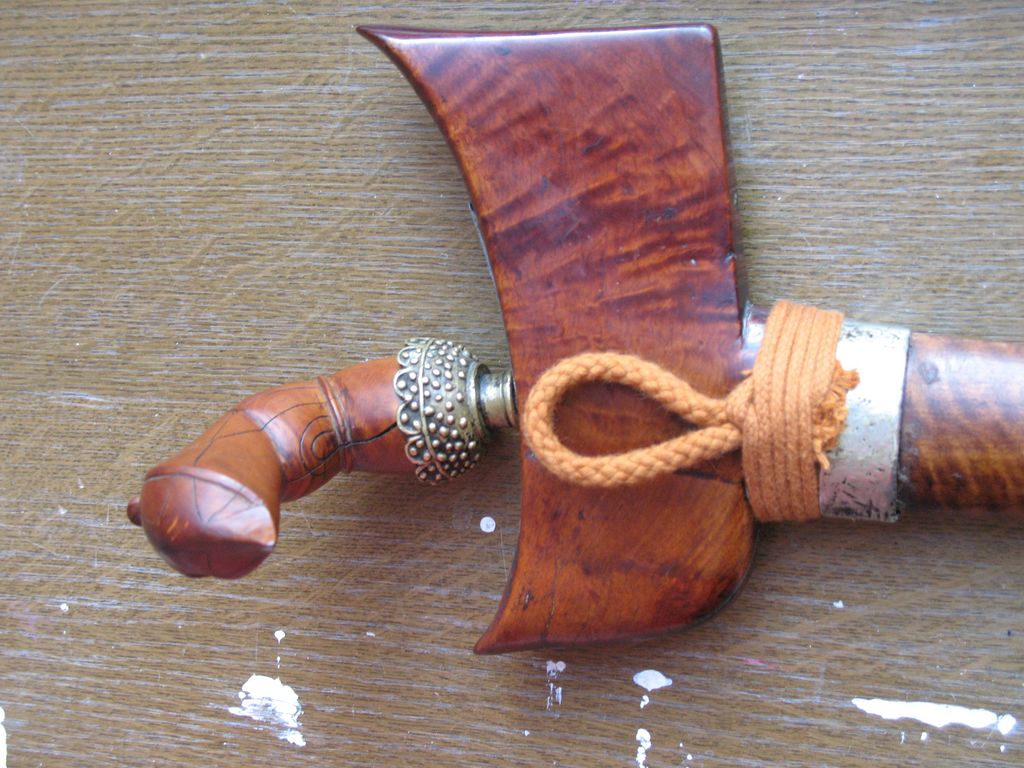

Ps. toli toli I made myself because that part has a restauration with woodfiller

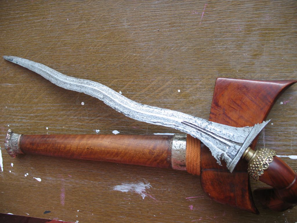

hello de keris is not a bugi but i think javanees
regards semar
Old 5th October 2008, 04:54 PM   #3
Posts: 7,297
I agree that the blade is not Bugis, though it may well be Sumatran. If i am not mistaken many Sumatran keris followed certain Javanese pakem for their blades when under the influence of the Javanese kratons.

Is the seluut malay?

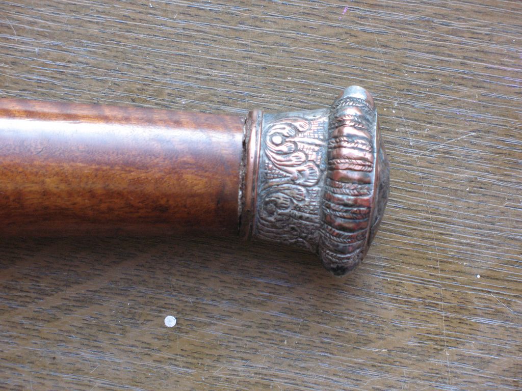

the blade looks like Javanese / Javanese influence. The selut / pendokok is peninsular IMO.

This has a toli-toli loop. Does this mean that this piece is ceremonial?
Old 7th October 2008, 04:16 AM   #7
Posts: 7,297
I think you might have missed this in the opening post Jose.

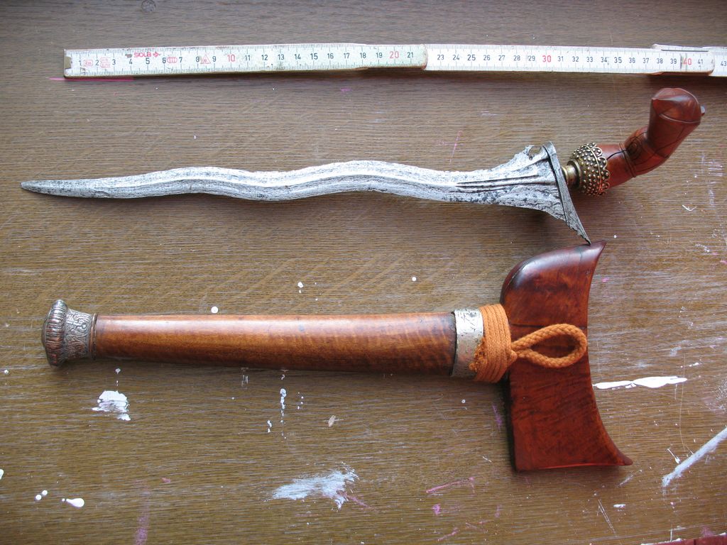

IMHO, the blade is Sumbawa/Bima not Sumatra, Lamba Lima (Luk 5). Previous owner might be a Buginese or Macassare. Both Gowa and Sumbawa/Bima kingdoms have family relations. The bottom part of the sarung/sepatu shows authentic Buginese handcraft influenced. It is common to see a blade like this in Sulawesi. It is NOT called TOLI TOLI the correct name is PASSIOSUMANGE means 'Ring of Spirit'. There is a belief that the wearer of the Tappi (Keris) with PASSIOSUMANGE attached will have a greater sense of what is happening in his area/home land. It is also a symbol of high status.

I agree with your opinon about Sumbawa origin. Thanks for explanation

Thanks all for your expertise !!!
My first sumbawa keris. cool
