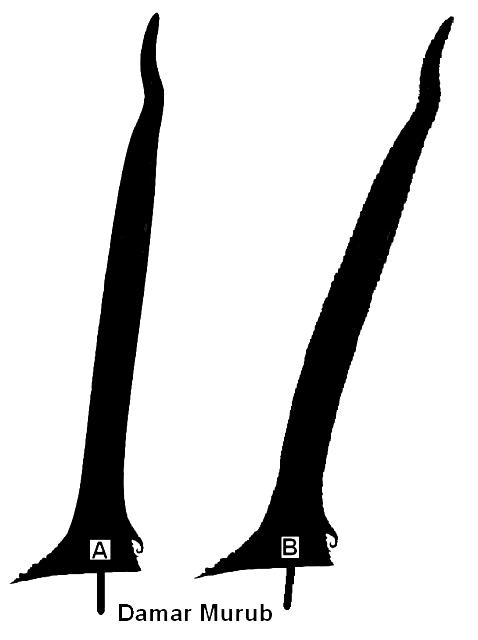

Damar murub, a name of keris dapur normally found in central to eastern Java until Bali. However, rarely we get to see this type of keris. In books, written that this dapur is of Luk 3 and some mention to be Luk 1. How and when can we tell if it is Luk 1 or 3. And why?
Below are 2 examples of dapur Damur Murub I've seen. One with a straight body and luk at the tip, and the other has slightly curve body follow by the luk.

I know that Damar Murub is a 3 luks dapur on the top of the blade (the same of your pics).There are also two other similar three luks but they are in the middle of the blade or at the beginning of the blade... but i don't remember these dapur names.

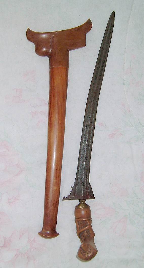

One luk ?
The curve is extreme in this blade .
When does a sepokal type form become one luk ?

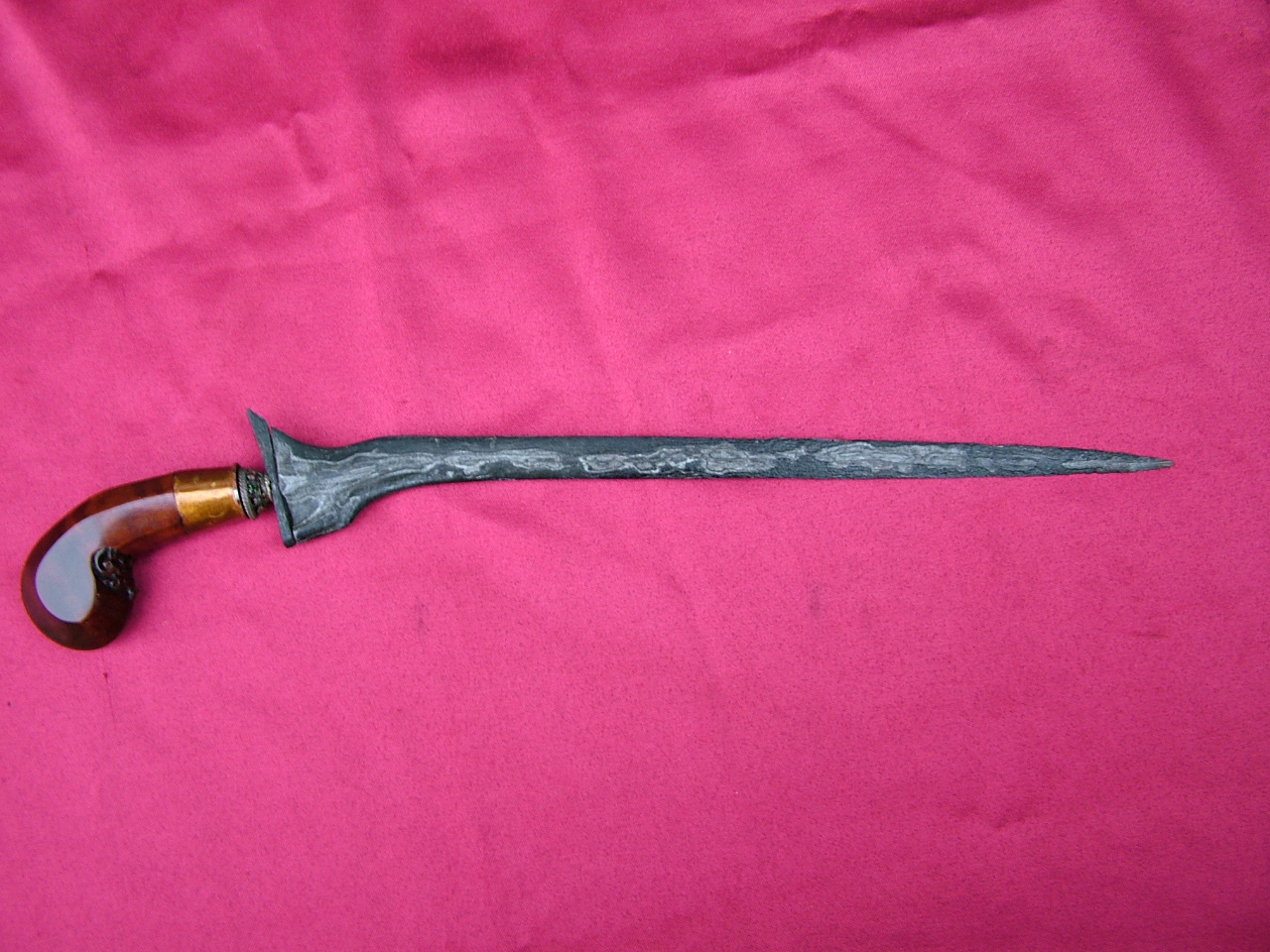

hallo marcokeris you mean this type of three loek
regarts semar

Hi Alan. I am in full agreement with your statements, but i also wonder how you count on a blade like Semar's in the post just above yours. I have always understood that the counting of luks precedes upward towards the tip. To count Semar's keris as luk 3 seems to require that we move downward from the first count. So is this seen as a lurus blade with an unusal bend?
Old 14th September 2008, 09:36 PM   #7
Posts: 7,229
G'day David. This brings us back to a previous discussion. If a keris does not comply with pakem it is not a keris:- it is a keris-like object--- or to be polite:- diluar pakem---outside the guidelines.
Semar's keris is outside the guidelines, thus in the strictest sense, and most certainly for application of any of the protocol that is used in keris appraisal, this cannot be appraised as one would appraise a keris.
The reason for any number of luk is locked into the symbolic and talismanic requirements that were called upon when the keris was made.
If it were necessary to produce a keris with an even factor, this even factor was produced in a way other than by producing something that fell outside the guidelines that govern the composition of a keris. To me it would seem to indicate that the maker was probably only a smith , or perhaps a beginner, who was not yet sufficiently knowledgeable.

Interesting to know that the Kraton Pakem does not list keris with Luk 1, as it should be Luk 3 onwards. This was also recognised by older books written. But I find the later books to be otherwise including example like one posted by Semar, called as dapur Luk 1. Is that dapur Sengkol?
Newsteel is offline   Reply With Quote

in northern Malaysia term, Rick's so called sepokal is lok 1, though i would prefer calling it lurus (usually sepokal has to be curvy).
I think that you may have missed Alan's point. If Semar's keris is outside of any accepted kraton pakem i don't think you can call it by any accepted dhapur, can you?
"Semar's keris is outside the guidelines, thus in the strictest sense, and most certainly for application of any of the protocol that is used in keris appraisal, this cannot be appraised as one would appraise a keris."
