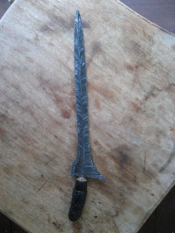

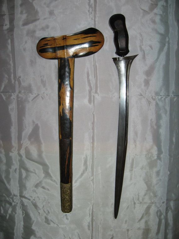

I like this keris, it is striking to the eye feels nice in hand, to me.
In shape it is similiar to the earliar piece I posted. This keris would be late 20th C? Regardless, it is skillfully executed I think
Are there rules of thumb regarding identifying old v new keris?

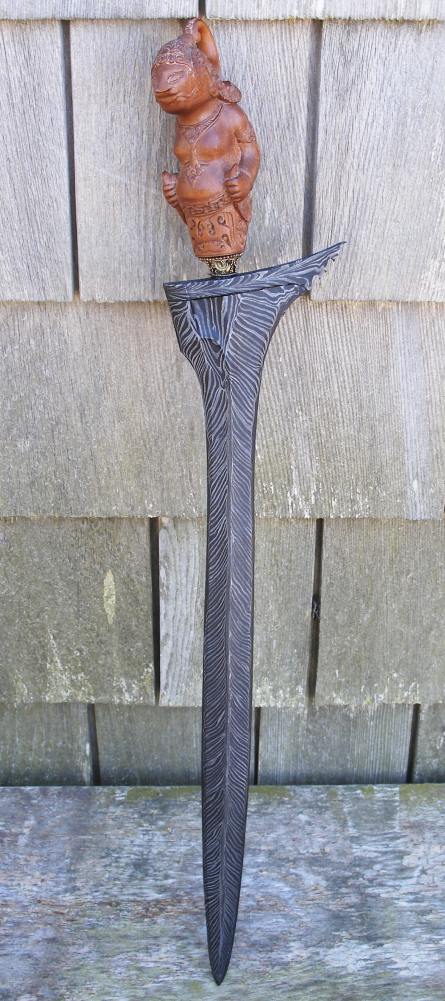

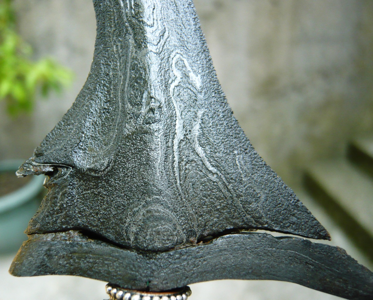

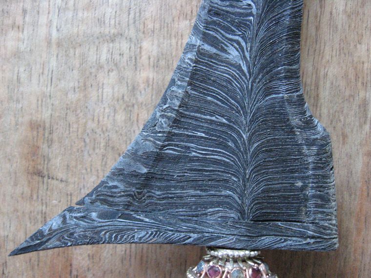

Determining age can be a problem; many new keris are artificially aged and sold as antiques .
Your blade appears to come from Madura and may not have a core; hard for me to tell; if there is a core it is thin .

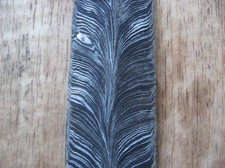

The blade seems to have been given a fairly heavy etching as it appears topographical . I have a similar Madura blade .
Here is that pamor type with a normal etch see pic below .
I don't think that this was done to deceive , rather more for effect .
I believe this is newer work .

I can see the steel core in your keris, but Scratch's example looks like having no steel core, or simply the pamor layering is "nerjah landhep" which is considered bad

We must also remember that keris pamor Buntil Mayit is also generally a coreless blade .

When we talk about blades with cores, and blades with no cores, we need to keep a few things in mind.
First is the age of the blade. Is it old? Current era? Brand new?
If it is an old blade, and it has a manipulated pamor, it will most certainly have a core.
However, a new or current era blade might have a core, or might not.
The blade with the core will be the superior blade to the one with no core, however, the blade with no core could well be a superbly made blade, with no weld flaws, and with beautifully executed pamor.
What you get, should be reflected in the value of the blade.
The new or current era blade with no core should cost less than an equally well made new or current era blade that has been constructed with a core.
Now, if we talk about older blades, and we look at manipulated pamors, those blades will often not be as well made as the more recent blades, they will certainly be in a lesser state of preservation, and if they are any good at all, the value will be multiples of the new or current era blade.
We need to be realistic in the appraisal of a keris.
Its no good simply saying that something is "good", or "bad", or anything else for that matter.
We need to appraise the blade within its applicable parameters.
This blade that Scratch has shown us is a current era blade; it appears not to have a core, however, the pamor has been well managed, and I cannot see any obvious flaws in the welding; the garap (coldwork) is good. Overall this is a good example of its type.
Yes, I agree, if it had been made on a core it would better. If it was pre-WWII it would also be better.
However, I'll put money on it that Scratch did not pay the price of a current era keris made on a core, nor did he pay the price of a pre-WWII keris.
This is a good example of its type, and it should not be criticised for being what it obviously is not.

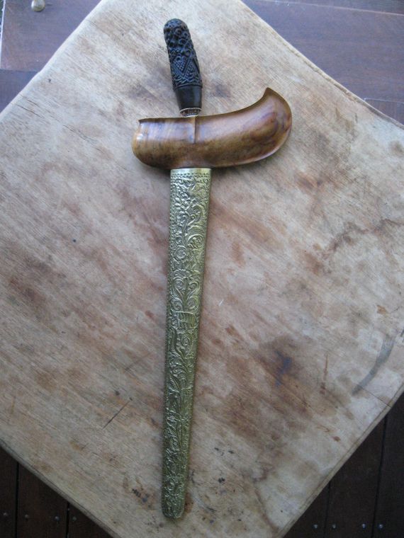

I have acquired a small keris collection unexpectedly. It may or may not have been a foolish decision I do like the collection and am enjoying learning more from all the informative posts and threads Thanks to All for sharing.
A G Maisey Thanks for sharing cengkrong info and visuals in my first post. Looking at the photos you povided and the picture in Kris Gli Invincibili, pg 41, I believe I have an example. are these uncommon? 18 5/8 blade, 24 3/4 in scabbard. Quality wise/weapon wise this is at the higher end I feel.

That's a nice balinese keris. Dapur cundrik if I'm not mistaken. The mendak is missing. The scabbard has a pendok.
Nice piece. Congrats!

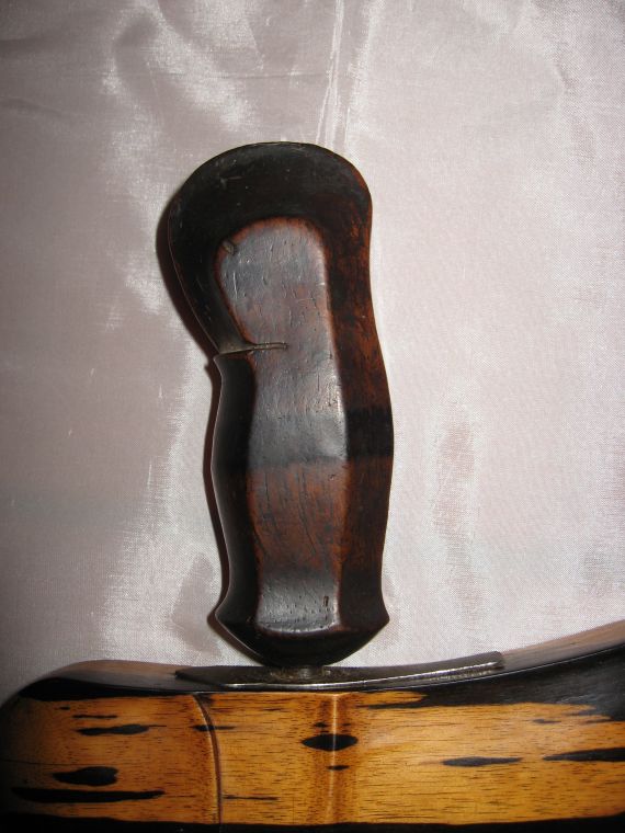

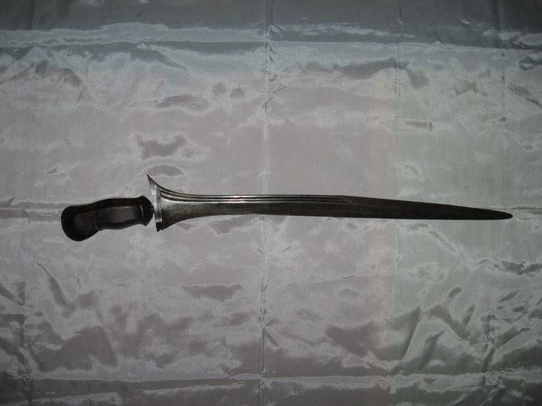

Cheers Henk I had thought this blade to be "straight but with an unusual slant". Piece has a seperate gongo. Balinese

That looks like a keris pedang or Ligan .

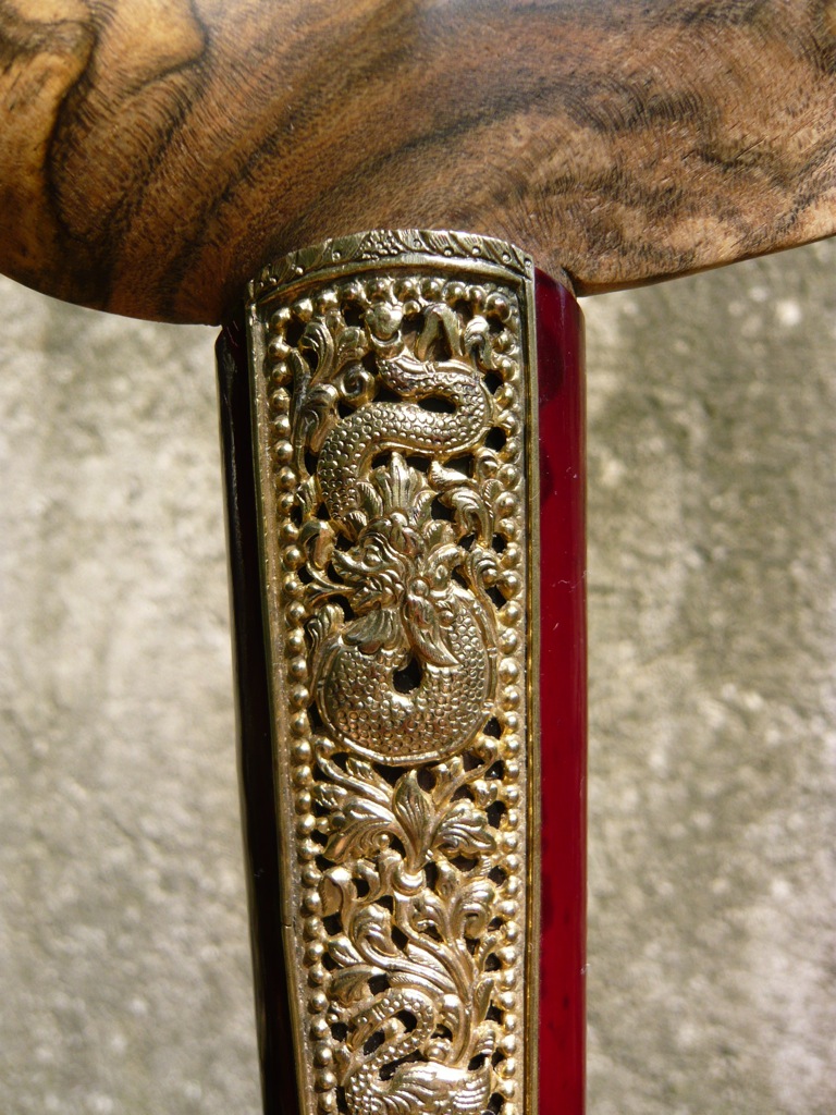

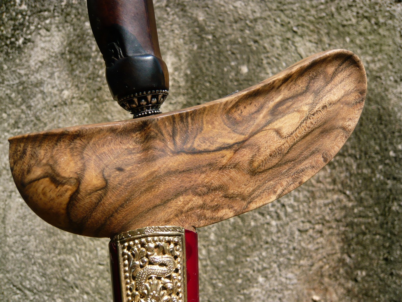

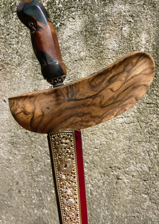

Mr. Ganjawulung gave me this gift (sarong and pendok) some time ago. At that time the gajaman was not till completely finish (there was not the final polishing). Slowly slowly i have finish the work and then i have find a blade....but i don't remember what kind of wood is this and what is the name!
Dear Ganja please can help me to know the name?

I dislike intensely getting involved in dhapur discussion, because there is this tendency to apply Javanese dhapur names to keris forms from various other places, where the same name often will not apply, and also because even within Jawa itself opinions on the salient features of particular dhapurs can vary greatly.
However, this keris is an interesting form, and I will throw a comment into the ring.
The pawakan of this blade is certainly very like unto a cundrik or cengkrong, but it appears to have a rolled edge, or back-pipe as the continuation of the wadidang, so I don't think we can apply these names.
I think it might be able to be called a ligan, as Rick suggests.
Yes, there is no uwer fitted, however, in my experience, uwer are very seldom in evidence in the vast majority of Balinese keris, especially older ones.
