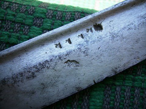

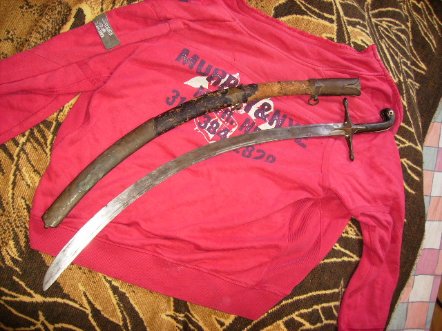

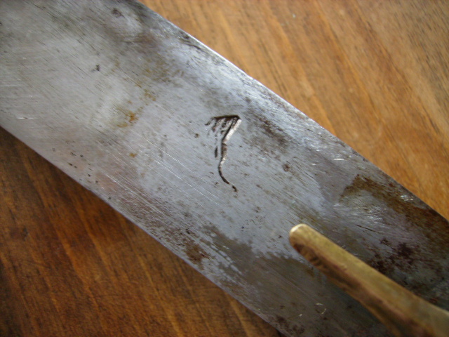

My friend in Bulgaria, the same person who owns a bunch of nice yataghans, recently obtained this kilidj and asked me to post it here for comments, which I am most happy to oblige. His main question is what would the approximate dating of this piece be? Also, does anyone have any insights into what appears to be a marking?

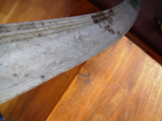

Am I seeing a mechanical Damascus pattern?

I also see a mechanical Damascus pattern. The marking on the blade is a crude Turkish Ottoman tughra stamp (a part of it). Similar stamps, but of smaller size, appear on scabbard fittings, and very rare on blades. I also think this sword is a shamshir, as I can not see a well defined yelman. Hard to be sure of exact age - but it's at least 19th Century:-)

Hi, a similar mark is discussed here!
http://www.vikingsword.com/vb/showthread.php?t=6111

Thank you all for the responses. There is a mechanical damascus pattern indeed. I would have never figured out the marking myself. Well, now there are at least two examples stamped with a tughra on the blade. I suppose it would be hard to explain why certain swords carried a tughra on the blade. Could they have belonged to an arsenal, or was it an inspection mark put on blades? Maybe someone has better guesses than mine.
One more question - given the shape of the blade and its pattern, do you think it was a locally (which for the Ottoman Empire encompasses quite a large area) forged one, or imported from somewhere else, such as India?

Teodor, the crossguard and hilt particularly look very "Ottomanish". The scabbard fitings as well, so my best guess is that the blade is Ottoman as well, not imported, and not Indian. As for the stamp - my guess is that it was put for decoration purposes (sort of "to impress"). I do not think it is a sign of "quality inspection" or arsenal, or we would know and see more of them.
Also, the original Tugras stamps are usually quite elaborate miniature artwork, and this one is quite large and fairly crude, so I think it was an imitation attempt (this is only my best quess:-)
