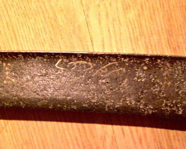

Default yatagan inscription for translation

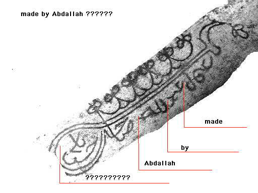

Can someone translate that inscription for me? Thanks
Old 13th July 2008, 12:34 AM   #2
Dom
Dom's Avatar
Join Date: Oct 2005
Posts: 1,142
Hi
unfortunately incomplet
but may be someone will complete it ??
à +
Dom

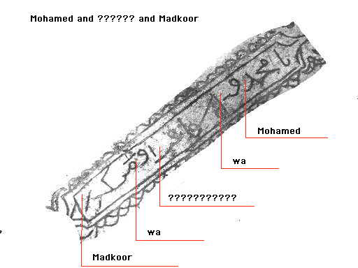

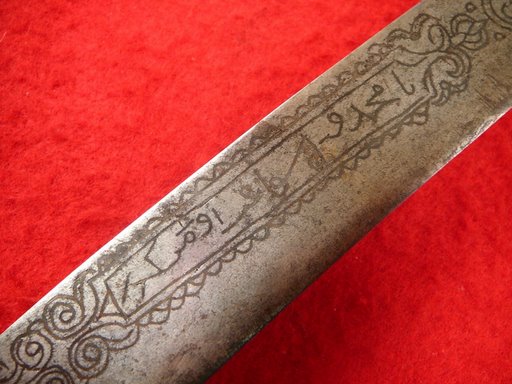

Old 14th July 2008, 07:16 AM   #5
Valjhun
Valjhun's Avatar
Join Date: Dec 2005
Posts: 692
Thank you very much, Dom.
Is Madkoor a name? Possibly the owner?
Old 14th July 2008, 12:22 PM   #6
Dom
Dom's Avatar
Join Date: Oct 2005
Posts: 1,142
Yes .. Madkoor or Madkour
no firm spelling as far as it's trancripted from an other alphabet
only the sound is important
à +
Dom

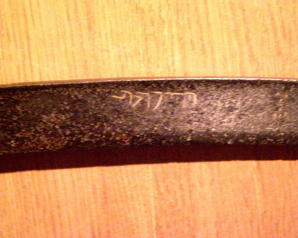

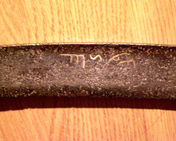

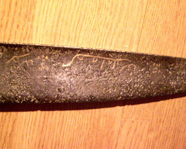

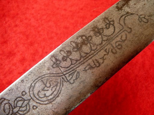

Old 14th July 2008, 01:04 PM   #7
Henk
Henk's Avatar
Posts: 1,209
Dom,
May I ask you if you are willing to take a look at the writing on this yataghan blade? Thusfar no one was able to tell what language it is or to translate it.
I'm afraid you're the only one at this moment who might tell me something about the writing. Thanks in advance.

Old 14th July 2008, 03:20 PM   #9
Zifir
Zifir's Avatar
Location: Istanbul
Posts: 228
hi,
the first script is:
Ya Muhammed kıl şefaat ümmetindendir (O Muhammed! Intercede on the day of Judgement on the behalf of ....... who is one of your Ummah (community of believers) -usually there comes the name of the owner after "ümmetindendir" but in this one we don't have it. Yet we get the name from the second script:
Amel-i Abdullah sahib Hasan Beşe (the title "beşe" donates that he was a janissary)
Our swordmaker, Abdullah, (if he was the one who wrote the inscription) was not much a literate person as it is clear from his spelling of "ummah" so Dom still did a great job
Zifir is offline   Reply With Quote

Zifir? Have you translated the inscription on my yataghan or Henks' one?
Old 15th July 2008, 09:04 AM   #12
Henk
Henk's Avatar
Posts: 1,209
Valjhun,
I believe Zifir completed the translation on your yataghan. Great job!
I wait ancious till Dom returns, but maybe Zifir could help on my inscription as well.
Old 15th July 2008, 10:02 AM   #13
Zifir
Zifir's Avatar
Location: Istanbul
Posts: 228
Valjhun, it was your yatağan that I translated.
Henk,
At first, the inscription on your yatağan seemed all gibbersih but then I recognized the formula which I translated in one of my earlier posts.
It is:
Yemliha, Mekselina, Mislina, Mernuş, Debernuş, Şazenuş, Kefeştatayuş, Kıtmir
These are the names of Ashab-i Keyf (Seven Sleepers) and their dog.
Still I don't have any clue about why they put these names on a yatağan.
Old 15th July 2008, 11:10 AM   #14
Henk
Henk's Avatar
Posts: 1,209
Zifir,
Thank you so much for your efforts. I already asked so many people for a translation or the meaning of this writing. Even someone who spoke Farsi and the old turkish language was not able to help me out.
I do know the story of the Seven Sleepers in the cave near Ephesus. Don't have an explanation either why the names of these Sleepers are written on my yataghan. But the legend is mythical.
Çok teşekür ederim, Zifir.

I have asked a Bulgarian scientist, who studies symbolism on Balkan weapons about the significance of the Seven Sleepers inscriptions on yatagans. She explained it to me quite well, and here is my very poor attempt at a summary:
Even though it was originally a Christian legend, the tale of the seven sleepers was adopted by Muslims as well. On the surface, the legend is about strength of faith. It could also be an alegory of death and salvation. When a person dies, he goes to sleep, only to be awakened by the Almighty. Therefore, if the owner of the yatagan dies in battle, he can expect to be saved by Allah and enter Paradise. This ties in well with the concept of martyrdom.
I am not sure if this is the correct explanation, but it makes a lot of sense to me.
Teodor

Teodor, it certainly makes sense.
If it is like you said the correct explanation, i certainly can imagine something why these names are put on this yataghan.
Very interesting subject. Thanks again.
