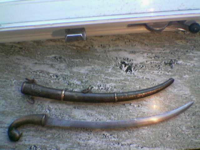

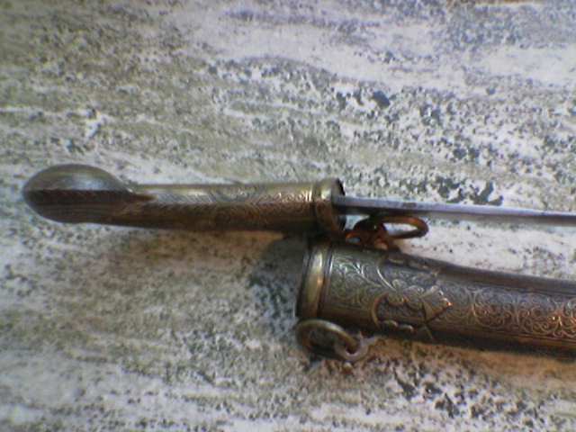

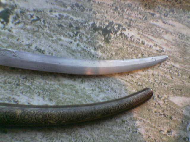

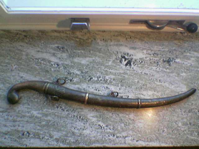

I found this sword in Marrakesh, together with a very nice Nimcha, a couple of years ago. According to the dealer, who also had a lot of Sefardic religious items to sell, this is a Jewish sword from the Atlas mountains.
I have looked in several reference books but haven't been able to find anything even close to it?
Does any of you recognize what it is?

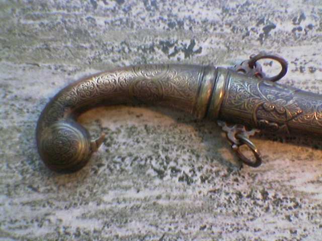

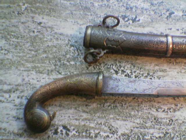

Thank you for posting pictures of this most unusual sword. First, I do not think it is a Jewish sword from the Atlas mountains. The handle seems typical of Indian sword handles. You see both antique and contemporary examples with the "parrot" handle. The scabbard, especially the belt loops, appear very Moroccan to me. That, plus the overal decoration on the scabbard, reminds me of similar decoration found on Moroccan Jambiya. If the handle decoration matches in patina and decoration to the scabbard, perhaps this is a Moroccan sword with an Indian inspired handle. Being that it came with a Nimcha could be suggestive they both originated from the same place. A neat and unusual piece.

Excellent observations!! You are right on target noting the similarity to Indian bird head khanjar hilts with distinct beak protrusion. These occur on Indian short swords, with most seeming to originate in northern regions, particularly Rajasthan. The blades are of varying length and form, some are serpentine(nagan) with shikargar (hunting scene) motif and some are about 22" with sosun pattah blade and reinforced armor piercing point.
I also agree with your note on the Moroccan motif. It is interesting that the scabbard carries both side mount carrying rings as well as an opposite ring at scabbard throat in Arabian favored baldric style. These baldric mounts are most typical for the Moroccan 'khoummya' daggers. The high relief motif on the scabbard also suggests the 'agrab' (scorpion) talismanic symbolism found on many Arabian scabbard mounts. Many of these were manufactured in India, typically Hyderabad, for export to Arabia.
The trade routes that prevailed between India's Malabar Coast, the Red Sea and the Maghreb were long established and account for the diffusion of considerable weapon forms.
The presence of Sephardic Jews of course were well established in Morocco from early times after fleeing Spain. They were outstanding artisans who were known for brilliant workmanship on weapons mountings, and were also trade merchants who travelled with Saharan caravans. It would not be unreasonable to consider such a weapon as this mounted in Morocco and influenced by the khanjar form hilts from India. While not actually a Jewish sword, it may well have been crafted by a Jewish artisan and traded by that community.

There is often considerable difficulty and constant debate about the application of specific terms to certain weapons. It becomes even more complicated when a weapon is hybridized or outside its presumed cultural sphere. In this case, pending more conclusive research, it would be most safe to rely on description more than specific names, thus short sabre or hanger from Morocco with Indian khanjar form hilt.

Tim, Thank you very much for the direct response and for the pages for the reference in Spring's outstanding book. It must be remembered that the term 'birds head' is quite vague in description as in many cases we may be referring to a defined likeness or widely varied degree of stylization. The picture of the kopis posted by Yannis illustrates a stylized birdhead with hooked beak which forms the nock for the base of the hand. The trilobate pommel of the karabela is considered a birdhead form, as are the pommels of the so called Berber sabres and the Algerian flyssa (both highly stylized to where there is considerable dispute over what creature may be represented).
