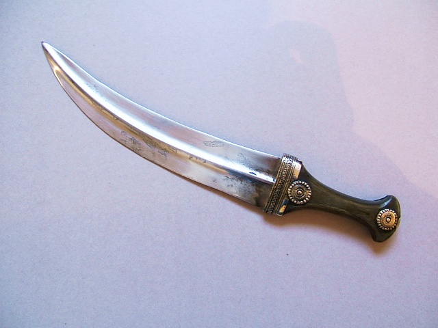

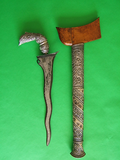

On pamored keris I use mineral oil mixed with jasmine on wootz I also use mineral oil if you use waxes on wootz there is a danger that the wax could strip the finish. For all others with cleaned light patina blades I use Bri-wax.
Jambiya=Briwax or Renaissance wax.
Keris=mineral oil

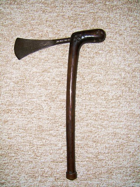

Axe with patina=Mineral oil
