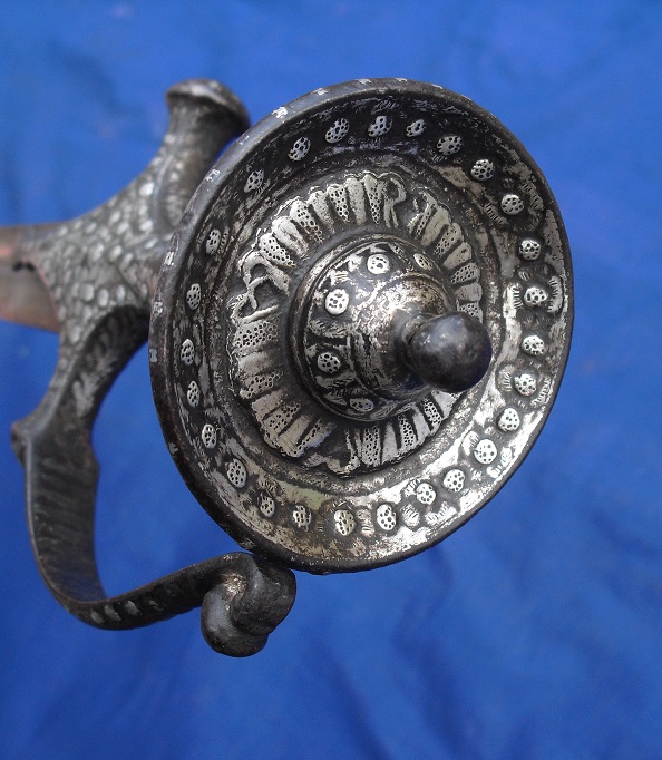

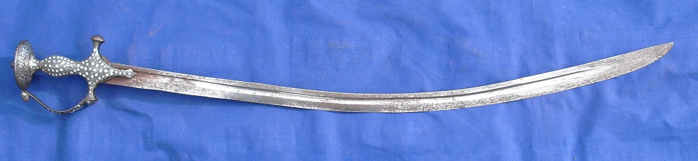

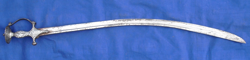

Hello, first time poster here.

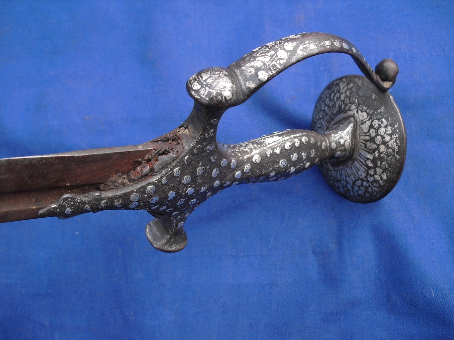

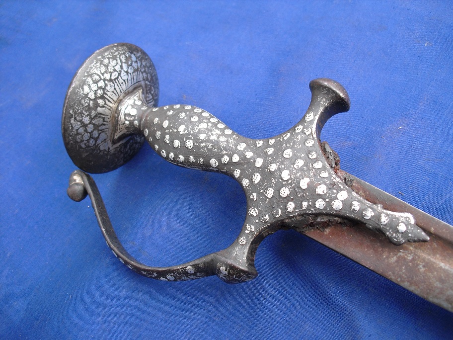

I recently acquired this tulwar from Matt Easton, and I would like your opinion on the age of the sword. The blade came partially cleaned and is polished bright under the dirt and rust.

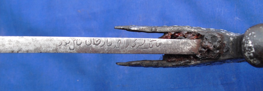

It also has an inscription on the spine of the blade, and it would be great if someone could help me translating it.
Cheers
Gernot

Blade is (safely) 19th century.
But my antennae are twitching when I look at the adhesive : too much of it, too clumsy, too new-looking. Tough to be certain without personal inspection, but it looks like loose handle being fixed or a totally new handle was attached to the blade pretty recently. The latter looks more likely: the blade is very clean under the langet, although it still has rust close to the edge and spine. My guess it is a composite.

Thanks for the reply ariel, 19th century was my uneducated guess as well.

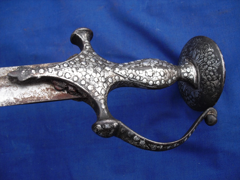

The fitting (?) of the resin seemed a bit crude to me too, but I don't have a lot of experience with this kind of hilt construction.
As for the clean part under the languets, I did not mention it, but Matt described the blade as completely black when he received it, and he has done quite a bit of cleaning. As you can see in the attached pictures, on the other side of the sword the rust also covers the area under the languet.
Cheers

A good friend of mine who lives in Kanartaka in India has translated the text on the back of the blade. Here is his answer.
It says: Malik Sarkar Ahmad Yaar Khan Talpur which translates as "The Owner Sarkar Ahmad Yaar Khan Tal Pur" So the blade is from Talpur! The writing is in Urdu.

Here is a link to another inscription.
http://www.swordforum.com/forums/sho...on-translation
Ok I go with Ariel, the adhesive is far too much in compare to other tulwars, and more than need to be, so it it is likely that this is a newly marriage.
Although the text says Talpur, the hilt is not Talpur. Other hilt types could have been used in Sindh - but it is not typical.
Wow, that's great. Thanks a lot. It seems, I have some reading up to do now.

What unnerves me with this tulwar is a pretty good set of hints that the handle might have been replaced very recently.
Whether it decreases the value of the renovated tulwar ( taking into account the commonality of the process) I am not sure and would like to learn opinions of Forumites.

The words Sind and Talpur have been mentioned several times, also in connection with your tulwar. However, your hilt is not a typical Talpur hilt, for such a hilt you will have to look at Jim's article at the last picture. The tulwar at the botton has a typical Talpur hilt.

Hi Gernot,
it is unclear to see, but maybe the tulwar was opened and nickel- or chrome plated. The last picture from your first post makes me think so.
This could be the explanation for the wasteful usage of adhesive.
Ah, is this hilt style attributed to this particular dynasty or rather the general region?
The sword that pictured right above has a hilt with a shape very similar to the one on my sword though, perhaps traded in or gifted, as Jim mentioned.
Hi, Roland,
yes, that could explain why it is still mostly bright and shiny under the dirt.
Is there a way to verfiy that?
Curious that it seems to have been neglected so badly afterwards.

As Jens has well noted, it is very hard to apply a distinct hilt pattern to Talpur use, just as with Sikhs, Rajputs etc. and particularly by region.
The images in the article illustrate some of the spectrum of hilt types which were apparently associated in these cases.
Here I would note that in a number of cases I have seen there are tulwars with this knuckleguard hilt which MAY have been attributed to Talpur use through association with this very article.
This is the kind of broad assumption which can often occur with simple example/image association from references and articles without further corroboration.
In my opinion, the 'open' hilt (without guard) seems more likely (as Jens has noted) for the Talpur use in this context, as I personally regard the open hilt as more of a 'court' or dress sword, which would seem more in place with these apparent presentation blades.

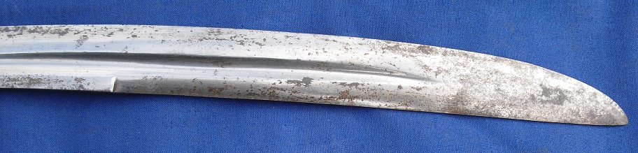

In this example discussed, as Ariel observed, the application of the material securing the blade is not consistent with methods of most earlier joinings, and I am inclined to agree this is a more modern instance

Gernot, whatever the case may be with the present mounts on this sword, the blade on this sword is remarkably connected to the Talpurs, and the article and book Ibrahiim has noted would be excellent sources for your continued research.
