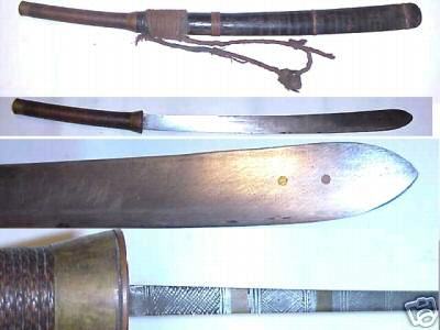

Gene
Brass inserts very interesting? I am leaning now towards Assam and Burma ot even Thai? I have seen those brass inlays in some older Dhas before. It may be some form of dha the tang is straight or slightly upward in angle similar to the dha pictured. Mark what do you think?
Lew

Lew,
I've been so hung up on the bolo blade shape that I'd never noticed how 'dha' like the back end of the blade was.
I've had a few Dha's over the years, but never seen one with the handle off.
kronckew, do you know what those knives are called? It certainly looks like its somewhere between one of them and a dha....
here's the back end compared with Lew's brass inserts.

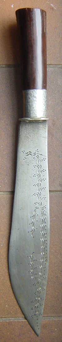

Old 21st June 2008, 04:14 PM   #8
Posts: 5,998
Here is a more recent example with interesting scabbard decoration. Teak, aluminium amd epoxy type resin? handle.

This is great!
I can make a handle like that fairly easily.
Notice the similarities in decoration style with the new one Tim?

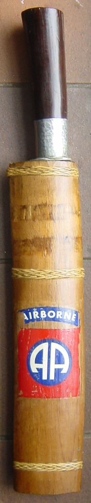

Old 24th June 2008, 06:15 PM   #12
Posts: 10,860
82nd Airborne, hoooahhh!
