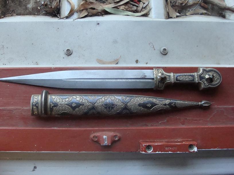

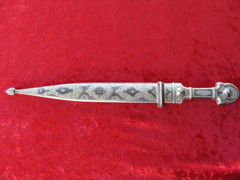

Found some time today to photograph the other Kindjal I have here.
Ex Butterfield and Butterfield
I welcome any comments including Jeff's if he is not gun shy now.
There is a collectors sticker on the rear of the piece stating it to be from Tiflis or Erevan, with a silver hilt and scabbard with bold Niello decoration, reverse of hilt and scabbard with neillo florals and faint remains of a signature, circa 1860.
I don't consider the craftsmanship...there's that word again..of the blade to be as good as the previous Kindjal but the rest of the piece does show superior craftsmanship. In a martial application though, this piece is not as quick from the scabbard or through the air or as comfortable in the hand? Is there a reason for this, is it purely a status/display piece?
There is an issue I wish to fix too, there is a collectors sicker that is over 10 years old and is stuck pretty good on the reverse. If I remove it, it will come away in pieces and I will need to use chemicals to clean the remainder off, will this effect the Neillo application?

... In a martial application though, this piece is not as quick from the scabbard or through the air or as comfortable in the hand? Is there a reason for this, is it purely a status/display piece? ...
Well Gav,
It could be that, decoration and embelishment seldom imply efectiveness. It appears that operational weapons for field action often offer a plain look, whereas decorated items are for showing off ... be them luxury pieces used by rulers and other big shots in cerimonies or the like, or low profile stuff for souvenirs, either for tourists or for the boys to bring back home.
Fernando
fernando is offline
Old 20th May 2008, 09:13 PM   #4
Butterfield or not, I have an uneasy feeling about it.
The niello looks very fresh and remarkably intact: not a scratch, not a missing segment. Repousse has a feel of being stamped.
The wooden inserts ( handle) are light in colour. The incised lines at the tip of the scabbard are shiny and the edges look sharp. The blade has strange proportions and is too clean. The "buttons" on the back of the hilt are poorly flattened, very crude. Are there any markings?
I understand, of course, that photographs are not an ideal way to evaluate antique items, but..... It looks to me as if it hails from the same " workshop" as the first one.
Sorry, I am not enjoying bringing bad news....

As always - very good observations Ariel. I completely agree.
Gav, I have a comment about the term "craftsmanship". It'd be deceiving to think of it in isolated manner, i.e. without detailed comparison of quality, technique, design, etc. To produce anything requires work, skills and effort. But as Ward said - one has to be critical of any item. Just because it looks like someone "worked" on it, does not mean much. Even if it looks good and wonderful... unless you know exactly what to look for... is irrelevant in terms of collectors value!!! One will be able to see the difference only by studying, handling and comparing as many pieces as possible.

I'm with Alex and Ariel on this one. Have bad feeling about it. The blade most especially looks to much like the new ones. The quality of the niello and silver work is suspect. Some more pics of the blade may answer the age question.
Hope I am wrong for freebooter's sake.

Looks more recent to me and the incised lines are pretty sloppy not something you would see on an older piece. Everything looks too fresh and new to me. Artzi has a number of older examples in his sold section here is one for comparison.
http://www.oriental-arms.com/item.php?id=2601

Oh dear gents, glasses please, no offense taken or ment on my behalf.
I will have to go back to my old camera and with bad lighting and show all the losses of niello that there is much on the reverse, this in turn will also show the honest age patina that covers the silver and neillo and the chiseled releif. If I could get a good image of the cartouche to the rear that I have cleaned, there is a forgein script within it covering 4 lines that is now so rubbed, even if I knew the lingo, I do not think I would be able to read it, but it looks to be in the style of a presentation.
Same work shop Ariel, I will have to take a photo of them side by side for you too compare....ouch
The blade it is true has suffered a very bad clean I must say, that will be fixed, I know not of any wood that you mention either, what I see is only a coloured woven material that show genuine period age.
The scabbard, oh I wish you were sitting at my desk... I can see every chisel and incise very clearly, and there is not a single sharp edge to the acorn at the base, it a shame how the 3 dimensions that you have when holding a piece cannot be presented correctly in 2 dimensions.

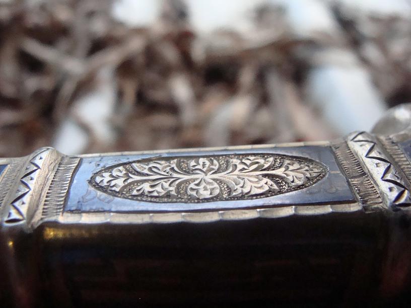

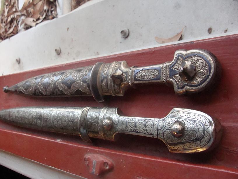

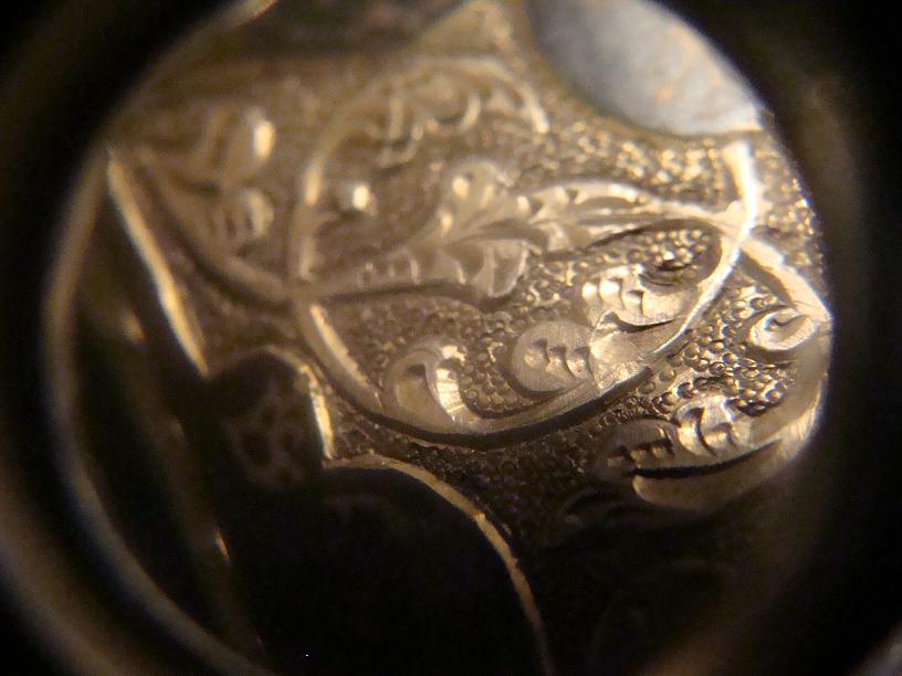

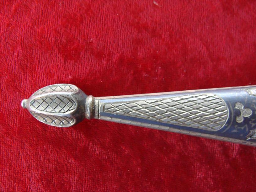

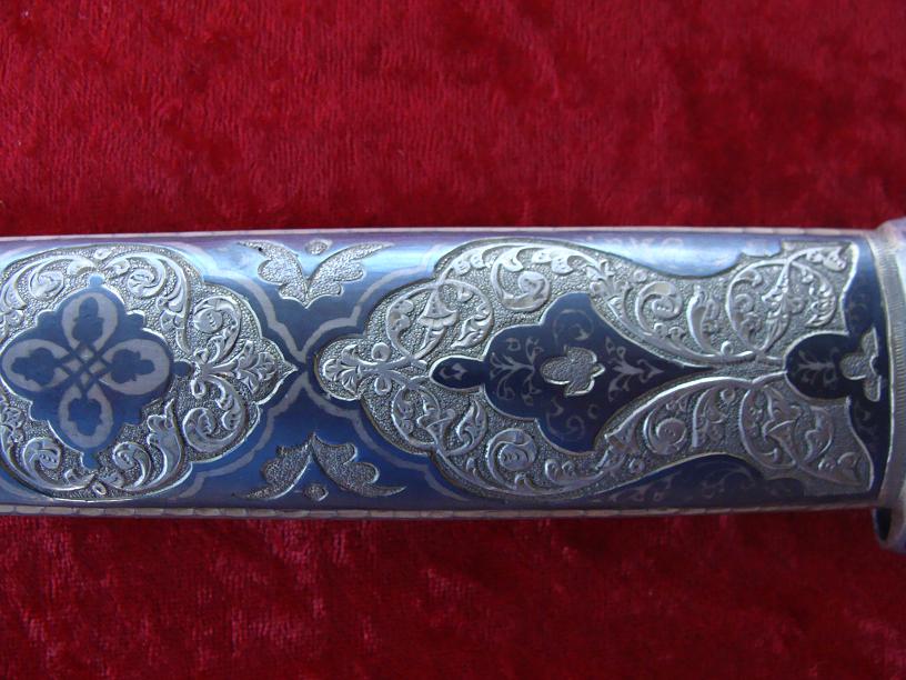

Photos in natural light rather than having the piece backlit.

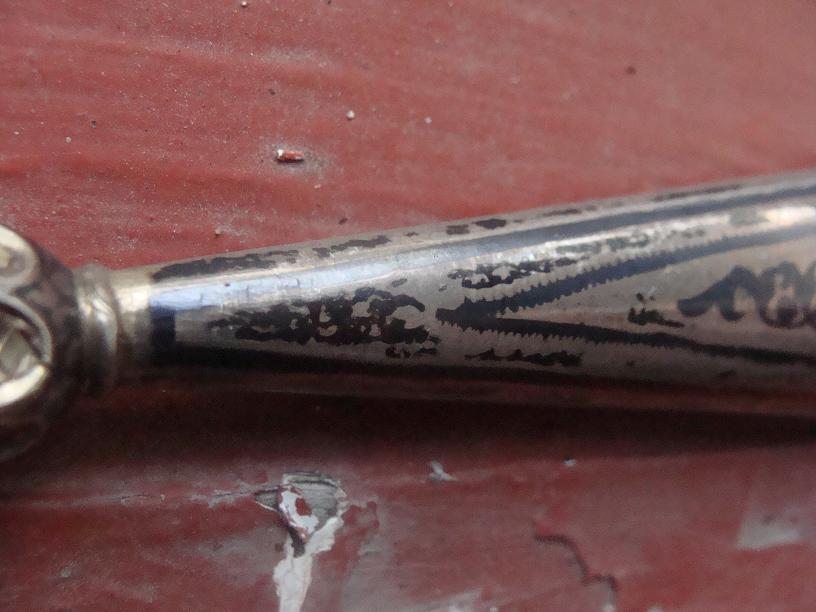

Photo 1, Shows the real age to the neillo on the backside of the scabbard which in reality does wear more than the front of any scabbard. One can clearly see the losses of the neillo, these losses are the base of 8 borders that surround the floral neillo on the reverse, only 4 remain perfect as does the floral arrangements, but this is all bar a little bit that remains of the other 4 borders.

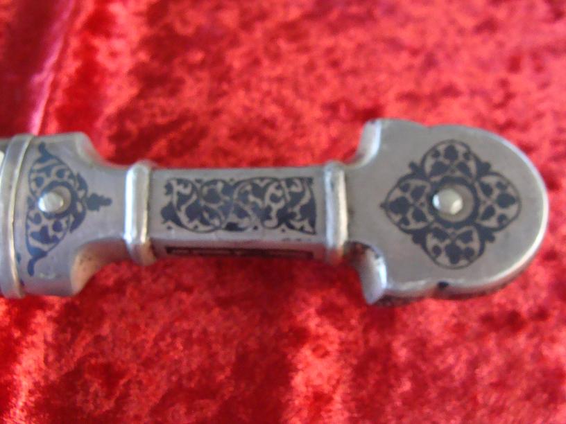

Photo 2, One hundred times larger than it really is, one can plainly see that there are no sharp edges and that all the pattern has been chiseled.

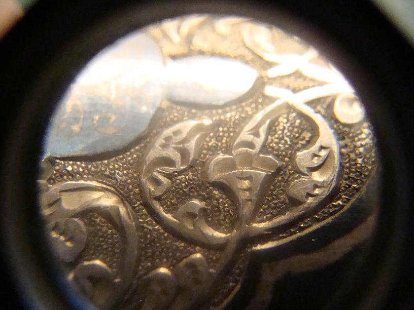

In photo 3, if you look close you can see at the tip there is a small amount of pitting and delamination, the rest of the blade shows to be rubbed over with what I could only think to be "sandpaper". Over all it shows a warmer older feel in natural light.
Photo 4, Comparrison, do you really think they were made in the same place or time? If so, do tell more...

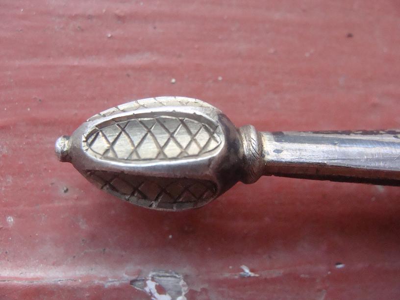

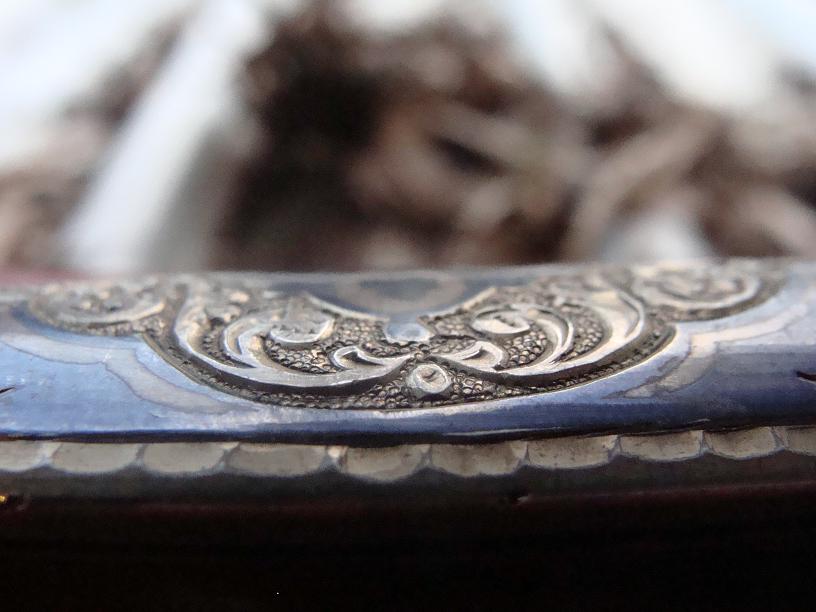

Photo 5,6 & 7, Showthe wonderful chiseled and cut releif that is found in the silver scabbard and hilt.

Down at the tip on the finale and just above that is an area that has crosshatching. The lines are crudely applied and seem uneven to me. I'm no expert in kindjals but I do have an excellent eye for detail and this caught my attention. The blade itself shows very little sign of age or use which also raises some flags to me. Gav I am not trying to put your kindjal down it is still a nicely made example for what it is. It takes years of research and handling older examples of any type of weapon to get a real feel for what is truly old and authentic and I have been burned a few times but you need to take it in stride and learn from the experience. As far as buying weapons from Butterfields or any other auction houses beware some of there appraisers have no clue what they are talking about I have seen them screw up big time.
