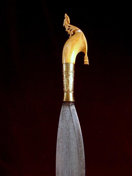

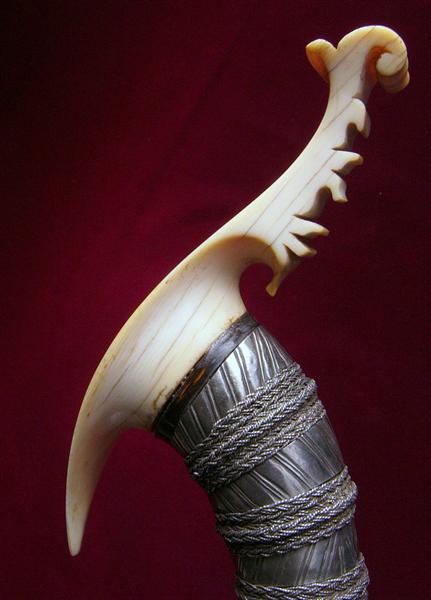

Recent acquisition and one of my favorite pieces. A seven wave blade 20 3/4 inches long showing twisted lamination on the center and bounded by twisted wire of gold & silver.
The asang-asang (metal band on the guard) is made of swasa,
The grip area of the handle has a traditional cord wrap lacquered black (recent replacement, but traditional style) and a swasa ferrule with dark patina.
Ivory Kakatua / jungayyan pommel has a honey color. Very unusual to find these rare delicate pommels undamaged.
Dark hardwood scabbard with silver panels on the top section showing some floral designs. Another unusual feature is these silver panels are on BOTH sides. Usually only on one side.
The lower part of the scabbard has 3 silver bands with similar designs as the upper panels.
Sulu late 1800.

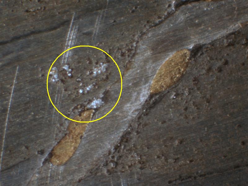

I am interested in inlaying techniques therefore would it be possible to post a close up of the blade where the wire ends and the inlay groove is empty. Many thanks.

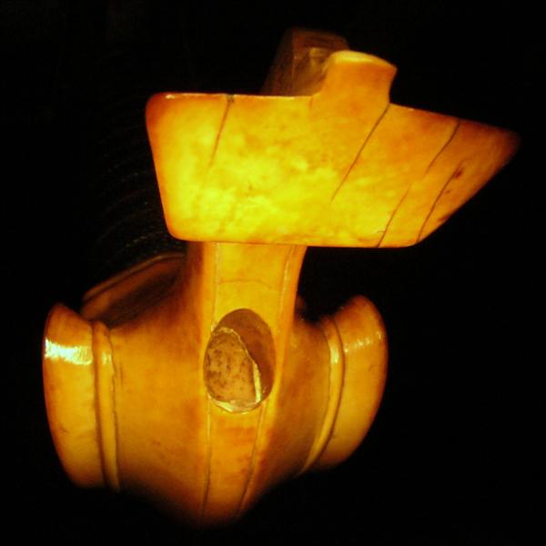

Thanks for the email Bill, I have done image comparisons and I must say that yours is an extraordinary example.
I am curious at to what the rest of the detail of the handle looks like?
Norman.
Norman,
I will be happy to do this. I have a microscope and will take some real closeups. I tried with the camera, but was not happy with the results. Will get some images this week.

Hi Norman,
Not being certain of what you want to see, I have posted a few macro and micro images.
First the macro
Moving in closer
Still Closer
Into Micro, please excuse the color shift, I may need a different filter on my light source. Here is a 10x of the place where the two lines join at a point.
Micro of the gold and silver wire.
Micro where the wire has come loose showing the channel. If you want more showing the channel, I can oblige.
Micro of the wire.
Old 11th March 2008, 08:53 PM   #15
Norman McCormick
Norman McCormick's Avatar
Posts: 1,657
Hi Bill,
Many thanks for the photos, I've been experimenting with inlaying copper into steel and what I wanted to see was how the grooves were prepared for inlaying. On European weapons it would appear the groove is undercut using a special tool forming an inverted T so that when the inlay is forced into the space it expands into the T thereby forming an anchor for the metal inlay. From what I can see this is not the case in this blade and internal 'roughness' of the groove is sufficient to grip the inlay if it is laid in with enough force. This is how I have done it and it seems to work very well. Is there any evidence of an adhesive in the groove? I was thinking of possibly a similar substance to that used in India for Tulwar hilts. I also wanted to see how smooth the edges of the grooves were as this is a difficult thing to achieve with hand tools although only really apparent upon close inspection and not terribly noticeable at normal viewing distances. Thanks again for the pictures and would you mind if I copied them into my photo file for future reference?
Norman.

Bill: That has to be one of the prettist pieces of ivory i've seen. Basically the same style that one usually sees of this type, but it's the color that makes this one especially good. I've been told that color is just due to normal ageing of the ivory, but we have many old ones that are basically white with just a little bit of color. So who knows. Maybe someone on the forum knows the reason why some hilts turn this color and why some don't
Albert: I guess over the years Lonna and I have been lucky that none of our pieces have ever been dropped. It could be that people are forewarned that in no uncertain terms that they can handle most anything they want, but "you breakee, you fixee", and it will cost you a lot money. The only pieces that have ever been broken have been from my own clumsyness......ooops!!!!!!!!. Can't wait to see your new pieces at the Oregon Knife Show this year.............Dave.
Old 17th March 2008, 10:39 PM   #19
Posts: 7,416
Well actually I understand that it depends upon the amount of sulfur present in the environment. The more sulfur is present and the warmer it is, the more it will react with the ivory and turn it darker and more orange. In silver it will turn it dark.
Hope this helps.
Old 19th March 2008, 07:09 PM   #20
VERY INTERESTING CLOSE UPS OF THE INLAY TECKNIQUE IT KIND OF REMINDS ME OF THE TWISTED WIRE INLAY ON THE MOROCCAN WEDDING NIMCHA BLADES. I HAD NOT SEEN THAT TECKNIQUE USED ON MORO WEAPONS BEFORE
ANOTHER FACTOR CAUSING IVORY TO TURN COLORS IS CONTACT WITH HUMAN SKIN, THE OILS. ACIDS AND WHATEVER ELSE FOUND IN THE ENVIRONMENT CAN OVER TIME CAUSE A VERY ORANGE COLOR. AFRICAN IVORY BRACELETS ARE A GOOD EXAMPLE ,SOME MORO WEAPONS WITH A MORE SIMPLE IVORY HANDLE ALSO HAVE A GOOD RICH PATINA. I SUSPECT THE REASON FOR LESS PATINA ON THE VERY FANCY DELICATE IVORY POMMELS IS THAT THEY WERE NOT WORN EVERYDAY AND WERE HANDLED VERY CAREFULLY BY THE GRIPS ONLY TO HAVE SURVIVED INTACT ALL THESE YEARS. VERY BEAUTIFUL EXAMPLES ALL , TIME TO MOP THE DROOL OF MY KEYBOARD
