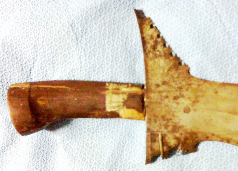

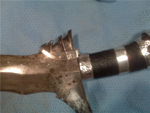

Since some have asked me in the past to share process, I thought I would here. The first pictures are of a kris as it came to me. It needed hilt restoration, a baka-baka clamp, and a large part of the scabbard was missing along with the wranga (top part).

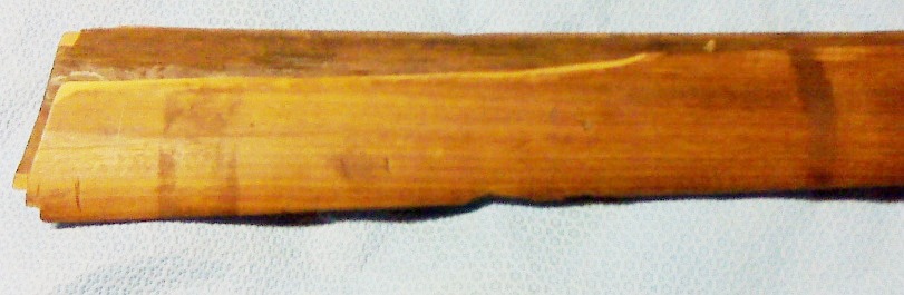

I based the silver restorations on imprints I found on the hilt as well as the baka-baka.

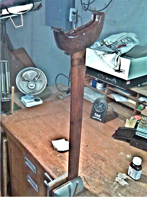

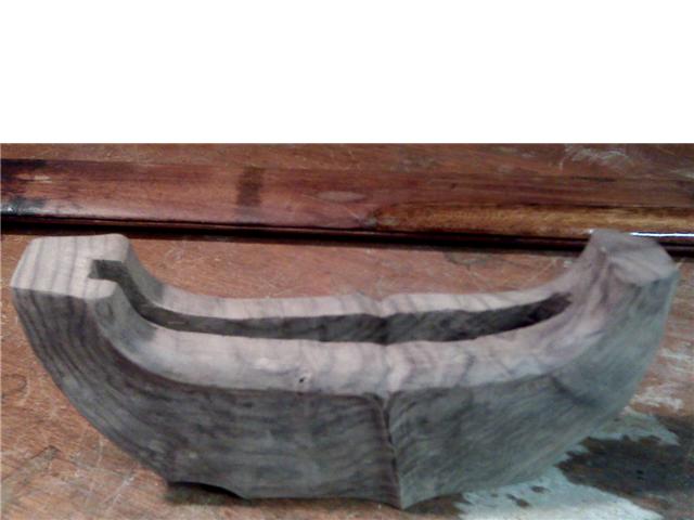

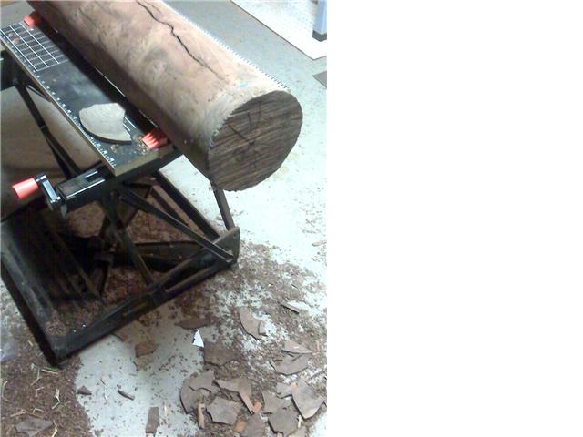

The bigger process was the wranga. I had to cut a chunk of burled walnut from a log and carve it out. Then I stained it to better match the hue of the scabbard patina.

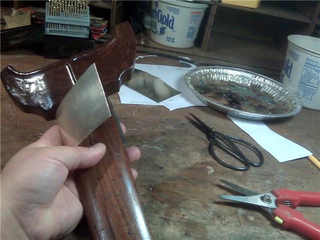

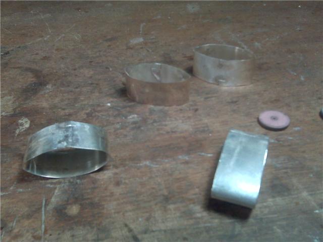

Finally, I took plain sheet silver and wrapped the scabbard, making silver bands and placing them on the scabbard.

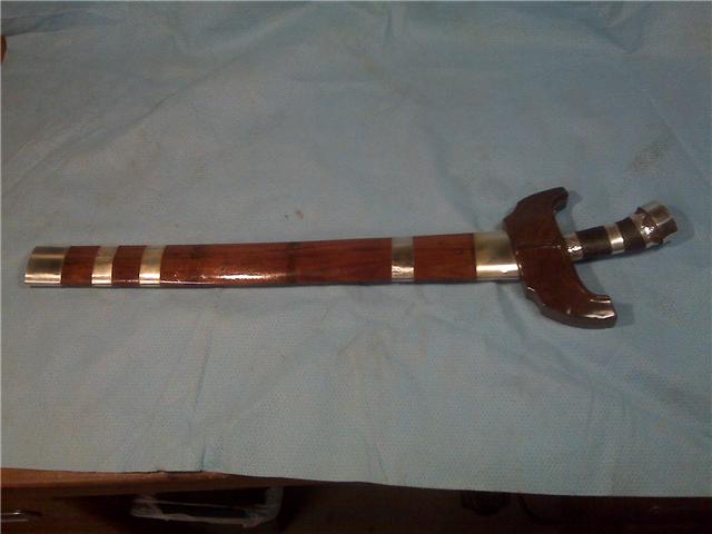

This is the end result:

Jose, that looks great. What kind of joint do you use on the silver rings? Is it a simple butt joint, or what? I had to make a brass ferrule for a kris today and made kind of a miter joint. I filed the edges of the brass at an angle so there would be more surface area and strength to the joint. Love to know how the pro does it.

Here is the best picture I have of the baka-baka and hilt.
Steve, I am embarrassed to say that I am not familiar with your terms.

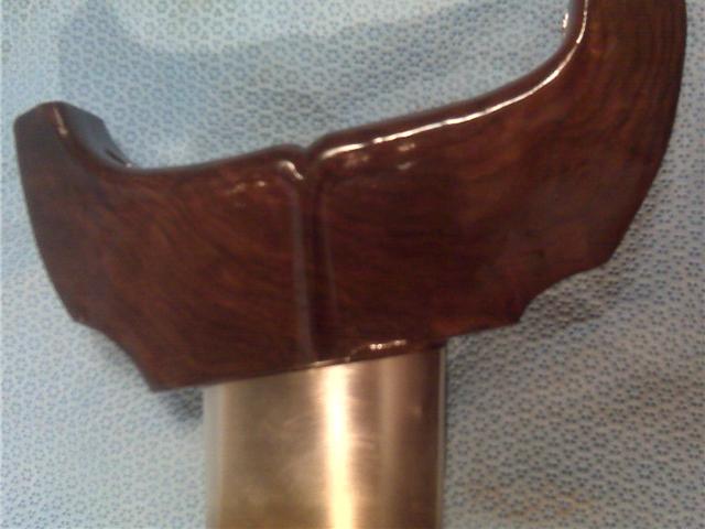

Here is a close up of the finished wranga:
