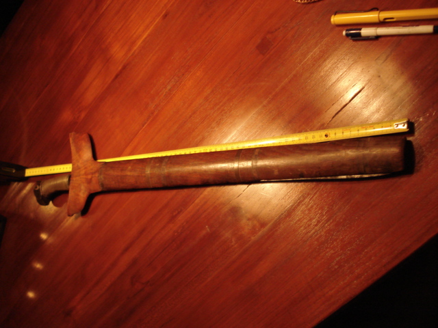

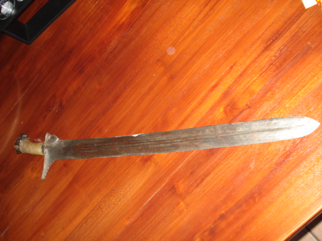

Hi like to now how old this one is.
Ben
Old 16th February 2008, 10:23 AM   #2
Posts: 6,026
Question Strange looking?
One could be mistaken thinking that this is a Kaskara blade forge welded into a Kris hilt.

Hi Time I never see an blade like that on an moro kris like that
It was taken from North Borneo in 1910

Hi Ben! I'm with Tim, seems a kaskara-tokuba blade with the two half-moons on the blade. Also the fullers seem tipical of these kind of blades!

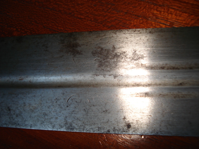

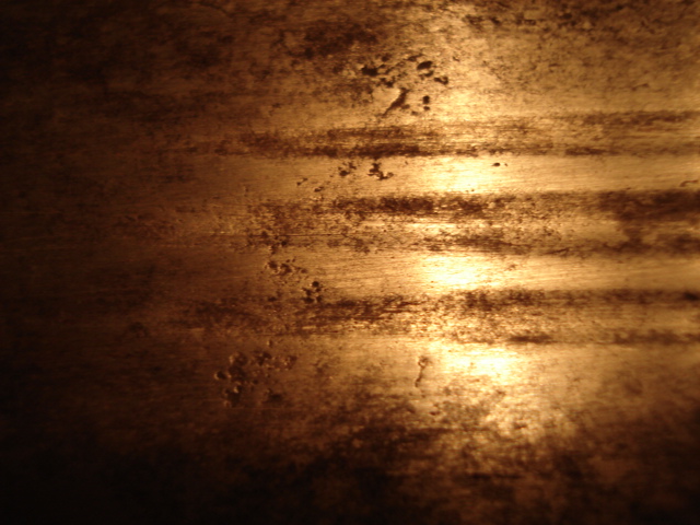

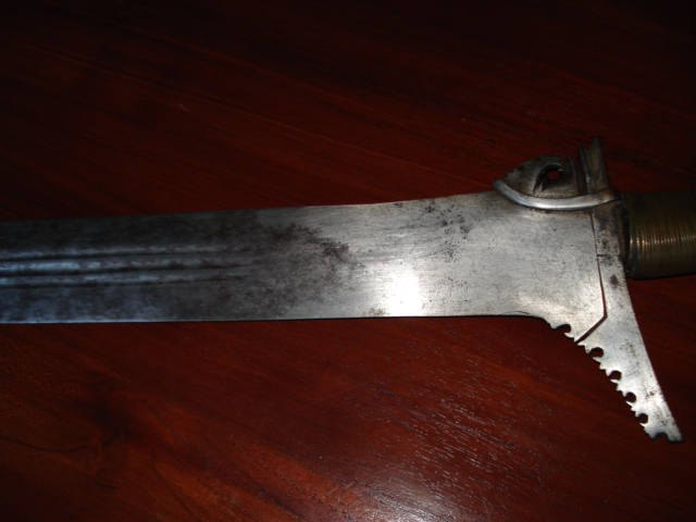

Scarf welded blade possibly ?
Can you show a closer picture of the area where the fullers begin ?

...and where exactly would the weld point be where this "kaskara" blade would be joined to the obviously Moro base of this sword.
I do agree that the fullers do give it the look of a kaskara blade, but i am fairly sure that this kris is all Moro. I have seen other Moro kris with fullers before (see pg. 71 in Cato), though this is certainly a more unusual configuration.

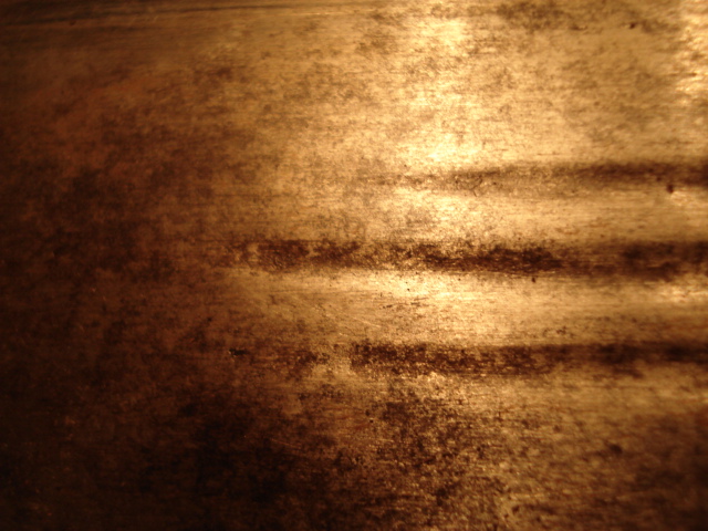

Hi David, there is discoloration above where the fullers start ; could be indicative of a scarf weld .
Old 16th February 2008, 05:00 PM   #8
Posts: 6,026
Fascinating. In certain views there does appear to be two metals here. Even if this is so it I do not think it is done to deceive, or cobbled together to fool. Perhaps the trade of these blades is extensive. They are very good quality. A short length mounted expertly in this Moro? manner would be a very good heavy sword indeed. ?

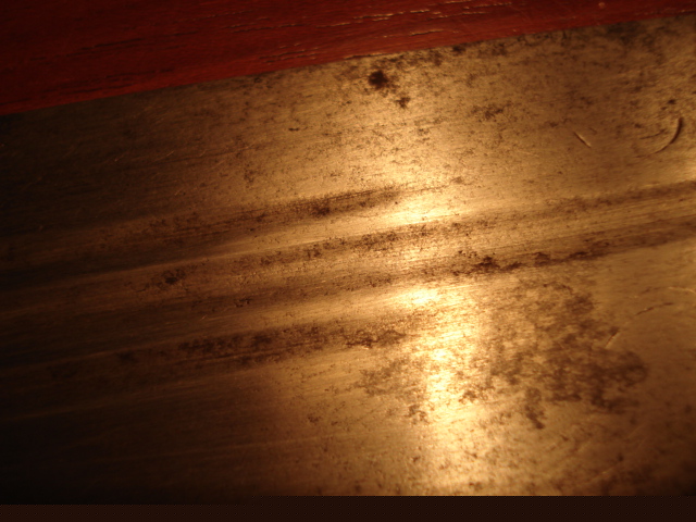

Maybe an etch could help... if the blade is laminated it's for sure all Moro

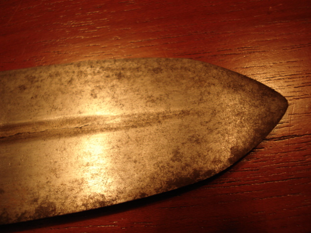

The blade is 24 inch and laminated all over 29 inch

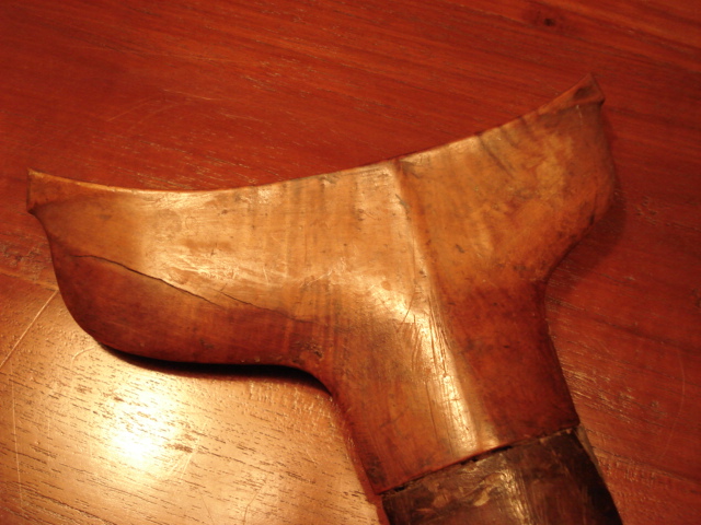

Here are some close up pics
I like to now the age because it looks older than 100 years
and what are the sign s means that is on it .
but I don t now much about Moro kris so I like to learn .

These blades were supplied to East Africa in The latter half of the 19th century so I see no reason why this is not from that time. When you think about it there were trade routes to the east. Also many parts of SE Asia the area we are talking about, may have depended on trade blades. We have seen European trade parang blades in Africa recently. Some communities may not be particularly wealthy so making a sword this way makes sense. Perhaps using an old hilt saves expense, perhaps only having to commission the local smith only to make the hilt means a cheap quallity sword. The handle does reflect a cheap functional nature.
Old 16th February 2008, 06:56 PM   #12
Dajak
Dajak's Avatar
Posts: 952

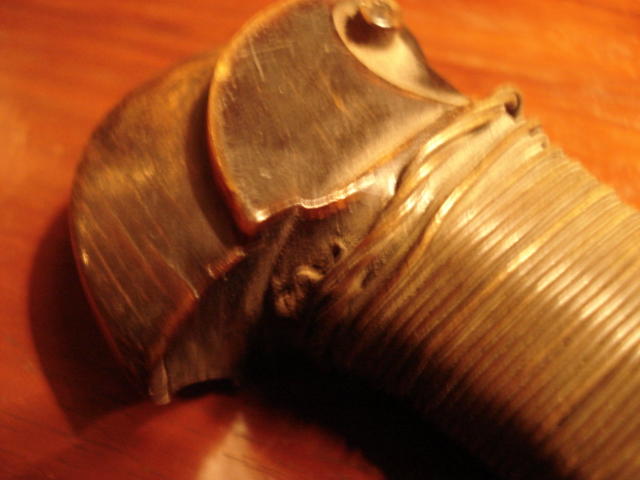

It looks they used Rhino horn
Ben
Old 16th February 2008, 07:04 PM   #13
Posts: 6,026
Some jungle people might have more access to Rhino horn at times, but may not always have a good supply of trade commodities, the handle fitted latter at home after the blade was made? How many smith would be in the Forrest interior? First catch your Rhino, I have heard that the SE Asian Rhino is rather elusive.

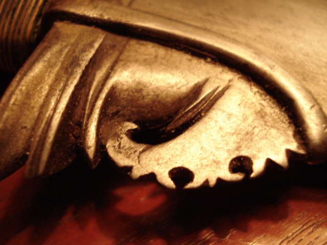

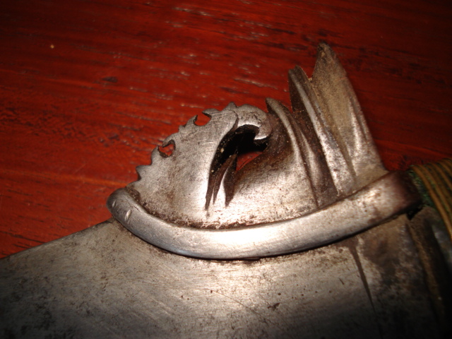

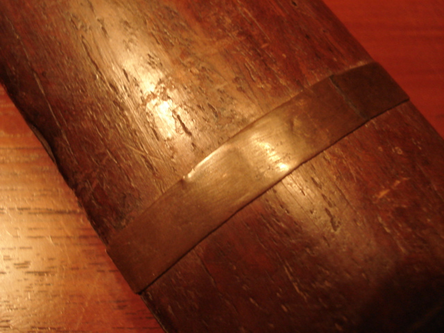

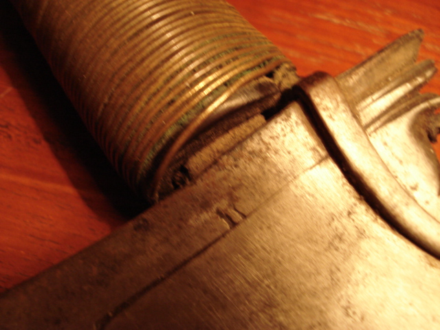

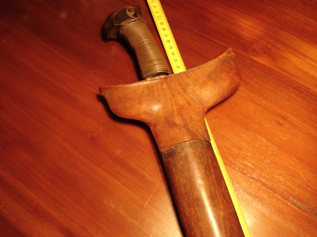

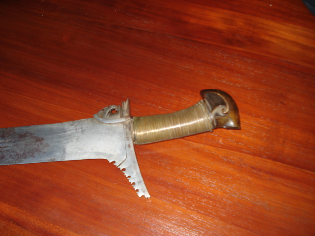

Hello Ben,
Nice to see more pics of this kris!

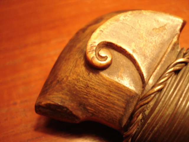

From the features at the base of the blade, I'd suggest that the blade is 19th century, possibly the latter half but probably predating the Spanish-American war. It seems to be clearly Sulu style (including northern Borneo) although it's longer than most blades from that region/date. Also the scabbard looks well-used and genuinely antique.
The pommel could be also very well be of Sulu manufacture but the wire wrap doesn't look like Moro work. However, it seems to fit well with non-Moro tribes from Borneo - is it known from which tribe or region this piece was collected?
I think it would be very enlightening to polish and etch this blade. Considering the good condition of the blade, this can be done with minimal loss of material (contact me if you don't want to do it yourself). If a Kaskara blade was welded to the base/gangya, this will surely show!
Old 16th February 2008, 09:30 PM   #16
Posts: 7,416
I agree with Kai. I also think that the wrap was done later than the blade. I wonder if this was a European blade with the shape and those moons (even though the crescent moon is an Islamic symbol). I have seen one or two Moro kris with European trade blades before.
Rhino horn - not common on Moro stuff but I suppose anything is possible.
