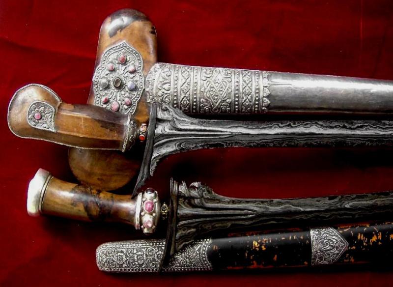

gentleman, i only can support the discuss with pic.
because know nothing on this point
thanks Rick to bring out this subject
here a pic of kerises bali with pamor on the gonjo.
brekele

Thanks for posting the photo Brekele. When would you say these keris were made. The dress looks fairly recent to me, but i can't get a good grasp of the blades without better and closer images.

Hi Dave, those both keris are old but one of warangka with silver decoration and gems is new made (top) and old made warangka (down).

As Brekele has shown, and as Rick in his original post indicated, the plain black Bali gonjo is not a universal phenomenon. It is common, yes, but it is not universal. Amongst my own keris I have a number of old keris with pamor gonjo, I also have a number of old keris with plain black gonjo. I have two keris of extremely high quality with gonjos lacking pamor, but adorned with kniatah work.
