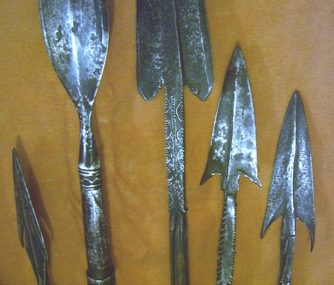

Hi Tim
I've just added 6 spears to my collection.....one may be of interest to this thread. If you look at the decoration on one of them...it appears very similar to the design on the ferrule on your 'Ram dao' .....alas I do not know the origins

Posts: 6,032
Nice set of spear David, they look like Sudan/Congo Zande and Mangbetu they could be from else where ofcourse. The marks have some similarity. I am thinking that the axe? may relate more to this type of thing. The proportions are very similar to the axe? is 2.5cm longer.
