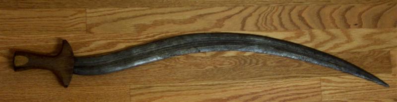

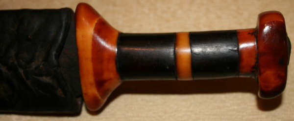

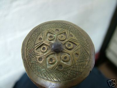

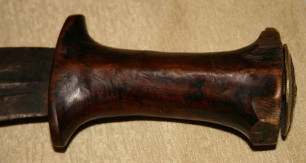

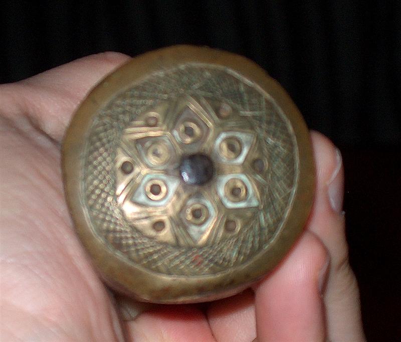

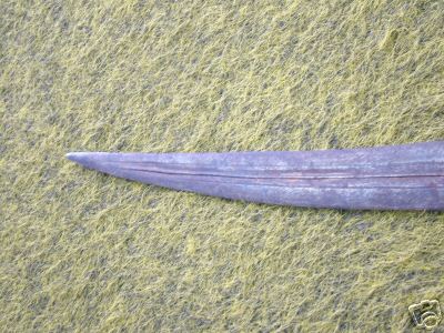

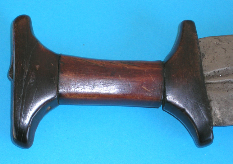

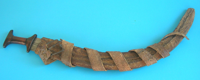

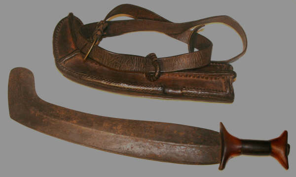

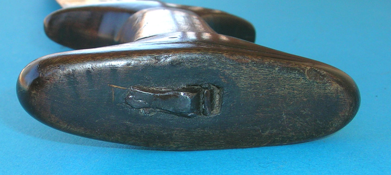

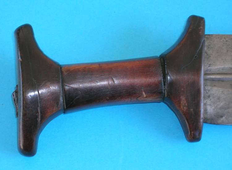

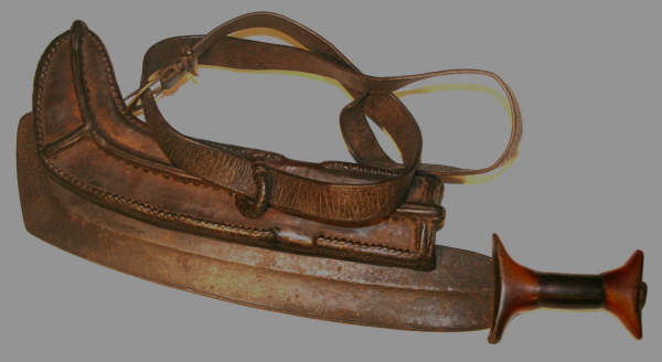

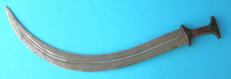

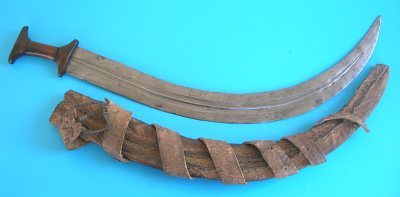

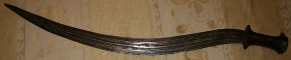

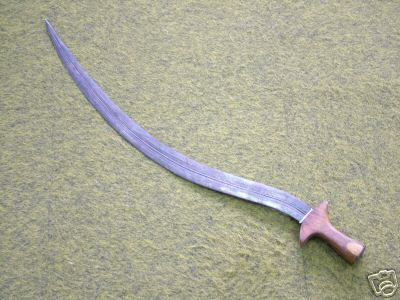

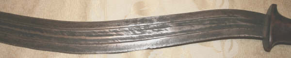

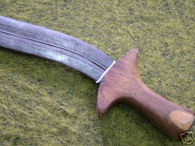

I just received this shotel. The blade is about 30" long and 1/8" thick; the hilt is unfortunately a replacement and not very nice. Oddly the one who made it kept the buttcap.
The seller said it was a 20th century piece, but he had no idea what this was. Any comment on that? How late were these swords produced?
The first four pics are from the seller, the last two are mine.
Thanks for any input,
Emanuel

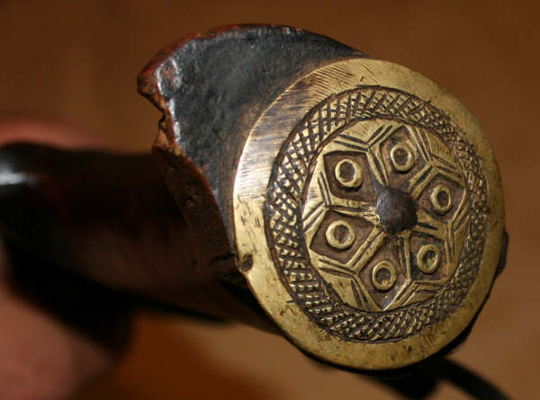

I would be inclined to agree on 20th century on this blade, and although the hilt is pretty amateur it is better than no hilt at all. The blade is very unusual for a shotel blade as most of this form are much more parabolic and the fullering is typically different it seems (hopefully Roanoa or Tim will say more on this).
During the latter 19th century and into the 1930's I believe, there were blades made in England primarily by Wilkinson Sword Co. of a number of forms, some including the traditional deeply curved form. It seems that by this time there was a marked preference for the standard slightly curved sabre blades mounted on the same type hilt as well as the gurade which typically refers to the military stirrup hilt sabres.
The pommel cap is most interesting as well, especially with the star of Solomon motif. It is known that in Abyssinia (now Ethiopia) the Falashas were tribal armourers that were actually of the Jewish faith, and furbished weapons for the Amharic rulers. Obviously the six point star is found used symbolically in numerous applications, in Judaism as the Star of David and in other cases as the Star of Solomon, which is of course well placed with the early history of Abyssinia.
All best regards,

I am not sure we can connect the 6-point star to the religious affiliation of Falashas.
The Kings of Ethiopia were convinced that their royal line went all the way back to King Solomon and the Queen of Sheba: they called themselves the House of Judah. The King was, of course, the Lion of Judah and this is the reason for their national symbol ( stamped on many a Wilkinson sword )

I should have worded that better the note on the Falashas was meant to note that is was interesting that they were of Jewish faith and that the six point star would have had considerable potential in Abyssinian historic context. It was also worthy of note that they did serve as armourers to the Amharic rulers.
The note on the Wilkinson sword connection is well placed and the firm use of the Star of Solomon at the forte of thier blades was key to the marking of thier blades, typically enclosing brass plug with proof marks. Since Wilkinson was essentially a prime supplier of blades in the early 20th c. to Abyssinia, the possible influence of that key marking on the pommel cap on this example seems compelling.
I believe that in Abyssinian history Menelik was the son of King Solomon and the Queen of Sheba, and the Lion of Judah representing the King was indeed typically marked on Abyssinian blades by Wilkinson and other suppliers to Ethiopia including Solingen.

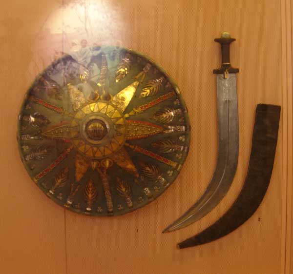

Thanks for the response . I did not know trade blades were used on shotels, but I was aware of Wilkinson and others producing gurade blades.
Here are some shotel examples from Oriental-Arms and they look a lot like mine with the exception of the hilts.
http://www.oriental-arms.com/search....el&s.x=0&s.y=0
I'm not aware of blades being done differently although I know some have extremely high curvature.

nice blade, I love the shape of these .... it is a shame about the hilt...but I think with careful re-sculpturing with a 'dremmel' type tool, ( like a small electric drill with various small cutting/shaping 'bits') you could make it quite respectable without removing it from the blade.
Regards David

It seems clear that the blade form seen on Emanuel's example is of what appears to be a native made blade with cross section of earlier highly curved shotel's. I had not been aware of this much less curved form until seeing these, and think it would be interesting to look at examples of the early highly curved ones to compare with.
Could anyone share some of the other Ethiopian swords here; the shotels of high curve, the examples with trade sabre blades and the familiar gurade?

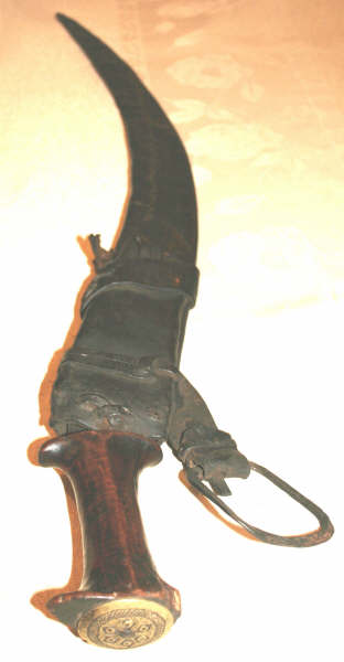

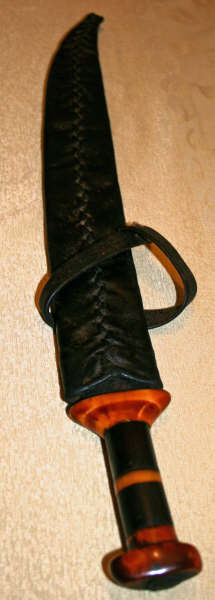

I have a similar shaped sword with a similar style brass cap on the pommel. Blade length measure 67 cm, double edged, and wooden hilt. I bought (3) from a fairly reputable dealler in Addis who swore they were coming from Afar and that the Afar were no longer using them. I have never seen any photo's of Afari's wearing such swords (always Gille's) however suppose its possible especially along areas where Afar borders Amhara and Tigray.

Thank you the response and excellent information. With your reference to the Afar, it prompted me to recheck Burton ("book of the Sword", p.164-65) where he refers to the 'Dankali' (Danakil, which is also the term for the Afar region of Ethiopia). On the same page in fig.177 he shows a 'smaller Abyssinian blade' shotel with similar shallow recurve and median ridge blade profile as seen on the discussed example.
Interestingly on p.165, Burton shows an illustration on what is clearly a kaskara and is captioned 'Dankali sword'.
The kaskara of course is from the Sudan, however is well known among Eritrean weapons, and Ethiopian in degree, which would include Danakil or Afar regions.
The diffusion of weapons in these regions is well established, and clearly while certain forms are more distinctly seen with certain tribes and regions, a degree of use of the weapons of congruent regions is to be expected. It seems quite reasonable that the Afar would have used shotels with these blades, and in limited degree so that illustrations or direct association would be unlikely. I think your suggestion of possible use of these by Afar tribes near the Ethiopan regions you note is well placed and quite likely.
It seems that shotels with this shallow recurved blade were in existence at the time of Burton's research, well before 1884 so probably as early as mid 19th century, so the period of such blade form is established. With the Afar provenance, those tribes as well as those of northern Ethiopian regions may be considered in those who might have used them, and it would seem the form continued in use well into the 20th century.
