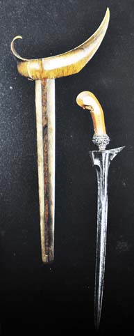

Here I have attached a shared photograph for discussion. The dapur is Jalak Sangu Tumpeng, probably the keris was made in Majapahit period (Mpu Sendang Sedayu made?). I am looking forward your opinion.

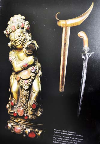

This Jalak Sangutumpeng in the picture, reminds me to the best jalak sangutumpeng picture I've seen in Musee de l'homme's book (Paris) some couple years ago. Picture below, the Musee de l'homme's jalak sangu tumpeng. I took reproduction from the museum's book some years ago...
Not so many jalak sangu tumpeng -- which has good 'garap' I've seen. Mostly, comes from supposed to be Mataram Senopaten (without pamor, but some with only very minimal pamor or "wulan-wulan" type pamor), and some of them supposed to be Majapahit tangguh, with very smooth, greyish-black blade...

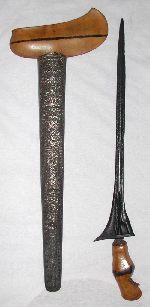

Here is the example for comparison, Karttikeya...

Karttikeya, based upon what I can see in the image you have posted, I feel that many people would be prepared to classify this keris as Tangguh Majapahit.
It possesses many of the features of form that align with a Majapahit classification, but the ganja is too straight and thin to conform to that which is expected in a Majapahit keris. The other indicators that I can see do echo Majapahit, but as is usually the case with questions of tangguh, I am reluctant to commit myself to an opinion based upon an image on a computer screen. When I say that the features "echo Majapahit", to my eye, these features appear to have been executed by a maker who had knowledge of the form of the indicators in a Majapahit keris, but who perhaps had never seen one.

With respect to Karttikeya's Jalak Sangu Tumpeng, I would opine it is a Mataram piece, most probably of Senopaten era, but with very significant Padjajaran outlook especially at the gandik...very slanting feature there (mboto rubuh)

What i see is a nice old keris with a certain presence in not quite as old nice dress. It is a keris i would welcome in my own collection. Does the sheath appear to have been made specifically for this keris?

Mr. Alan, thank you for your such explanantions..by the way, based on its design this keris comes from later period of Majapahit or probably older than Majapahit? If you do not mind, kindly give an opinion about this keris..thank you
