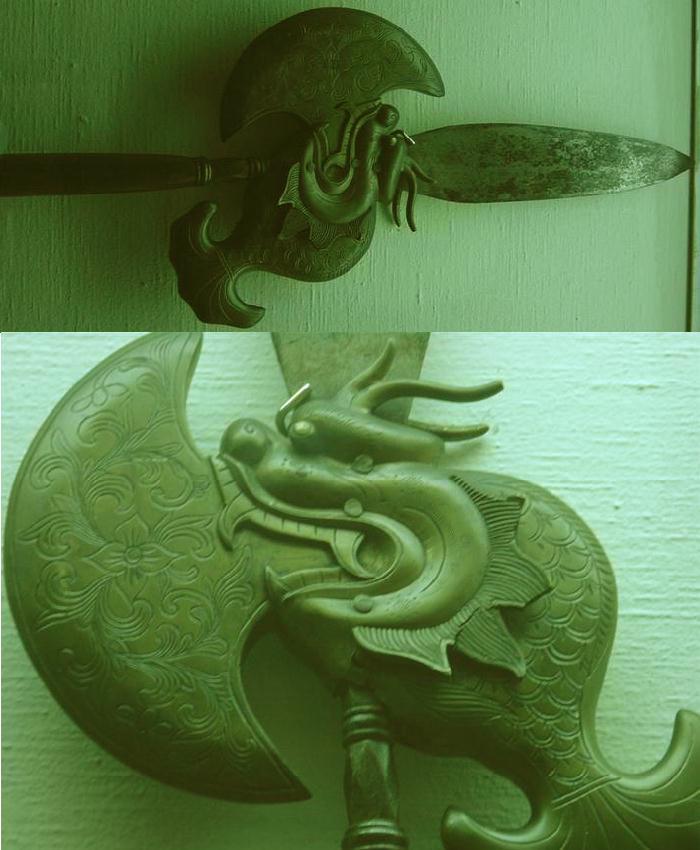

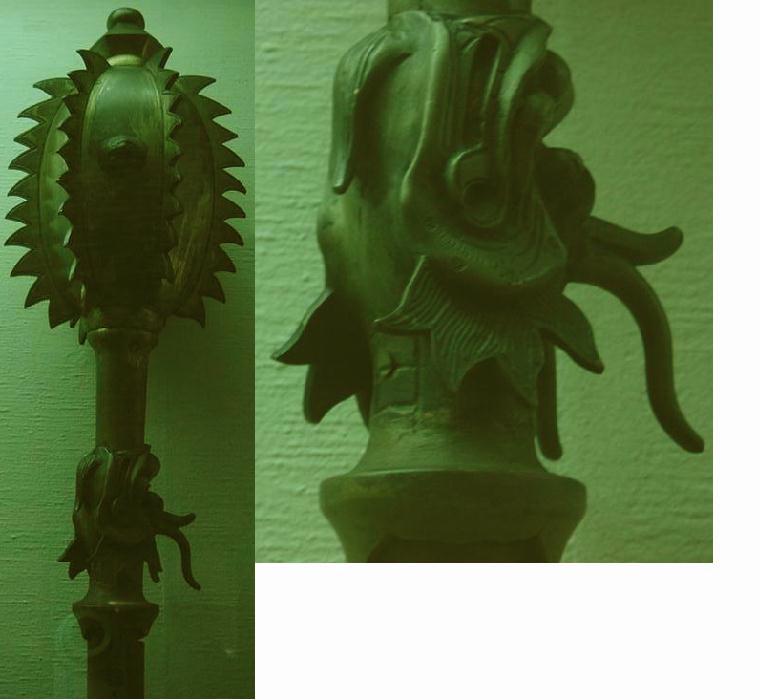

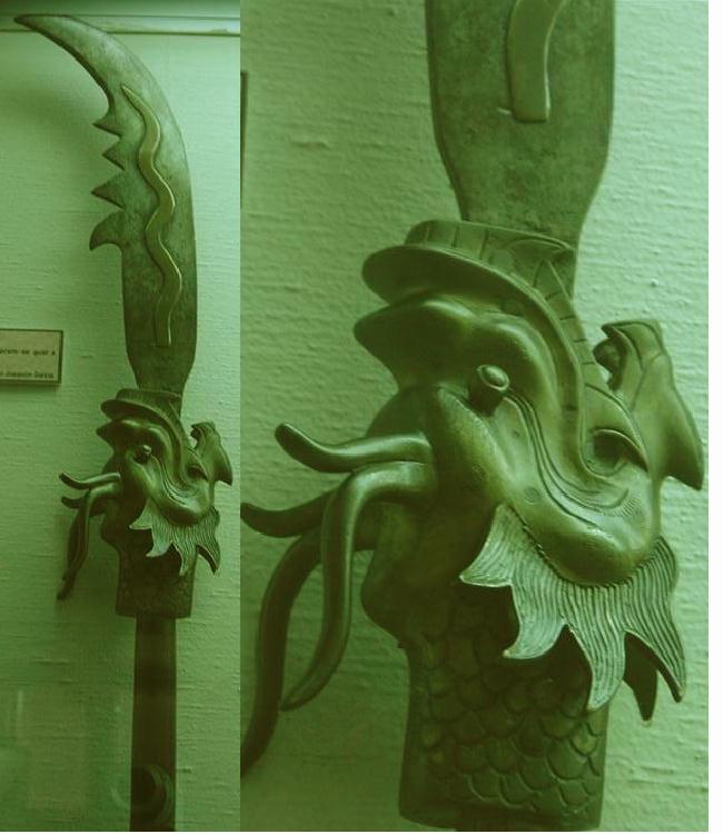

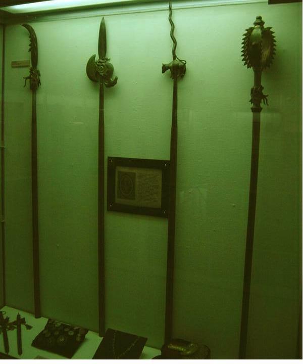

These are permanently exhibited at the Military Museum in Oporto, labelled as halberds, "possibly" Oriental, with actual origin and date unknown.
They belonged to the collection of General Antonio Joaquim Garcia, whose career was totally spent in Timor and Macau, as a Comander and as a Governor.
In my ignorant view, these pieces were acquired or presented in one of these places, more likely in Macau, but i wonder why the guys at the museum are not able to reach this or a different assumption, being these so much characterized specimens.
Any ideas ?
Fernando

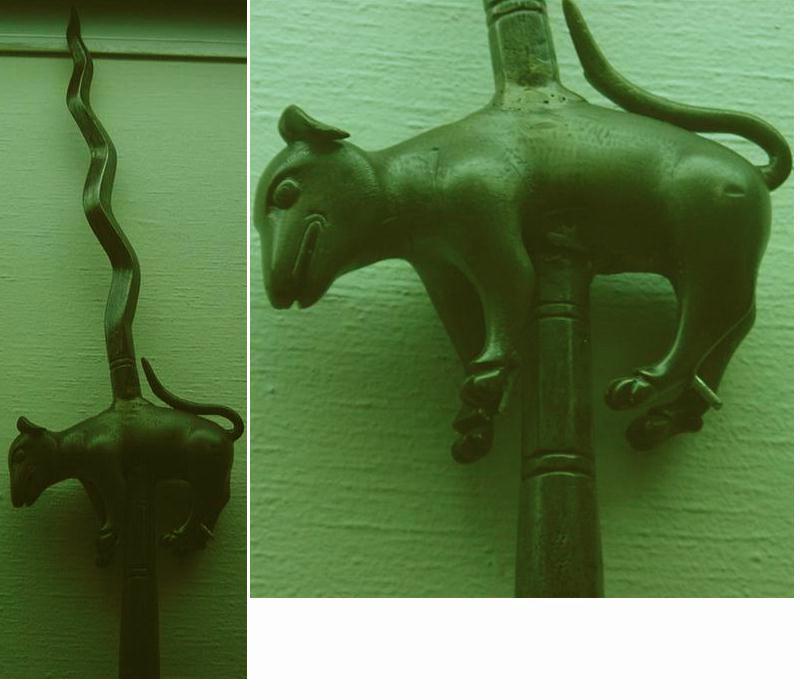

The impaled cow looks hilarious
I agree with Spiral: even without deep knowledge of Chinese weaponry, one can see that the items are so schizophrenically inhomogeneous and nevertheless so consistent in their technique, that they must have come from the same hooligan shop.

These belong to a set of pole arms commonly seen in Chinese and Vietnamese temples. Usually, there is a rack of eight on each side of the altar in the main sanctuary. They are supposed to be for the use of the guardian spirits of the shrine (in Buddhist temples, guardian statues are often seen in pairs at the entryway, usually standing in martial arts poses with clenched fists, or holding maces).
The heads of the pole arms are patterned after various types of spears, glaives, battle-axes, and even maces. In Vietnam, one often sees long two-handed sabers (guom truong) in these panoplies.
The "weapons" are of various materials, most often of brass, sometimes of gilt and lacquered wood. They vary in quality according to the wealth of the temple's congregation. I've seen matched sets in fine gilt brass with the temple's name engraved on each. (some have ended up minus their poles, mounted on display pedestals at oriental art fairs, with some pretty fancy price-tags attached). Others can be quite cheaply made, and nothing to crow about. Needless to say, they are strictly "for show" and had no military purpose whatsoever.
Similar polearms, but with generally larger heads, were also part of the funeral procession regalia.
I like the "impaled cow", too. Bovines don't figure as much in Chinese popular religion as in India, but the choice of animal may be dictated by the particular temple that it was displayed in. For instance, there is a "Bach Ma Mieu" (White Horse Temple) in Hanoi, enshrining a deified equine, and there are horsey themes in the decoration of not only the building but several of its interior furnishings.

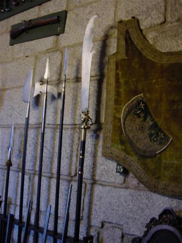

I have spotted a more real version of these things, exhibited at the Palace of the Dukes of Bragança, belonging to a collection gathered by the Viscount of Pindela.
The picture is horrible ... they don't allow us to take pictures and there is a rope to keep the visitors at distance.
According to the book, these are considered halberds ( there are two of them ), made in iron, steel and bronze. The large blade is 83 cms. long. The bronze socket represents the front of a strange marine species, frequently reproduced in Chinese works such as sculpture, porcelains, laquers, embroideries, fabrics, bronzes, coppers, even in stamping works , showing in this specimen a magnificent work of modeling and chisel.
While probably the General was not an ethnographic gatherer and the replicas were possibly offered to him in a ritual or friendly gesture, relative to his functions, the Viscount was a fine collector and must have paid some reasonable amount to aquire the real period stuff.
These halberds are dated XVI century.
Fernando
