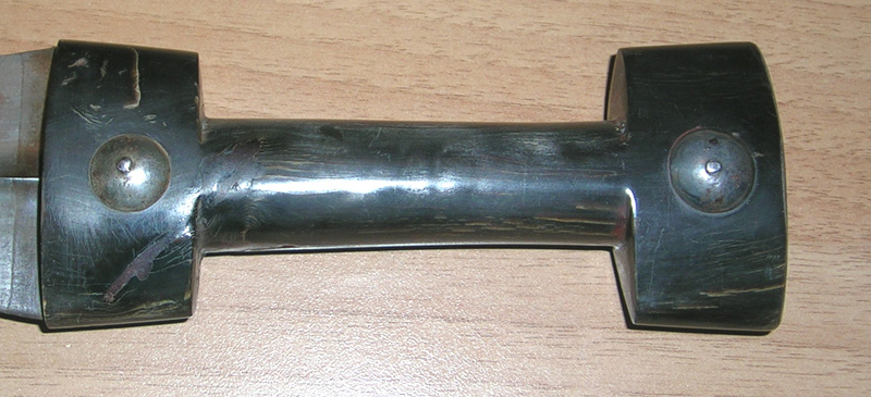

Hi all,
I have a typical Curdish dagger, whose H black horn hilt needs to be polished. How may I restore it ?
Thanks in advance for any help
Paolo

better would be to see a photo but you can use abrasive paste (past to clean car's body is good: used it over a piece of paper). But pay attention to patina: if your handle has a patina don't use it!)

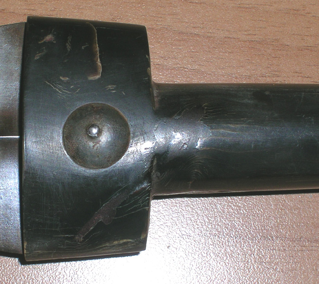

Paolo, I'm not sure it really needs polishing. The places that seem dull are filled in with resin or something like it. The slight cracks are stable and I think add character.

If this was mine I would apply a little Renaissance Wax and leave it as is. JMHO.

Thank You for Your advices. I like to have my edge weapons at their best, so I dislike the little stratches and the matt stain on the hilt's surface. I think that, as Robert Coleman write, I'll apply wax. I don't know 'Renaissance', might be a good bee wax will be so effective ?

Almost any wax would be fine, and then polish the wax. Renaissance wax is best IMHO because it solidifies quickly into microcrystals and no need to heat it. You can apply it from can to piece with a cloth or fingers immediately.

I applied Renaissance wax on the horn hilt. Really satisfied about the effect!

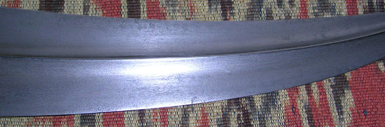

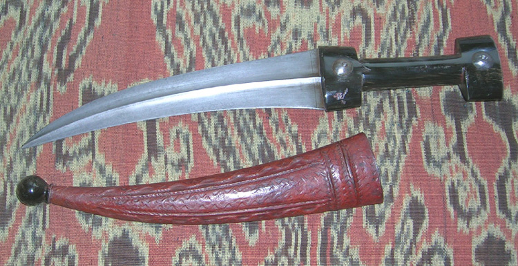

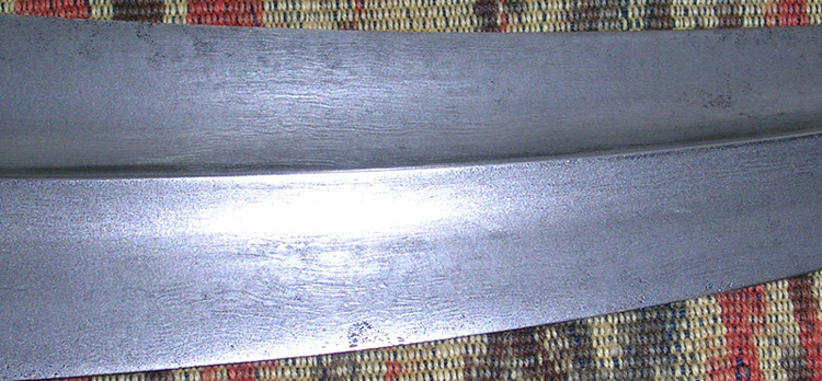

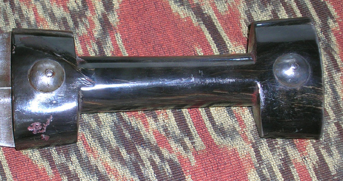

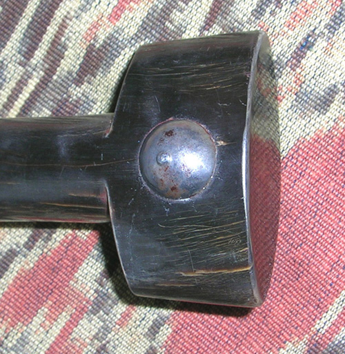

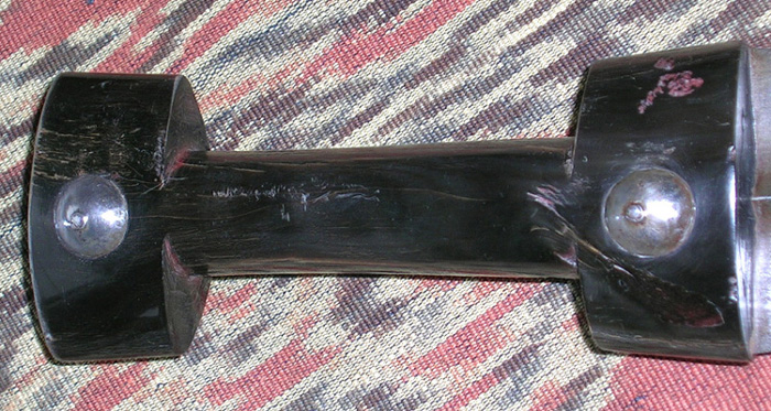

Here are the pics, the best I can do with a rainy day. Also attached two close up of the wootz (?) blade, not too contrasting, but is the first one I etched by myself.

VERY NICE! Makes a world of difference. Keep working on the etch - somethings coming out!

for etch the blade, I used ferric chloride diluted in three parts of distilled water to one FeCl. I used 1000 waterproof abrasive paper and also heated the blade before apply with a brush the liquid. I repeated more times the treatment, but what You see in the pics is the better I got. Where I was wrong ?

Looks like you have done well so far, Paolo. You could also try Coca-cola (yes the drink) because it has phosperous in it which works on blades of Persian origin. It is possible however that this the blade is of Turkish origin, and if so, that would mean that the wootz would be subtle anyway and not "pop" out like on Perisian pieces. If the Coke thing does not work, then leave it alone since you can do nothing more and it is Turkish wootz.

before use ferric chloride, reading a previous thread, I used Coca Cola as Artzi wrote, but I had no significant outcome. Then I used citric acid with no result. The better I had with ferric chloride. Might You explain to me why Turkish wootz doesn't react to ferric chloride ?
