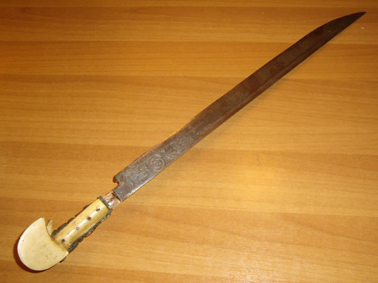

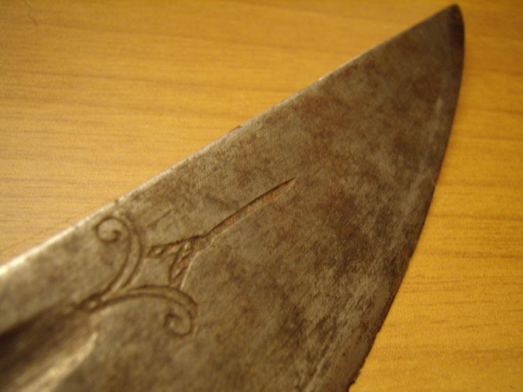

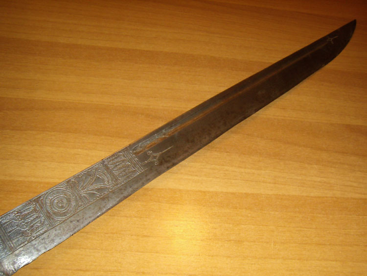

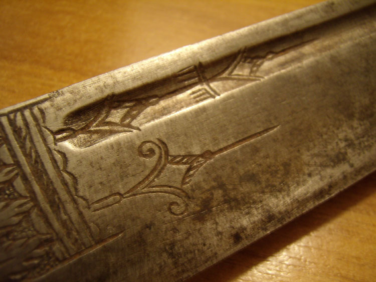

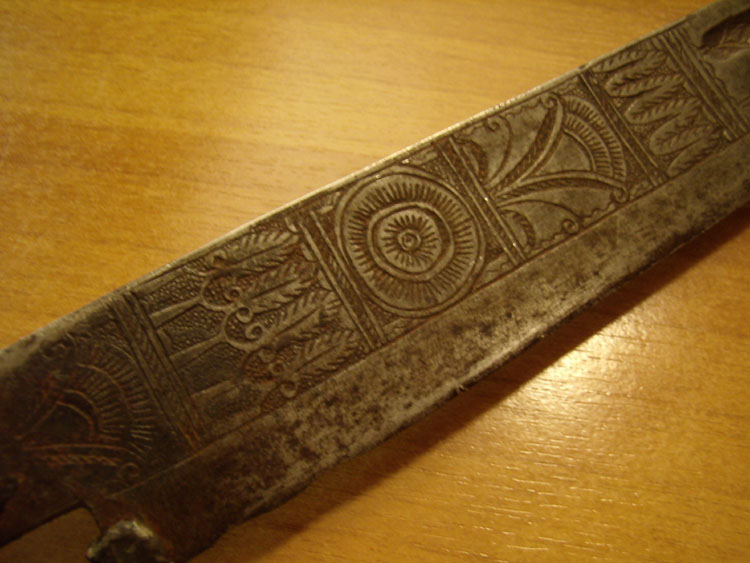

Hallo, on this yataghan there is no translation issue, just these symbols engraved on the blade, that i havent sn before. They are engraved on both sides, identically. Does somebody knows the area it comes from or has seen similar designs?

The fuller is also interesting and unusual - could this have been a blade adopted from an older European hanger or something?

TVV makes a very good observation, this is obviously not a yataghan blade, and I cannot recall instantly where I have seen it, the curved wraparound at the back of the blade is familiar. It does seem likely that this blade could be from a hanger, quite possibly European.
The inscribed blade reflects more motif than any apparant symbolism, and I think that reviewing architectural style and motif might reveal more on the possible origin of the blade. Some of the references that address these type images seen on architecture such as Egyptian, Byzantine, Greek etc. show this type of imagery. There are the feathered plumes, plant type images as well as solar themed designs. Without checking further, I think of Egyptian temples, and a more detailed look might prove interesting.
I am not suggesting this blade or weapon is Egyptian, nor that the blade is European, but these indications are initial reactions in seeing this unusual yataghan hilted sword.

In Stone, fig.243 #4, is shown a type of polearm termed the 'couteaux de breches' which was essentially a sword blade affixed to a shaft, and used in Europe from as early as 15th c. well into the 17th c. Example number 4 of these polearms in Stone's fig. 243 is German and of 16th c. and the choil like wraparound at the end of the blade, presenting a necklike effect on the blade is what was key in the similarity I was thinking of.
These polearms were apparantly often used by guards and similar court units as suggested in the examples shown in Stone, with the blades often highly decorated.
This inscribed motif, as I have noted, seems to reflect neoclassic influence of possibly architectural nature, and seems to suggest that type of imagery that was popular in Europe an latter 17th and into the 18th century. It seems plausible that a court weapon of this type might have been used even later in the traditional preferences observed in regalia.
