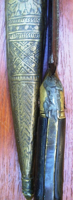

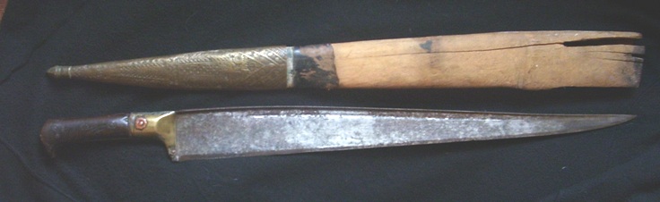

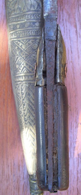

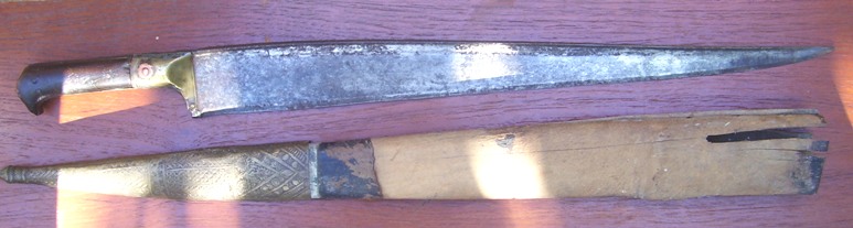

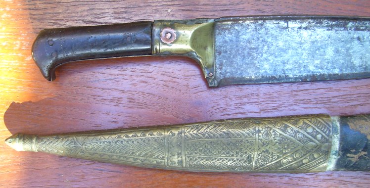

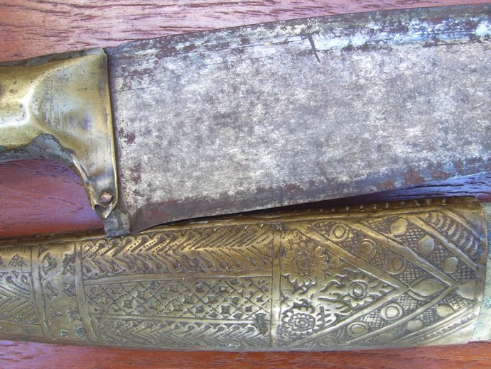

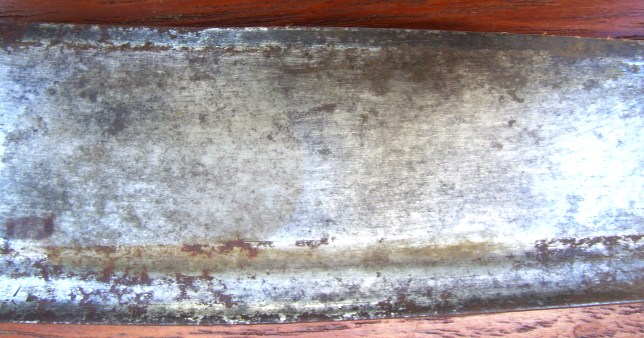

My first Afghan Knife, nice blade, with a 'yataghan' curve approx 25" long and 2" at its widest. Hilt has seen better days, the top (brass ?) strip which covers the 'tang' is missing (which I would like to repair) The grips are horn with no movement the brass sections move slightly.

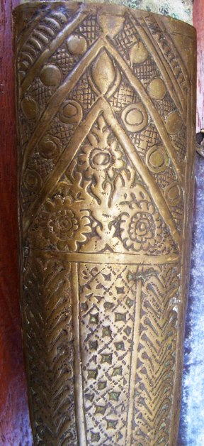

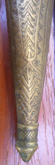

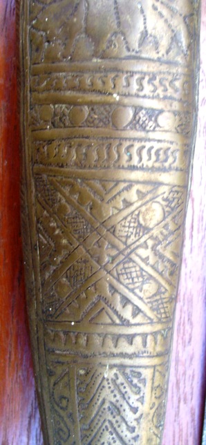

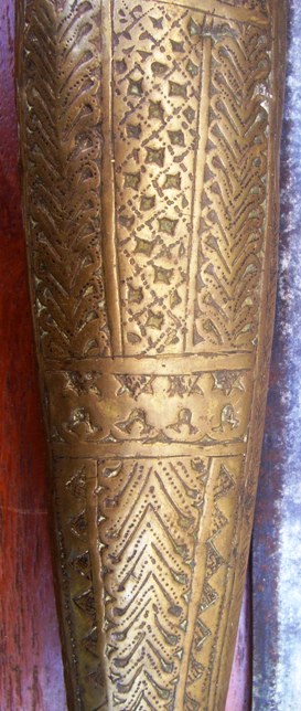

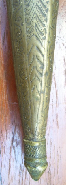

The scabbard has lost its leather covering, has a number of splits with some loss of wood. The chape is brass and very ornate, interestingly there are different designs on each side.
Could the blade be wootz, there does seem to be some patterning, but I am reluctant to remove the very old patina.
Any advice as to restoration, comments etc, as usual, gratefully received.

I would doubt it is wootz probaly just layered up you could get some pattern out of it but I don't think it was orginally etched. black or brown goat would be right

I doubt it is wootz as well. A very well used piece that I would just stabilize and leave it alone. Any more and it would lose it's character.

Thank you Ward and BBJW for your replies.
I only mentioned wootz because Stone shows an example which is described as having a watered blade. The patina suggests the possibility of wootz....but then the Khanda I own also suggested the same but a window etch disproved this
The blade had alot of active rust and obviously had been neglected for some time. (It was discovered in a garden shed ) Nevertheless, the edge was still incredibly sharp, suggesting a 'quality blade',
The crude soldering on the hilt seems old, and the lack of finesse suggested a 'running repair'.
Although I like its 'character' I still think replacing the brass strip on the top of the hilt would be an improvement. Perhaps I could find a way to attach it that is not permanent
Thanks for the ID of the leather 'source' I believe goats leather is commonly used for covering books so should be easily available.
The splits in the scabbard could easily be glued, but some portions around the throat of the scabbard are missing.....not certain whether to make 'in fill' pieces (out of timber) and glue them in position. Or to use a wood filler .....either would be hidden by the leather covering.
Is there usually brasswork around the throat of the scabbard ? I have found very few examples for comparison.
I understand a number of Afghan tribes use this weapon, are there tribal differences that could ID the 'source tribe'. Are there any characteristics of these Khyber knives which help to date them?

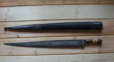

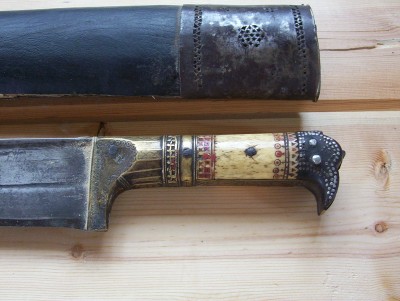

Here is one of mine. This was recently brought back from Afghanistan.
bbjw

Hi BBJW,
thanks, a very nice example, love the hilt The scabbard fittings (on yours) look to be steel or silver ? It answers my question about metal work on the throat of the scabbard.... it would certainly re-enforce this vunerable area.
