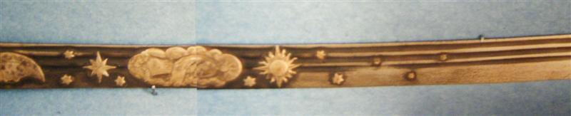

This Polish blade has what looks to be nine stars, a sun , a moon, a North Star (?) and a saintly figure (?).
Does anyone know what the symbolism is for these figures?

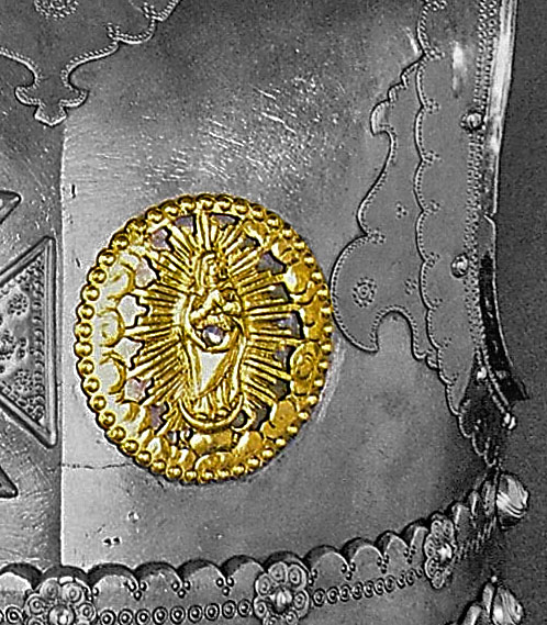

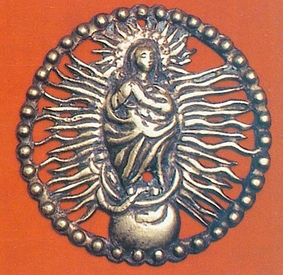

The saint person is probably Saint Mary of Immaculate Conception, the symbol held (for example) by Polish hussars on their armours from the 17th c., not mention the great religious affection of Poles to Saint Mary from the medieval times up to nowadays. According to the liturgy the one was praying to her to receive support and protection ("and through Her intercession, save us from wordly dangers"). But her Person is very often depicted on Hungarian sabres! Especially in the 18th c.!
BUT I'M NOT SURE IT IS HER. Because The Saint Mary of Immaculate Conception was depicted standing on a thin crescent moon, often surrounded by rays of light. Here I can't see any of these, but it's hard to see very details while the picture is not of the high quality. So maybe it is other Saint woman (?). Please check it if you can see more details in the book, maybe there are any attributes in her hands?.
The sun, moon and the stars are common talismanic symbols used on blades in Europe during 18th c., but usually they were etched or engraved on blades, not inlaid with gold. The meaning of these is not clear to me, you can find some remarks in Edward Wagner's book "Hieb- und Stichwaffen" (the big one printed by Artia in 1966), like the Crescent Moon+The Star = conjuction of moon with Venus; the number of 1,3 or 7 means luck etc.

PS. Some pictures of Saint Mary of IC from Polish hussars armours.

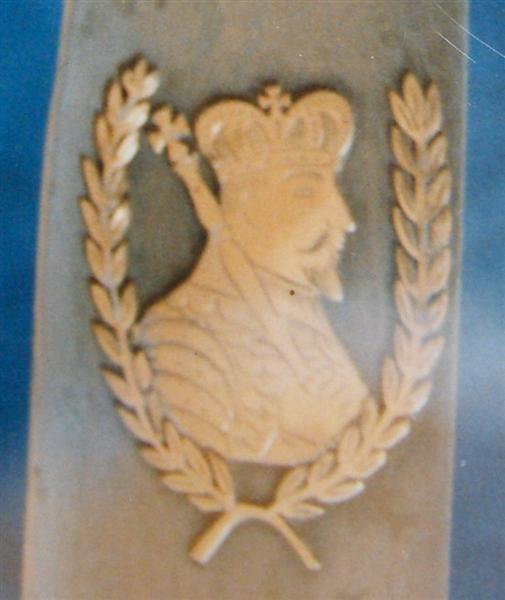

Default Decoration on one of three swords
Wolviex,
Great information, thanks..... This motif on sword stored with previous blade.

Oh yeah! This can indicate this blade as a Polish one.

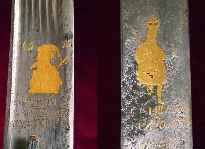

The person on the second picture seems to be king Sigismundus III Wasa, reigned 1587-1632 (Zygmunt III Waza in Polish). So the sabre is called "Zygmuntowka", after his name. This one is late, 18th century example, while most of them where made at the beginning of his reigns ca. 1587, when he entered the to the Polish throne after the death of king Stefan Batory. Some of the noblemens started to make sabres with the bust of king Batory, as the symbol of mourning, and some, on the contrary started to put Sigismundus on the blade. Of course the tradition survived and even in the 18th c. you can find both kings on the blades (Batory is much more popular), who knows maybe made as fakes .
On the picture: first one is Batorowka sabre with bust of the King Stefan Batory, and the second one is Zygmuntowka

Extremely interesting blade, and as Wolviex notes, unusual to see this motif applied in this particular manner over the fullers. The use of the sun,moon and stars were quite commonly used suggesting cabalistic/talismanic symbolism throughout the 18th century and into the early 19th on European blades. The complexities of the occult often preclude exact interpretation of these symbols, though these were widely used throughout blade making centers that included Solingen as well as locations in Hungary. Poland, Styria and others. It would seem that primarily they implied superior quality of the blades they were on.
It would help to get a closeup of the figure in the center of the blade, and as Wolviex has requested, a full view of the hilt.

As Wolviex has noted, this motif with highly religious symbolism and the likelihood of the central figure being the Virgin Mary does strongly suggest a Polish blade. It is interesting that in this case, the crescent moon is depicted separately, though it is below her figure, which may concur with the typically maintained image of her standing on the crescent.
In "The Herder Symbol Dictionary" (1978, p.183), it is noted that "...Mary, as the immaculate Virgin, is sometimes represented with a crown of stars on her head". Possibly the field of stars that are seen in the motif may be added in that manner, and it does seem significant that the total number of stars (including the North Star) equals ten. This may suggest the Pythagorean sum of 1+2+3+4, which symbolizes the essence of perfection and harmony.
The sun in the context of this motif may symbolize Christ, and 'the Sun of justice' (op.cit. p.187).
Typically, the 'talismanic' blades of the 18th century maintained various cabalistic symbols and themes which often included the sun, moon and a single star and often presume occult associations. Most of these have more to do with folklore and alchemical or astrological allegory than the dark connotations that are often suggested.
