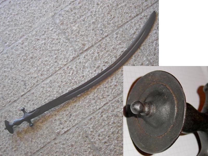

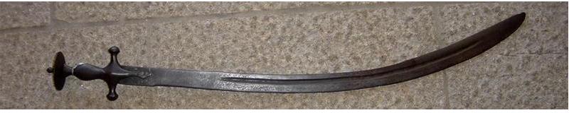

I am calling it tulwar, whereas this could be one of its variants.
Blade is 76 cms.(30") in straight line. The width at forte is 33 m/m.(1 1/8").

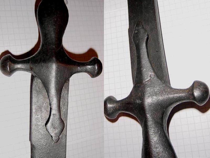

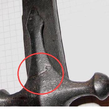

One of the langets was replaced, i think at the period, by brass brazing ( thanks Spiral for the input).
It has a full patina texture, but i am not certain if the dark ( black ) tone is the original, or somebody's later intervention, to perserve it or show it off.
A yelmen is visible, with a discreete protuberance.
What do you Gentlemen think of this specimen?
Thanks in advance.

A wonderful example of what appears to be a tulwar from northwest India regions that is quite likely end of 18th century. It is so hard to really say the age on these, especially from photos, but the sheer simplicity of this piece in the hilt, and the very heavy blade suggests it is indeed a fighting example.
The extremely widening of the blade back is of course what we term the yalman (though it seems there is a degree of dispute on the term), but does reflect influences from much earlier sabre development with nomadic Central Asian tribes. It seems that the feature did not typically stay with most blades found on talwars in the 19th century (there are of course exceptions, especially in very high quality and specially made pieces).

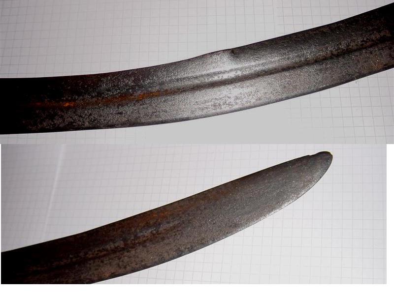

The deep pitting that shows evidence of non uniform pock marking would suggest the integrity of the patination on this sword, but I would defer on that to the more highly trained eyes that often gratefully comment on such matters here. By form itself however, this would seem a good solid example.
It looks wonderful as is Fernando! Please resist the common desire to shine it all up! While there have been some fantastic examples of swords restored here that have endured grinding wheels and terrible overcleaning that were incredibly restored to beautiful condition, this is the one exeption that in my opinion would allow for such measures.
In my opinion, such sound examples of these earlier weapons deserve to wear the patination and darkening they have so honestly earned over so many years (to me it represents a physical manifestation of history but its the romantic in me!).
One thing I always notice on so many talwars is the position of the langet often seems canted to one side and off center. Would this be from the remounting or reworking the weapon? Naturally checking the patination and discolorations etc. for a match would tell more on the age of such work, but could such positioning come from the reseating of the hilt carelessly, or could the position sometimes have been intended? Could striking action cause the hilt to shift later?
Another question, many talwars of the 'standard Indian form hilt' such as this of course exist without knuckleguard. It seems the terms used in Pant may be a bit difficult to apply to particular hilts of specific regions, despite the obvious existence of 'variants' since there was such wide diffusion of components in production. The concept of progressive development does not seem to work either, as the open hilt forms and examples with knuckleguards appear to have existed concurrently and often in common regions.
It has often been suggested, and compellingly, that the addition of the knuckleguard reflected European influence. Since most fighting with the tulwar seems to have been slashing with parrying received by the shield, what would be the purpose of the guard?

Concerning your observation on the tulwar frequent offset of he langets, in my humble opinnion i would go for the version of the mount or remount. Maybe this could easier happen with the specimens without rivet fixation, for lack of consequent adjustment rigour. I keep seeing tulwars without rivets, namely the ancient ones, and in my fantasy the rivet addition came at a later stage ... but that could be because i haven't yet seen enough examples to be certain that these were concurrent versions. Mind you, the example i am showing here was surely remounted, as it had a new langet welded ... visibly not the the same piece put back, maybe because it was lost in battle ( to make it romantic ).

I think what you say on the angle of the langet, and of course it might have been rewelded as you suggest, these weapons were often 'in the shop' during thier working life!

It is, no doubt, a fighting sword, and the repair, which on the picture, seems to be old, would not bother me. It is interesting to see the fuller placed low on the blade, which is unusual.

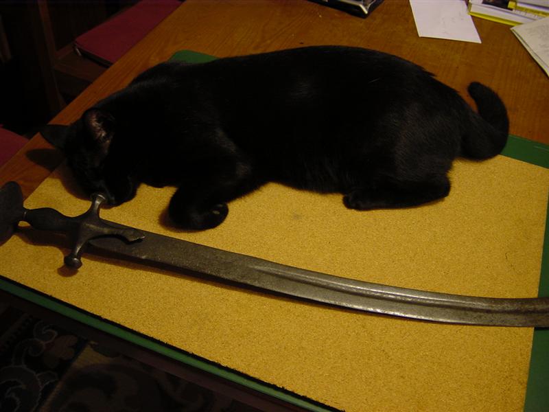

I have decided to buy the tulwar.
To smoothen the price, i had to swap a silver ball pen i didn't use.
The blade is quite thick, some period sharpening is noticed, the patina is quite intense. It realy looks like a real fighting piece.
There isn't much to add in terms of pictures; i just took some more close ups of the langet repair, which i find most reasonable for the period.
But while i was considering what pictures to take, my cat Adrian decided to come around and fell asleep right there. It just reminded me that the Prophet Mohamed once, wanting to stand up from his bed, has cut off a part of his jelaba sleeve, to avoid disturbing his cat's sleep.
All the best

What a fantastic photo Fernando! A wonderfully peaceful and content cat lying asleep next to a beautifully weathered and worn fighting talwar, terrific context. If there were a historic edged weapons calandar this is a perfect example for the illustrations.
The talwar is even better than previously thought, I truly love that heavy patination. Thank you again for sharing this very nice conquest of yours
