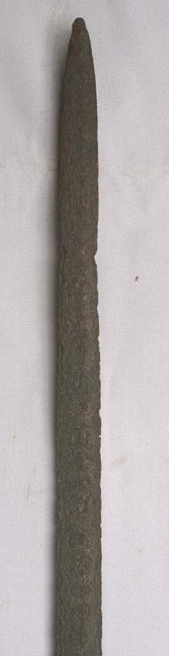

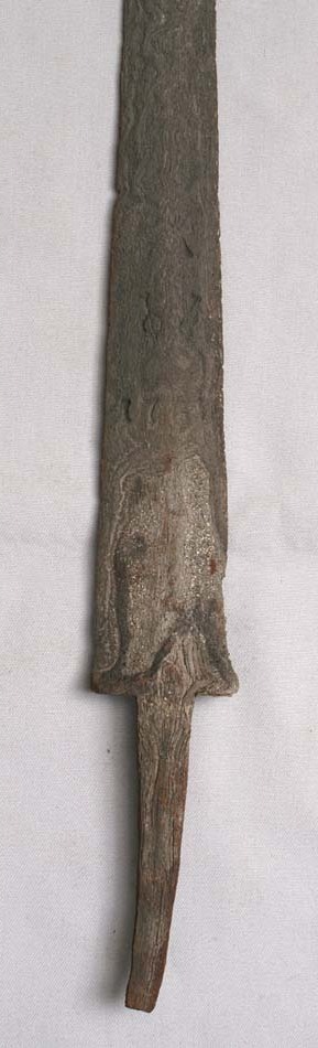

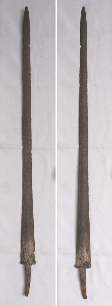

I saw this tipe of sword in Jakarta, Indonesia. I'd like to know where it came from, since it doesnt seem like an Indonesia/javanese sword. there is a sword dealer I'm going to meet regarding to this sword. I intend to buy the sword which is in better condition than thiss pictures shows.
it has double edges. very sharp. wide from the bottom is 4,5 cm and 3 cm to the top.
any comment would be apreciated.
Thank you
best regard,
Ferry ( Jakarta, Indonesia)

It looks Indonesian to me. What about makes you think it is not. Some better and closer pics of the motifs in the metal work on the sheath might tell something.

It is indonesian and probably from Java. It has a pamor blade. This sword is called a pedang lurus.
I cann't discover anything chinese on it.

Pedang lurus is what i would call it as well Henk.

From what I can see in the pics, I also am of the opinion that this is Javanese.
Yes , it is a straight sword (pedang lurus), but I would be inclined to name it "pedang suduk" (stabbing sword).

I'd like to know , should I stain the blade to show the pamor or just clean it and put some oil on it?

I believe that the Jawanese tradition would be to clean and stain it.

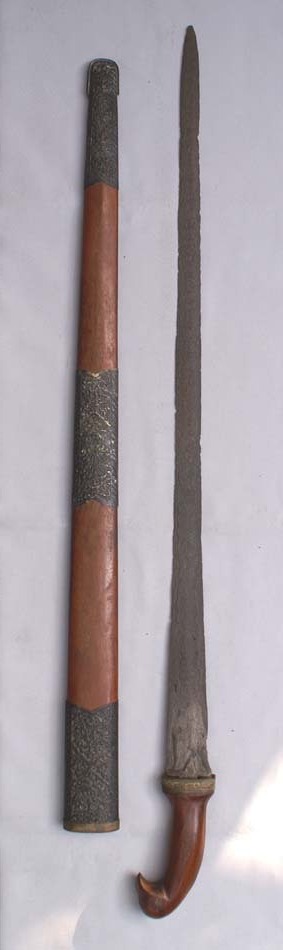

stain it. gonna ruin the edge since it still has a straight and sharp edge.(not the sword in the picture)
I cant find any suitable scabbard design. in the pictures I posted seem too chinese. any idea?

I am confused. Staining would not necessarily ruin the edge of the blade. And what sword are we talking about if not the one in the picture?
What seems too Chinese about this scabbard?

The sword you saw in Jakarta is SIMILAR TO the sword of which you posted a picture.
Understood.
I think you confused us a little --- or maybe we confused ourselves.
When you actually have the sword you intend to purchase, in your hands, how about if you give us a picture of it, and we can comment on the actual sword you are talking about, instead of one similar to it?
That scabbard of which you posted a picture does not look Chinese to my eyes.With that kepet, it looks Madurese. I cannot see the motif in the brass work very clearly. Is it a Chinese motif? If so, it might have been put together by a gentleman of Chinese descent, living in Madura, or perhaps East Jawa, around Surabaya.
If in fact the sword you will purchase is Javanese, it should be stained. Done correctly this will not damage the edge.
If I were to order a scabbard for this type of blade I would probably opt for a scabbard without metal fittings. Probably akasia wood with good serat nginden, buntut sungu, and sungu at the mouth of the scabbard. The two pieces of sungu should be fitted in such a way that the wood penetrates the sungu and the sungu serves to add strength to the joint of the wood. If you can get a tukang wrongko to make the wood as terusan, rather than sambungan, this would be best, but the wood should still penetrate the sungu.
If you need to get the handle made too, there are a number of designs you could use. I rather like that dove pattern on the sword you have shown a photo of.
