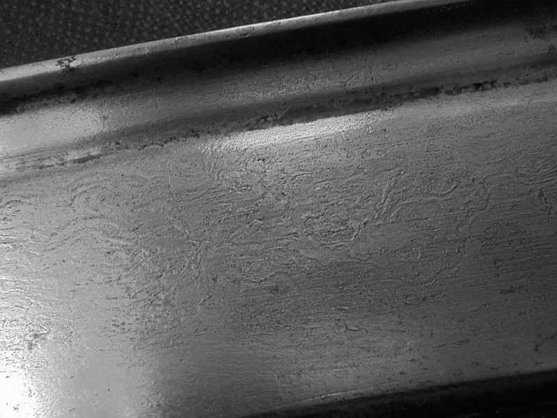

A salawar yataghan .
Opinions , comments ?

Hi Rick, is there so little difference in the colouring as shown in the picture, have you manipulated it, or was the light bad when you photographed it?

It looks like it's been etched and then lightly polished, leaving the "geographicalness" (hee hee hee; I hope you know what I mean; I'm fevery, so that's the best I can do), but removing the colour?

I shot the picture last night under artificial lighting , as a result the red shift was uncorrectable so I removed the color .
Tom,
Yes the blade seems to have had a strong etch in the past but when I received it there was no perceptible color difference .
There are other areas along the edge that look homogenous , most of this pattern is away from the edge nearer the spine .

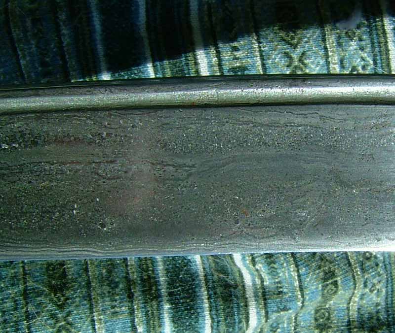

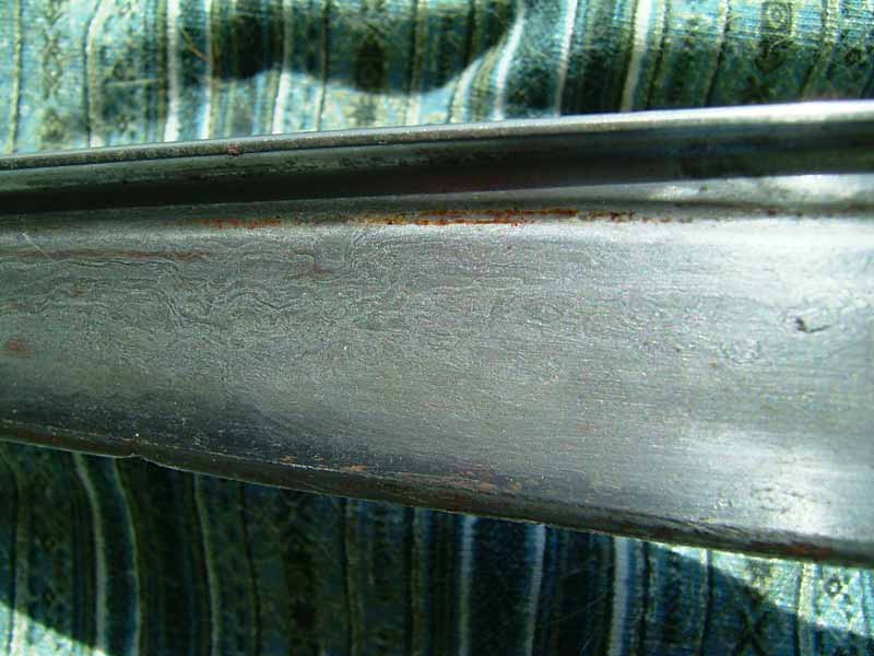

Here's one shot in daylight .

It does not look like crucible steel to me. Possibly preferentially etched.

Rick, this might be real wierd on a wootz blade, which I think this looks like, but doesn't that almost have the look of an inlaid edge? It could be smooth from sharpening, but I seem to see an etched dividing line? Where is the scientist formerly known as Moltenmuse? Sorry Ann; I liked your old name

Tom , I don't think the edge has been inserted , some of the homogenous areas are quite wide .
I was thinking more of the edge hardening process making the pattern disappear .
This is a pretty crazy pattern for a laminar welding process IMO .
Now this is a laminar forged Yat. blade and you can see the layering right up to the edge .
Then again I'm no genius about this stuff , all I do is push a broom around here and try to learn .

Whew! I thought at first that was a new view of the same sword, & was gonna say now it DOES look like lamination; always good to read the whole thing!

Rick, I thought that, too; that the pattern is very fine-grained and awfully "randomly" active for laminate. Of course, I defer to Ann on this subject, and I'm far from certain; in person, maybe. Would hardening heat remove the pattern? I could see it would change it, but I thought it took more like welding heat (much hotter) to remove it?

Sorry for creating confusion there Tom .
The new picture is of a Balkan or Greek Yataghan .
Both of these blades have been strongly etched .
I don't want to digress but the Yataghan blade shown has many areas that show a crystalline look .
I'm sadly ignorant of the effects of differing heats during forging .
I think I was sleeping during class .

Hi Jens , I think I'll try to give this sword a light etch in the next couple of days then I'll try some more pictures . The pattern is not consistent over the length of the blade .

I am far from an expert on blade metallurgy but thought I would give my .02. I don't believe it is an artificially created damascus pattern, ie, wax resist and created via acid. The pattern is too random for that in my opinion. I also do not believe the blade is wootz. However, wootz can be melted away either during the forging of the blade or while differentially heat treating a blade. If the temperature is not controlled throughout the forging process, you can have "dead spots". What I am seeing on the blade almost looks like "hada" that you see on a Japanese sword. Perhaps this is a folded blade with a heat treated edge and what you are seeing on the blade is the grain of the steel from the folding and then the heat treatment has created sort of a "hamon" along the edge.

The pattern on your blade looks to me as if it is in relief, which is strange. I think I have seen it before, but at the moment I don’t remember where, but to me it suggests an acid treatment of some kind. How is the colour of the blade, is it a ‘dull’ grey?

" The pattern on your blade looks to me as if it is in relief, which is strange. I think I have seen it before, but at the moment I don’t remember where, but to me it suggests an acid treatment of some kind. How is the colour of the blade, is it a ‘dull’ grey? "
Hi Jens , yes it is fairly grey .

My opinion is that the pattern is arising from layers and the grain pattern of the steel.

nice blade... looks like a flat laminate... and lotsa layers
