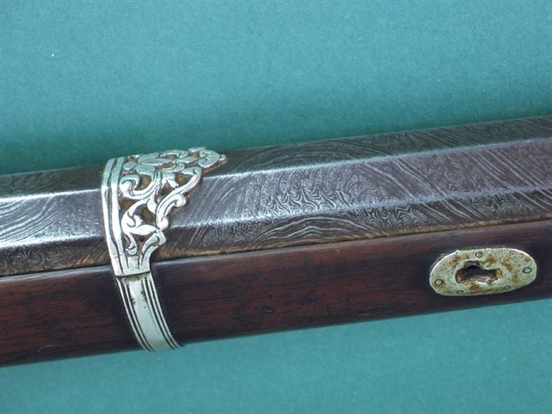

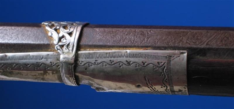

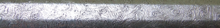

This Ottoman barrel has a beautiful pattern weld of a complex pattern. India, Turkey, Russia and many more countries all had some great artisens making complex pattern welded weapons. The craftsmanship simple amazes my tiny mind.....
More pics at: http://turkishmiquelet.blogspot.com/

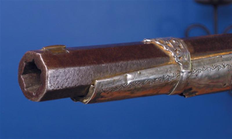

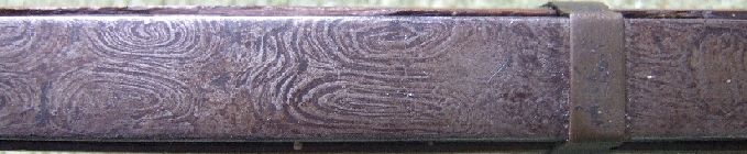

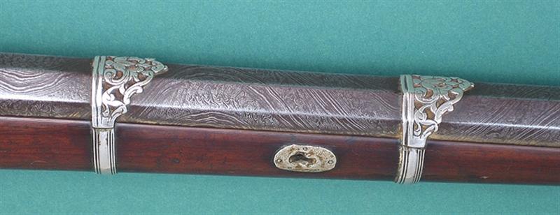

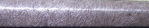

Pattern welded barrels are interesting here is a few more patterns. One is on a square barrel

Thank you posting this beautiful barrel Rand!
The square barrel seems really unusual, is this form indicative of a certain period or weapon form or favored by any particular group? Is there any significance as far as the reason for the square shape?

wealthy people always wanted something unusuall. This particular one is indian early 19th century. I have another one that I have not definatly figured out origin of. I have even seen a square barrell that fired square bullets. These are the only 3 I have ever seen

Ward,
The square barrel mughal rifle form the Figiel sale purchased by Bob Hale never left the USA, mostly because of ivory related export problems. Square barreled gun are indeed very scare, and that also has a square bore, thats a rare puppy. Have never seen an Islamic one like that.
There are examples of early European guns that have heart, diamond and club, and spade shaped bores also in a slow twist, just amazing to think about. Reason for shape of bore on those was listed as talismanic.
Great examples of barrels Ward, thanks for posting those. Believe you are right on the mark about people of wealth wanting something different.

i'M unsure, but the square one appears to maybe be a faked pattern.
Hi Tom,
Have to respectfully disagree with you Tom, the etched pattern on the square barrel looks very good. There are also a few similar varients of that pattern, one being from a firearm identified as being from Tibet where the etched pattern weld hints of being a stylized cloud in appearance.

no It is not a acid etched pattern. just a well made pattern weld
Hi Ward,
Are you saying the pattern welded barrel design is brought out by polishing only?
My understanding is the barrels were polished and then etched in an acidic soultion to bring out the pattern clearly.
In no way am I inferring this barrel to be a type of "false damacus", its a rare and amazing example of a Turkish firearm.

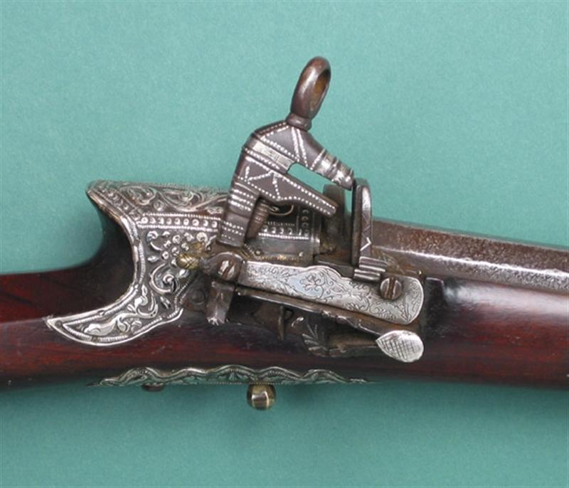

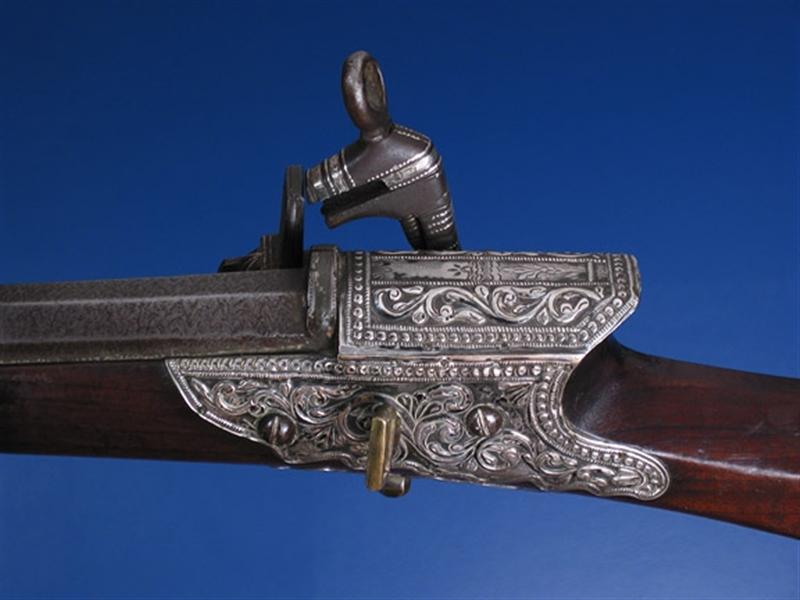

Ward,
Can you show photo's of the locks? Am assuming they are mounted with a type of miquelet lock.

you are corect I was saying the pattern was not carved in wax and then acid etched as in false damacene . I will get some pics up soon

Rand,
That barrel is worth reproducing. Another smith is coming to my shop this winter and we were planning on making some barrels. I would enjoy as many pictures as you can provide...especially of the breech and the end of the barrel.
What it looks like you have there is double row of twisted which has been ground to about 30% its thickness to get that star pattern to show well. The straight laminate is along side and it appears from what I can see in the reverse twist that there are eight sections (like and orange) -- four of the double twist and four of the straight. It is not simple to make the orange sections, but to do a reverse twist on the barrel is something difficult indeed..prone to welding shear.
Ward,
That last picture is a nice accordion folded jelly roll...not a simple thing to do.

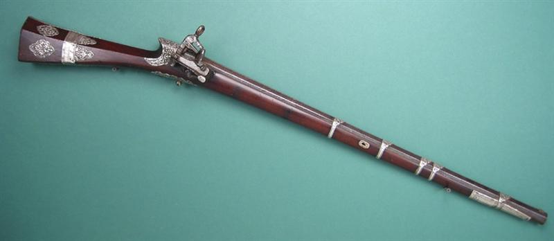

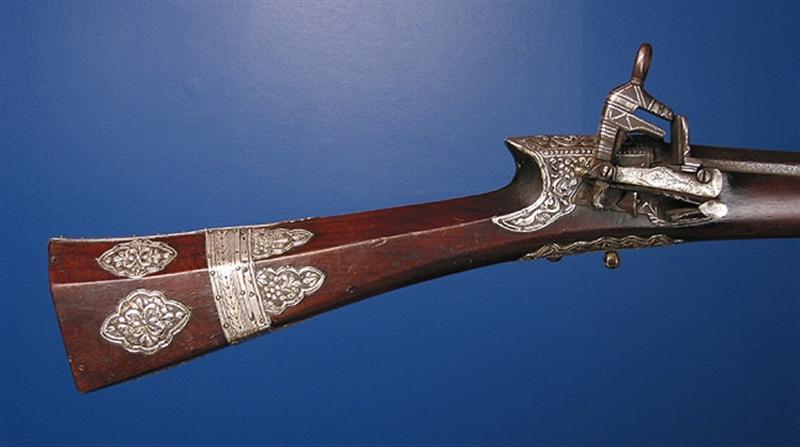

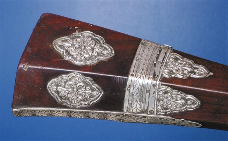

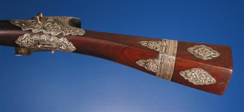

Default Turkish Miquelet Pics
More Turkish Miquelet Pics...
rand is offline   Reply With Quote

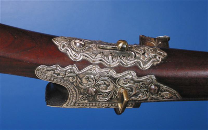

Posts: 539
Default More Miquelet pics
More Miquelet Pics

Default Larger Files on Blog
hi Ric,
The image size is larger on my blog so the enlargement is a bit clearer, hope it helps... Hope to get a good digital camera soon to take large file size images coupled with a quality lens. Being able to share very clear images that you can study in detail would made out hobby/passion that much better.
rand

How long is the barrel?
Richard.
Old 14th August 2007, 06:32 PM   #21
rand
rand's Avatar
Join Date: Jul 2007
Location: Virginia
Posts: 539
Default Barrel
Barrel is about 34" from tip to rear of sight... Any opinions as to age of this firearm?
rand
Old 15th August 2007, 01:08 AM   #22
Posts: 7,407
Many many thanks Rand. 18thc? That is why I love Ottoman stuff - so much artwork and craftsmanship.
