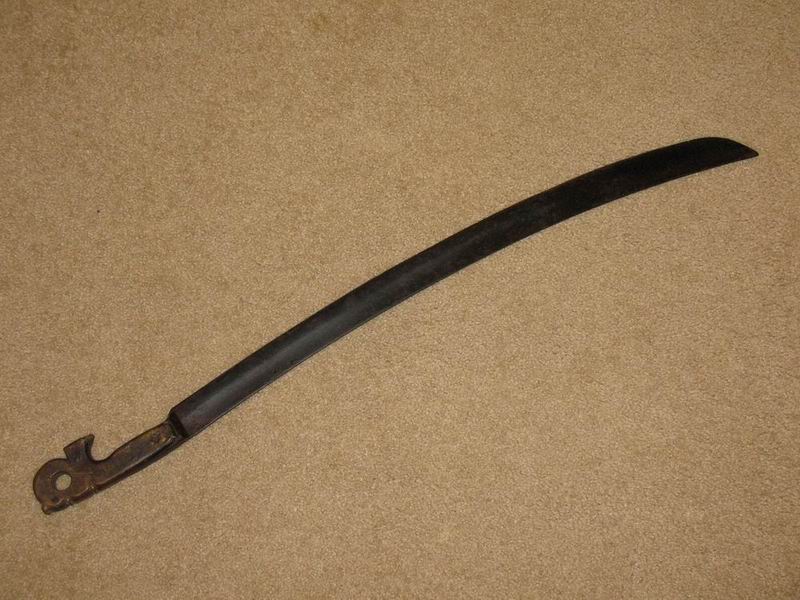

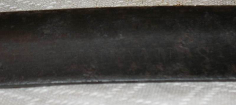

I picked up this Berber sword and I set up to clean the blade tonight. I still have a lot to go, but under the rust an inscription started to appear. It reads "PARA LOS VALIENTES DOMINICANOS", and I guess this translates to "FOR THE BRAVE DOMINICANS". I have tried to take a picture, and you can probably barely make out the last few letters of "Dominicanos", but it is quite faint. I will try to take some better pictures once the sword is clean.
I think in a previous thread it was noted that these sabres originate from Spanish Morocco, and if this is the case I guess it is not so strange for a Spanish blade to appear on a sword of this type. I am wondering though, does "Dominicanos" refer to inhabitants of Haiti (Hispaniola), or just Dominican Missionaries? If it is the former, it could make quite a story, worthy of the worst eBay descriptions (although I have not quite figured out the Confederate link yet).
I would love to get your thoughts on this piece.

I'm not sure I can add anything to the interesting motto inscribed on your sabre, but I would like to see some discussion open on this intriguing sword form. While the general consensus over the years in discussions seem to hold that these are from Spanish Morocco, with pretty compelling support, I have been advised also that these are not Moroccan. It does seem interesting that examples of these have not ever been included in groupings of the weapons from Morocco in published material, and it does seem that these have expanded from complete obscurity into an established form in growing numbers over the past 20 years.
Probably the most fascinating consistancy in most of these, aside from the unusual stylized zoomorphic hilt, is that the blades are typically 19th century cavalry sabre blades (usually British M1796) with strangely profiled points.
To confound establishing identification even more, the scabbards these are typically mounted in have a curious perpandicular extension, similar to those seen on Ethiopian shotels (mounted with military sabre blades) as seen in "African Arms & Armour".
It seems that around the end of the 19th c. and into the 20th, certain very unusual forms of edged weapons began to appear in Spanish or Latin American settings. Perhaps these were ersatz weapons put together from available surplus, but where is unclear. Another form of munitions grade sword with often crude blades and brass hilts with exaggerated finger stalls is known, and I have seen these identified as Mexican, and even Algerian, but lastly as 'bringbacks' from Cuba during the Spanish American War.
These unusual 'Berber' sabres, I have seen included in groupings of swords from Mexico, so I am wondering if these might have evolved in the situation I have described.
Or, are these indeed from Morocco, and is the decorative motif seen on hilts or mountings consistant with Moroccan work?
What we need is contemporary photographic evidence of these being carried or provenanced examples.

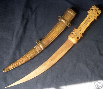

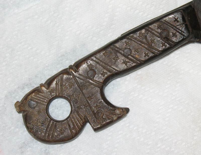

Thank you all for your excellent replies. It seems that the origin of these sabres will be subject to a fascinating discussion until we are able to find a contemporary photo of a warrior wearing one. I can deffinitely see some justification in a Central American attribution - the blades, the motto on mine (most certainly not etched in the Maghreb), and the guardless hilts with horn scales not dissimilar to some Mexican swords and knives. While I will be quite happy with whatever it turns out to be, for the discussion's sake I am going to argue in favor of a Maghreb origin.

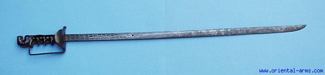

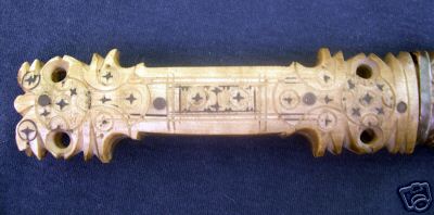

Searching the forum, I was able to find a shula, posted by ErnestoJuan, with hilt decoration quite similar to the decoration on the hilt of my example - note the little crosses. Here is also a close up of the hilt of a sword sold by Oriental Arms, and its inlay to me looks similar to the inlay found on the hilts of certain daggers from Mauritania. Although the Latin initials certainly complicate this theory.
Finally, I have attached a photo of a sword, Artzi had identified as originating from Spanish Morocco. Jim, is this what you were referring to as most likely coming from Cuba?

The bottom sword is exactly what I was referring to! Although I have seen examples of these provenanced distinctly from Mexico, in a discussion with a distinguished author on Spanish Colonial weapons, he informed me that years ago these were identified as having come from Cuba during Spanish-American War.
