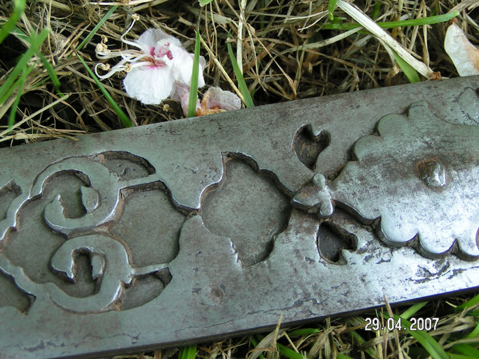

Default Cleaning of khanda.

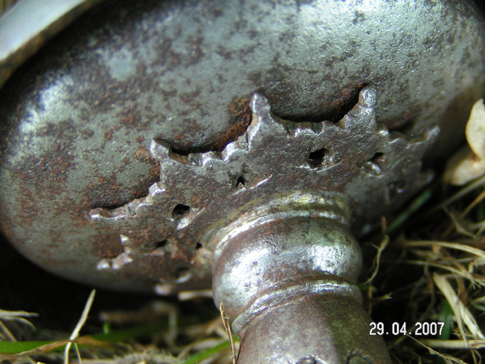

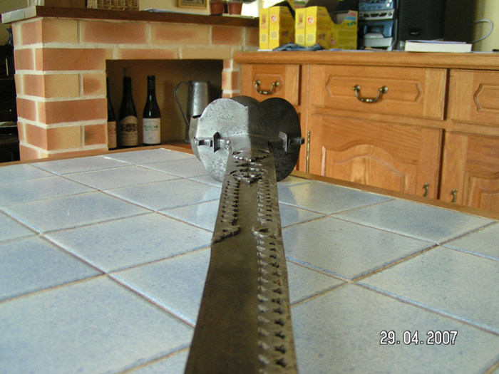

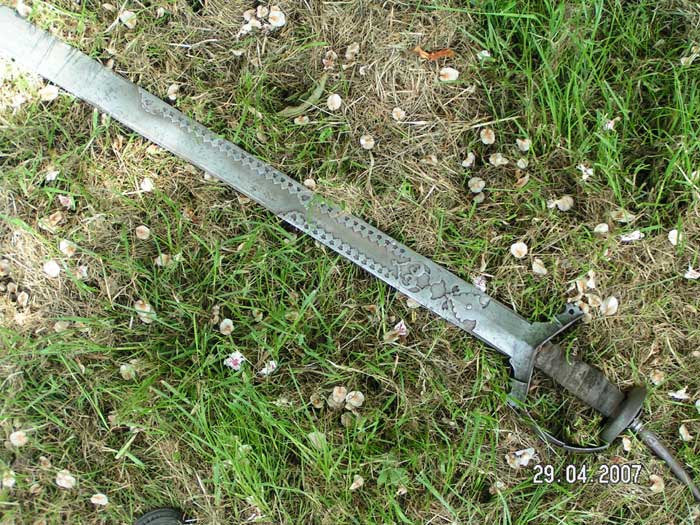

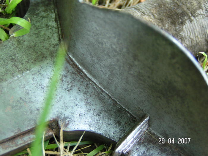

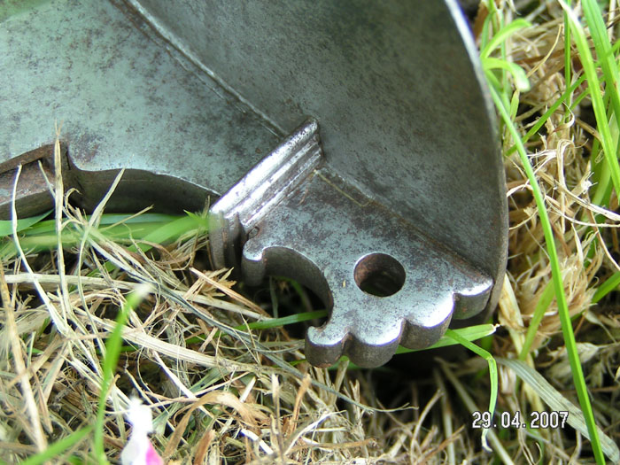

I made a very soft cleaning.
Before cleaning.

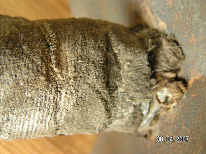

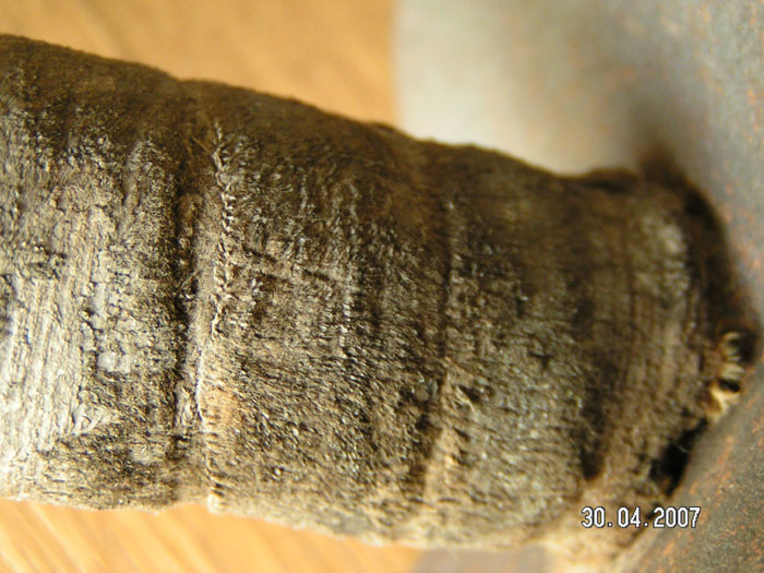

Hi Galvano,
good job nice Khanda nice blade are you going to give it an etch?
The wrapping on the handle....is it leather (suede side up) ? How is it fixed to the handle ? Sorry for the questions ...but I would like to restore my Khanda...the wrapping is missing
Regards David

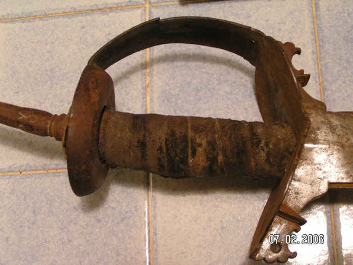

Hi all
the handle is covered with velvet.
The scabbard also.
I think that it is stuck.
I will clean it a little more.
Later I am going to give it an etch .
galvano is offline   Reply With Quote

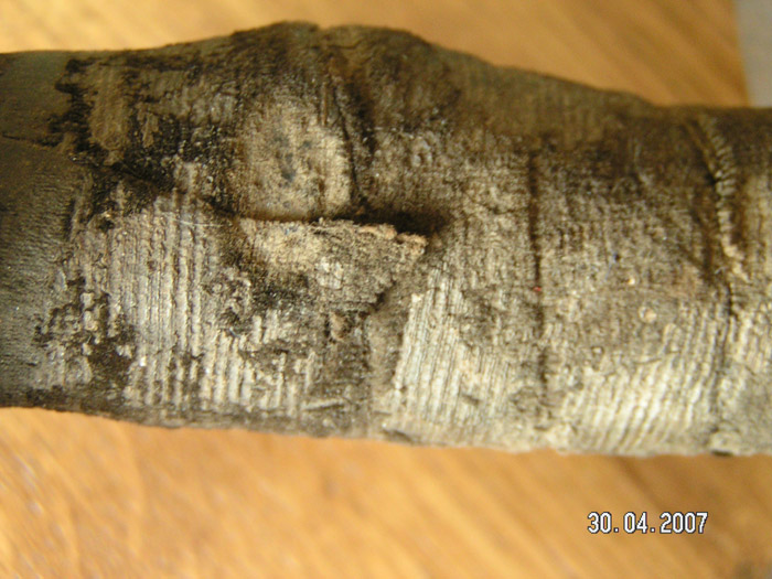

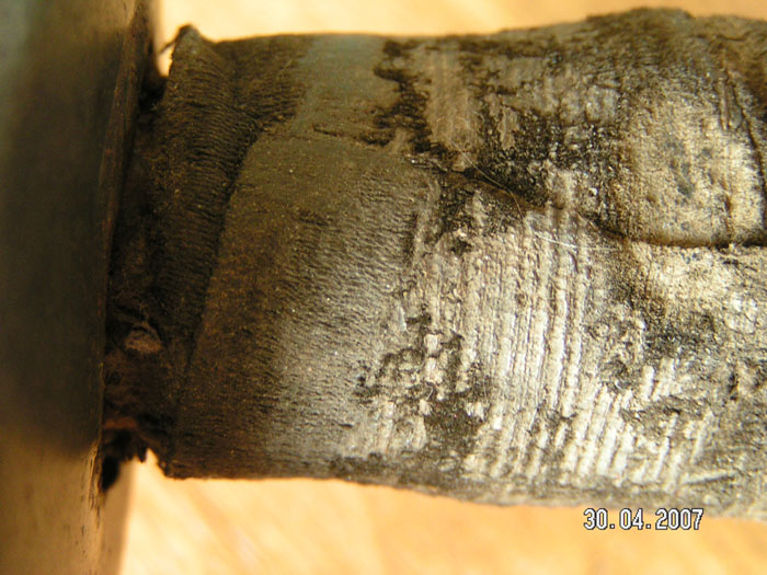

Old 30th April 2007, 09:37 AM   #5
galvano
galvano's Avatar
Posts: 178
Default velvet
velvet on hilt

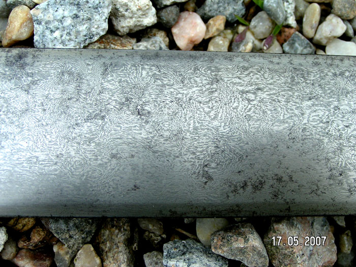

galvano
galvano's Avatar
Posts: 178

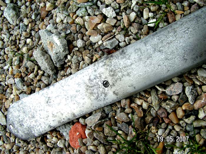

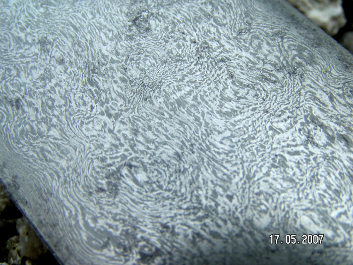

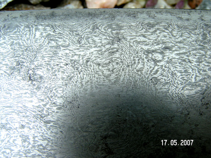

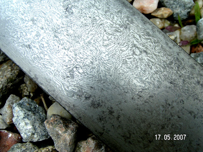

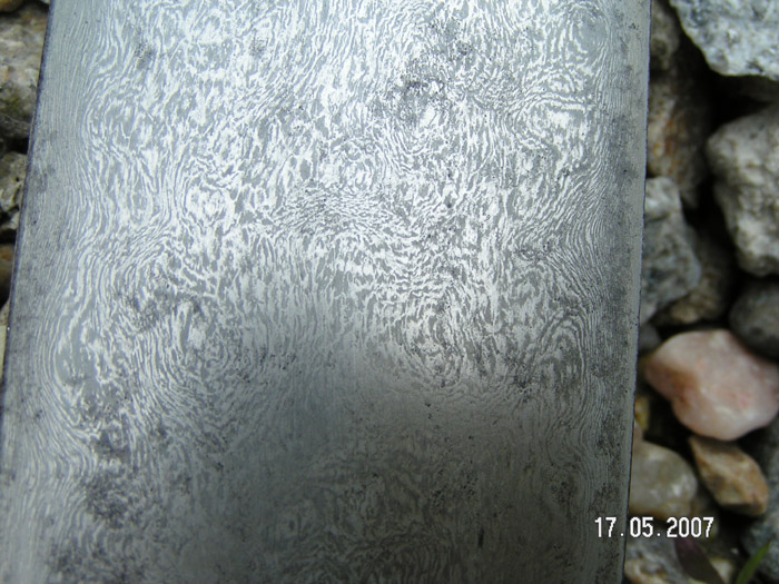

Default etching test
On part of my khanda.

Old 17th May 2007, 09:37 PM   #8
Jens Nordlunde
Jens Nordlunde's Avatar
Location: Europe
Posts: 2,718
Hi Galvano,
Dicely done, but what did you use for cleaning?
Old 17th May 2007, 10:03 PM   #9
galvano
galvano's Avatar
Posts: 178
Default cleaning
hi all
I polished with very fine bodywork paper.
I cleaned with acetone.
And attacked with ferric chloride.
Neutralized with crockery product.
Oiled.
galvano

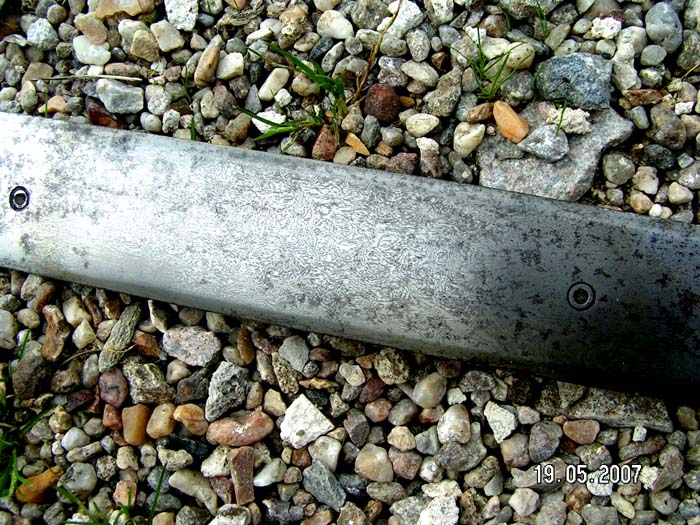

Old 18th May 2007, 04:06 PM   #11
Jens Nordlunde
Location: Europe
Posts: 2,718

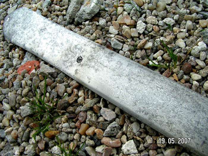

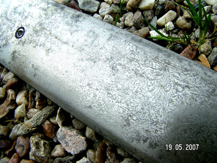

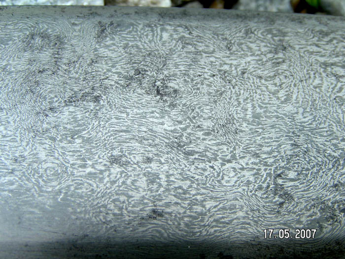

Hi Galvano,
You have done a very good job, and shown us some exceptionel good pictures - thank you.
The watering is very nice, but what does the tip of the blade look like?
Jens
Old 19th May 2007, 04:40 PM   #12
galvano
galvano's Avatar
Posts: 178
Default the tip
hi jens
It is the khanda.
The other photographs were in macrophotography.
Old 19th May 2007, 04:46 PM   #13
Jens Nordlunde
Location: Europe
Posts: 2,718
Thanks Galvano,

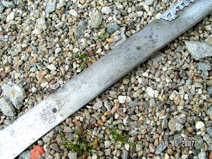

How many marks are there along the blade, and are they on both sides?
Jens

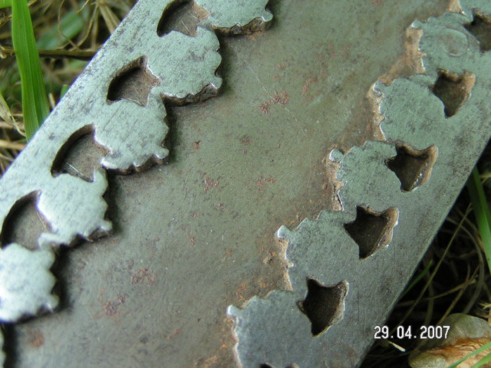

Old 19th May 2007, 06:02 PM   #14
galvano
galvano's Avatar
Posts: 178

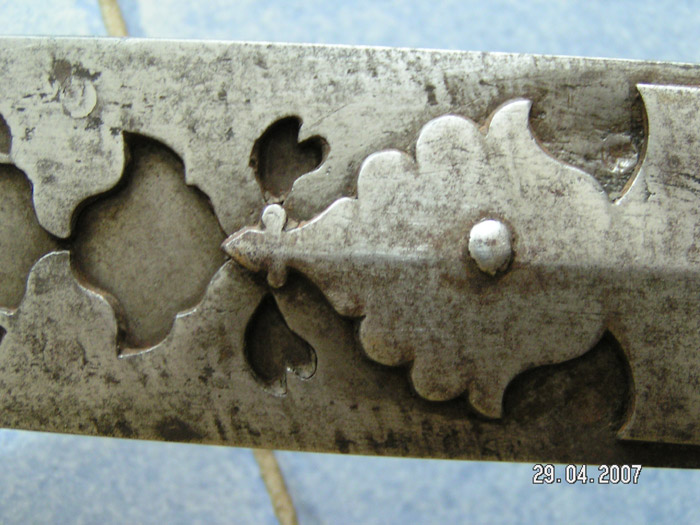

Default marks
There are 3 marks
Like stopped holes.
Who cross the blade.
at the end there is silver
galvano

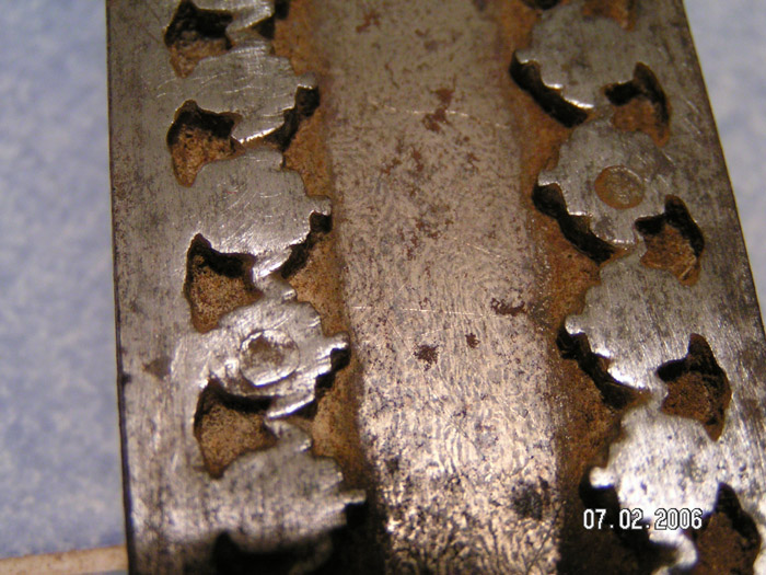

Old 19th May 2007, 06:06 PM   #15
Jens Nordlunde
Location: Europe
Posts: 2,718
Are the marks on both sides?
Jens
Old 19th May 2007, 07:38 PM   #16
galvano
galvano's Avatar
Posts: 178
Default marks
yes on both sides
Old 19th May 2007, 09:37 PM   #17
Jens Nordlunde
Location: Europe
Posts: 2,718
Galvano,
I have seen blades with markings like that along the blade, but they were filled with brass. Funny that the last one should be silver , and the other ones not.
Jens
Old 19th May 2007, 10:25 PM   #18
galvano
galvano's Avatar
Posts: 178
Default utility
I do not understand the utility of these marks
galvano
Old 20th May 2007, 12:57 PM   #19
Jens Nordlunde
Location: Europe
Posts: 2,718

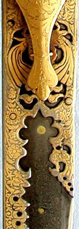

I have only one Indian sword with holes like that, and on mine they are filled with brass like i wrote. The number of holes is three – and the sword is a khanda. Unfortunately I don’t know what this means, and so far I have not met anyone who knows. I have seen blades with only one hole filled with iron, this is said to be from testing the blade, but why test the blade and not the ingot? Unless of course the blade was already made for export, so the only test which could be made, was testing the blade – maybe this is true, I don’t know.
Jens
Old 20th May 2007, 05:32 PM   #20
galvano
galvano's Avatar
Posts: 178
Default photo
do you Have a photograph of your khanda?

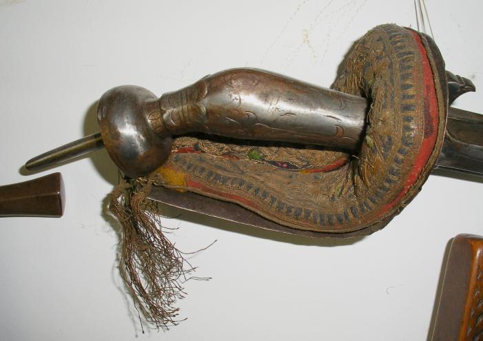

Old 20th May 2007, 07:13 PM   #21
Jens Nordlunde
Location: Europe
Posts: 2,718
This one shows two of them.

ok for the holes.
I would like to remake velvet in the basket hilt.
Do you have a model?
thanks
galvano
Old 21st May 2007, 09:09 AM   #23
Jens Nordlunde
Location: Europe
Posts: 2,718
Sorry, but I can't help you with the hilt, can't you use the old one for a model?
Old 21st May 2007, 03:09 PM   #24

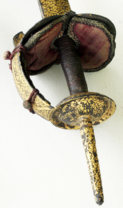

Posts: 6,429
Hi Galvano, perhaps the cushion is made in the same manner as this one from a Sumatran peudueng .
Old 21st May 2007, 04:37 PM   #25
Jens Nordlunde
Location: Europe
Posts: 2,718
Good idea Rick, I found one as well. The protection along the hand guard is held in place by two textile buttons, but the rest is not fastened at all.
Old 21st May 2007, 06:28 PM   #26
Posts: 6,429
Thanks for that picture Jens .
Old 21st May 2007, 06:41 PM   #27
galvano
galvano's Avatar
Posts: 178
Default good
Thanks all for your contribution, that is very good exemple.
I have red velvet and the grip is brown ???????
galvano
