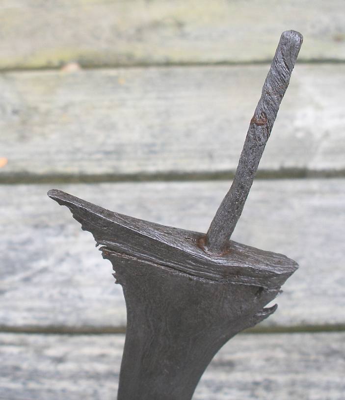

Hi Michel, I'm not too sure what you mean by angle in this case .
This first example I've posted seems to be pretty much at a 90 degree angle to the ganja.

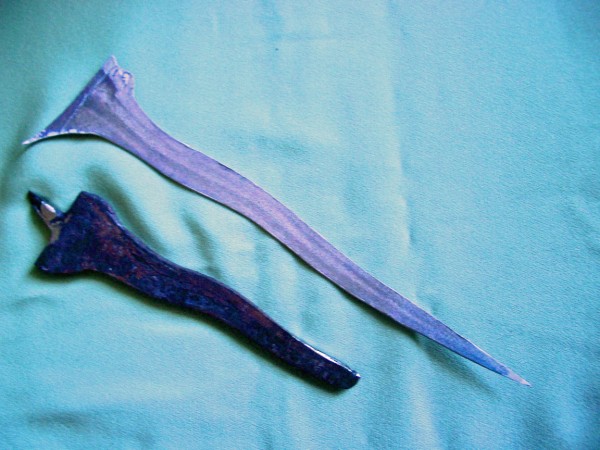

Or do you mean the attitude or angle the keris blade assumes when dressed as shown in the second picture ?

Thanks for your answer. There are two angles to consider:
The first that you mentioned with your first picture: is not 90°. It is systematically slightly off 90°.
The second is the clearly seen on your second picture : If you prolonged the Axe of the ganja you have clear angle with the Axe of the blade.

Hi Michel, I was told by one of our members that this attitude of the blade is called Condong Leleh and that it relates to the gesture of sembah.
