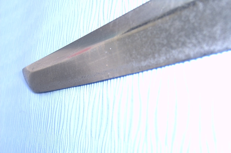

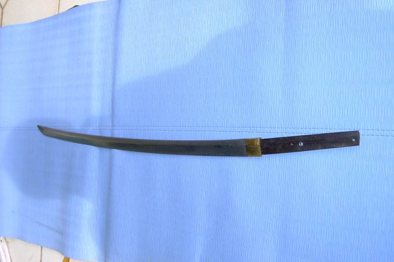

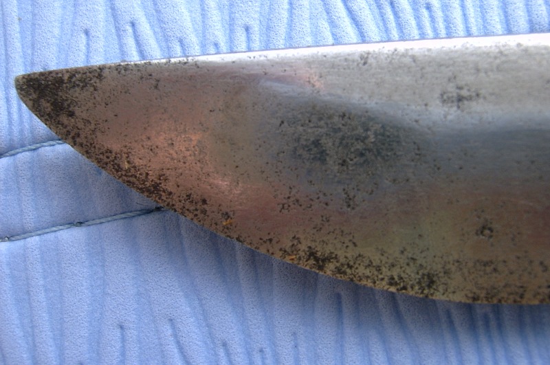

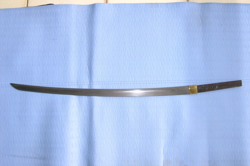

dear all....
I have this ( katana ) since 5 months ago, but I have no idea whether it is a real katana or a fake one. I only have the blade with out any its fittings.
I really like to know any thing about this sword...26 inch edge and 8 inch handle.
thank you before,
best regards,
ferry

It depends on your definition of " ethnographic" the Japanese would not define it as such...
I think it is real and old. The patina is heavy, brown and uniform, not artificially-induced. Several holes indicate that the handle was changed at the very least once.
Nihonto afficionados would insist on full polish. That would put you back several hundred bucks. Last time I heard, it's ~ $60 per inch. If you are a Nihonto freak, you have no choice but to sell your firstborn and send the sword to Japan for an authentic polish. Also, as it is not signed, you would have to request the NHBTK ( or whatever it is called) examination and certificate: another $1,000 or so.... Then you will learn that there are some defects that prevent this sword to be regarded as a masterpiece. I made a firm decision not to collect Nihonto: too expensive, too high-brow, time consuming and... they just do not speak to me
The several I have, are ready to be swapped for Shashkas: that is what I call a beautiful sword!
To each his own

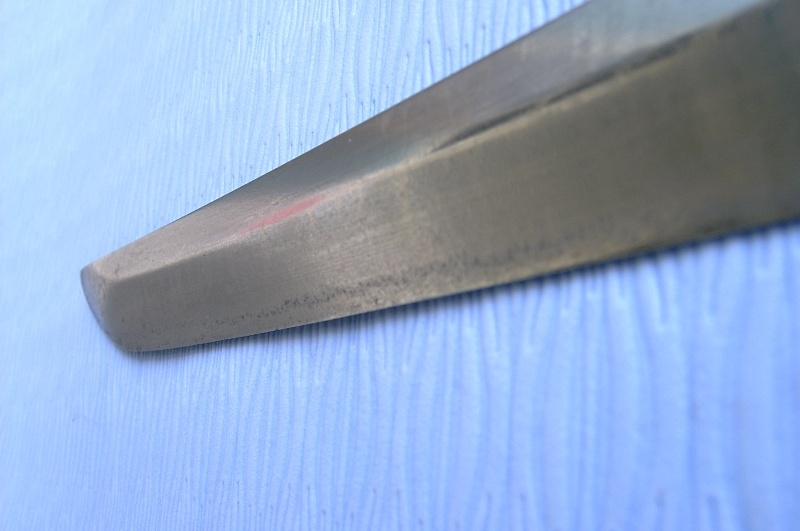

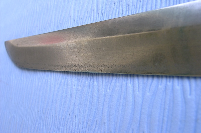

To my inexpert eye, the ridge line and kissaki (tip) look soft and ill-defined. Not generally what one expects to find in "real" nihonto.
I hope someone with more experience than I with Japanese swords will come along and comment.
Rich? Carlo?

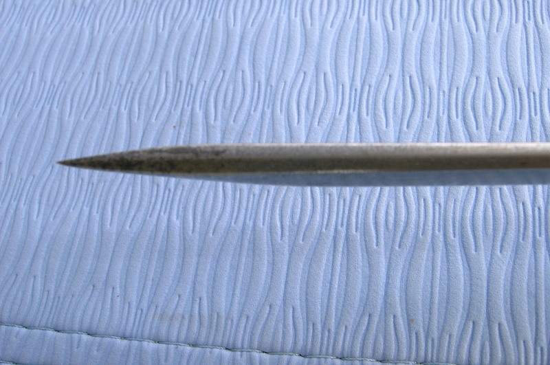

If I had to guess without handling it, I would say this is an old nihon-to. One that has been shortened at least a few inches, cleaned harshly in the past with abrasives, rusted a bit more, cleaned again, and someone has drilled two incorrect small holes in the tang.
Of course, I could be way off base, but turning the top pic sideways it looks like a good profile. The lines are all distorted and the habaki has at the very least been sanded and buffed or something. The shortening job is odd too, not really careful. In fact, most of the lines look off. But, I'll go out on a limb and suggest it is an old one. Just my opinion.

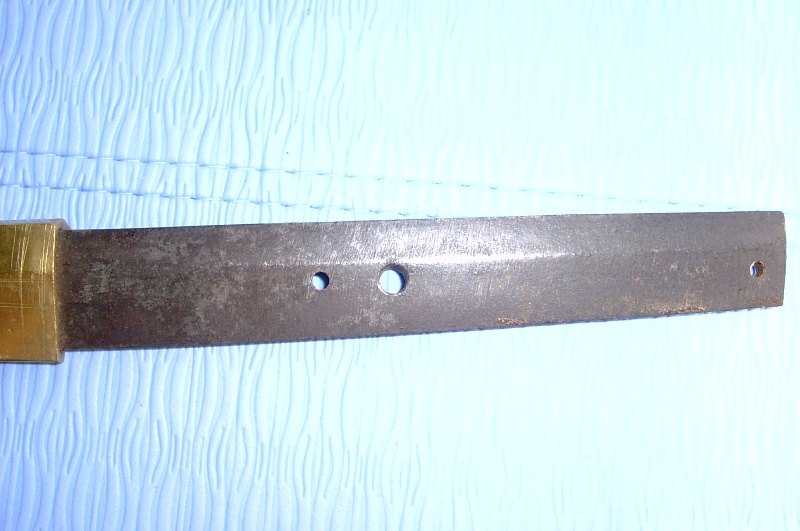

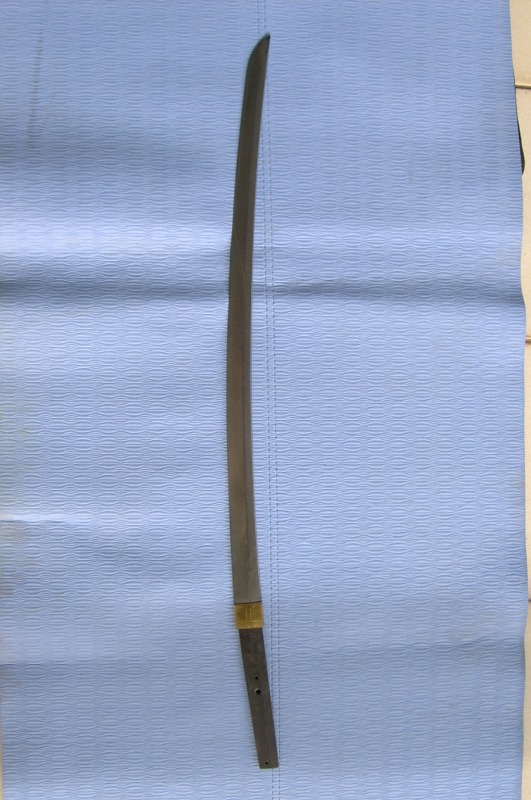

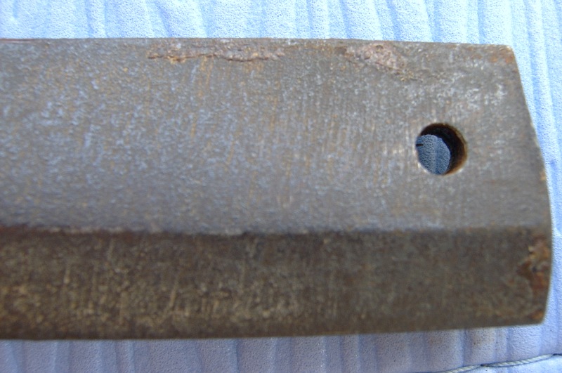

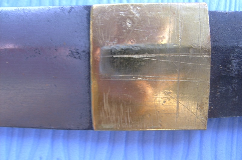

I believe the hole positions look odd because the tang has ben shortened.
From what I hear, in the US Robert Benson is one of the best polishers. I cannot recommend him from personal experience, however, just suggest him by reputation. He ID'd my gunto (unsigned tang) to period & school, so I imagine he could tell you something about yours if you want to send it to him for evaluation. http://www.bushidojapaneseswords.com/
Am I wrong, or is it problematic to send nihon-to back to Japan? I thought they would be confiscated as contraband if not art swords (non-art swords are illegal in Japan), and confiscated as national treasures if they were. Great Catch-22 there.

here more pics to see
have a look please...

Maybe you could try passing a bit of lime juice on a spot of the blade to see if it brings out any temper line/hamon. That would at least let you know if you have a sword or not.
Emanuel

The citric acid will darken the edge considerably if it's tempered. If you have the differential temper, then it may mean you have a forged Japanese sword. If there is a hamon, then Mr. Mishina may be more interested to examine the sword. If there is no temper line, then it could be the mass-produced WWII kind or a newer piece.
Here is an example from one of my blades.

I'm not sure that this is a WWII blade. An oil tempered blade would look frosty at the temper and the pattern is consitent. Oil tempered blades were usually machine made blades and did not even have a hada (grain).
I might try sending it to a US polisher and pay for him to polish a "window", a small section of the blade to see if there is any grain and thus if it is worth a true polish, older or WWII machine made blade.
Another possiblility is to try the nihonto guys over at the Swordforum.com under the Nihon-to section with your pictures.

Hi Ferrylaki.
Even if no expert would make a definitive reply based on these poor pictures
I've no reputation to loose so here are my 2 cents :
your sword *possibly* is an antique one (pre WWII) that was mounted in
Shingunto way (WWII officer mounts) hence the two smaller holes before
and after the original bigger one. The one toward the blade is the one that
originally hosted the screw-like Mekugi, the one near the end of the tang
hosted the "Sarute", a ring holding a knot changing in colors accordingly to
the officer's rank. Might be the sword has been shortened for this purpose,
(to fullfill the army's requirements or for mounting reasons) as the shape of
the tang seems odd and the absence of another older mekugiana (hole for
retaining pin) suggests it hasn't been shortened in ancient times for
remounting.
You can eventually confirm/deny this telling us something about the
provenance and the mounting if info available.
Your sword has been bring back by some GI's and later left in oblivion till to
begun very rusty.
Someone not trained to Togi (traditional japanese polishing) attempted to
give it some dignity but destroyed the lines and possibly exposed the inner
steel (you show only one side of the blade). Then, in some way the sword
reached your hands (gift/purchase/inherited).
The matter if it worths the money of a traditional polishing is a personal one.
I've lost money on some swords that appealed to me but that
weren't economically worth the polishing. I'm a romantic.
Still exists the possibility your sword is a machine made one or a fake.

The more I watch at it, the less I'm convinced.
The difference in dimension between the mekugiana is something that puzzle
me.
Usually multiple ancient mekugiana have roughly the same dimensions
but even ancestral blades mounted in Shingunto are not different :
http://www.h4.dion.ne.jp/~t-ohmura/gunto_023.htm
and Shinshinto handachi mounted swords (Handachi is an Edo period mounting similar to Shingunto, with Sarute) are similar in placement but still with the
same larger dimensions in the holes :
This last has not been shortened. I'm sure because it's mine.
me.
thanks ,
this sword diffenetely been shortened. the two small ana are added later. and the tang has been cut. if only we can see the hamon, it would be easier for us to say whether it is old or a gunto WWII period.
I found the sword has wooden saya covered with brown leather...it is a shingunto mounth am I right?
best regards,
ferry
thanks ,
ferrylaki is offline   Reply With Quote

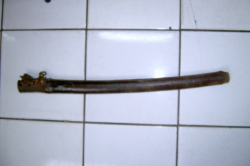

A wooden saya covered with brown leather (if not fake) may have been
a civilian one adapted to military service. If it's laquered other then military
green, most likely it was.
IF not a fake.
Hereunder how the cover should look like.
See also http://127.0.0.1:800/Default/www.h4..../gunto_034.htm
tsubame1 is offline   Reply With Quote
Old 20th March 2007, 08:47 AM   #24
ferrylaki
Posts: 285
IF not a fake.
HI,
it has the saya just like your picture, but in bad condition.
with three clip , the ring and a hanger ( in plain decoration ).
so it is a civilian sword mounted in shingunto way.
thank you very much...
IF not a fake.

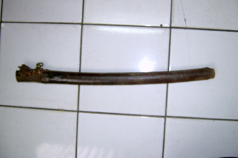

here is the saya, I just got the picture and the saya.
Old 24th March 2007, 04:54 PM   #26
tsubame1
tsubame1's Avatar
Location: Magenta, Northern Italy
Posts: 123
Sorry for late reply Ferrylaki but seems my e-mail doesn't receive
addvise of new posting in subscibed threads. I've to check my profile.
Now chances you've an antique one remounted for WWII purpose are
increased. Likely the assumption "re-mounted, in oblivion and then badly
polished" is the right one. Don't sell the saya (obvious enough..).
Don't make anything more on your own to the blade and tang other then oiling/cleaning it with paper unshented tissues.
Remove the Habaki (collar), keep the blade lightly oiled and OUT of that saya because likely it retain moisture. Mineral oil, not engine one.
Simply wrap the oiled blade in newspapers.
Your climate should be very humid. think about this when you choose the place where to store the blade waiting to find someone knowledgeable enough
to make an "on-hand" appraisal. NihonTo Message Board surely can address
you to someone to have a window polished to have a better
understanding of the period and to evaluate an eventual restoration.
Remember that such restoration will mean a complete polishing, a new plain wood scabbard and handle (shirasaya) and most likely a new Habaki (collar) too. Not a cheap trip, and possibly not economically convenient.
Depends on what sort out from that "window".
Be aware. NihonTo are like vampires. Once you've been beaten you are doomed...
