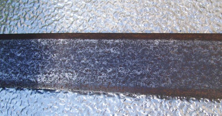

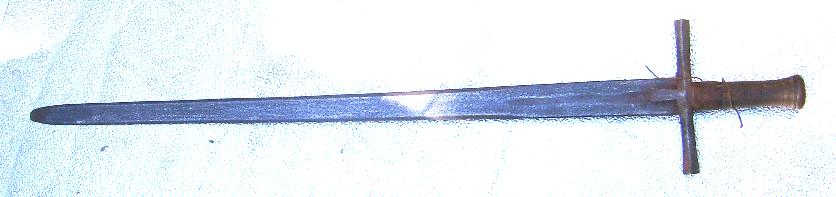

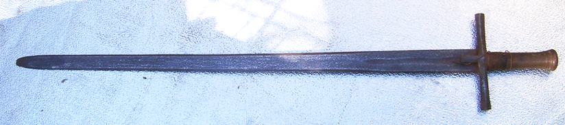

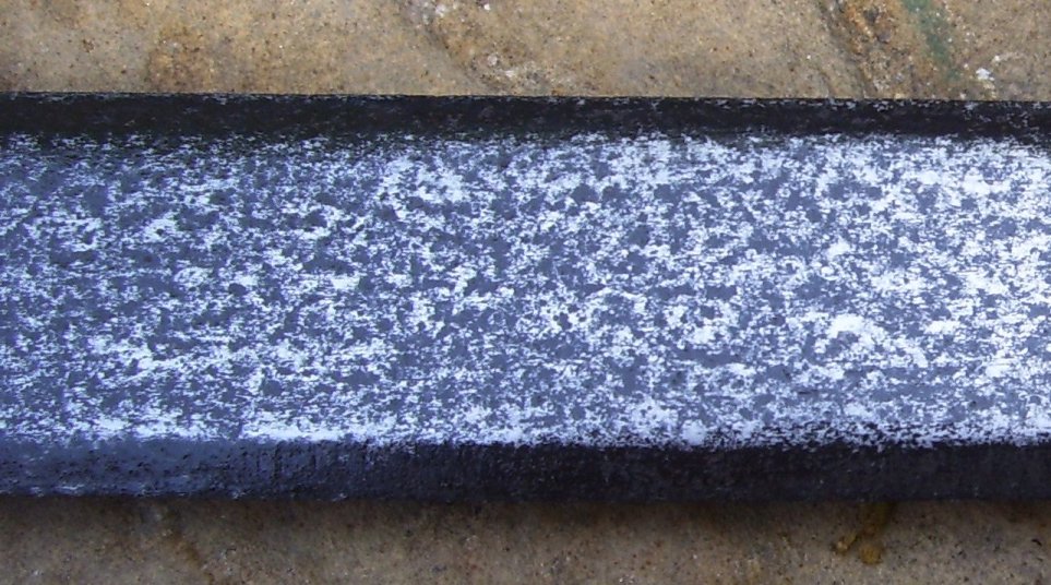

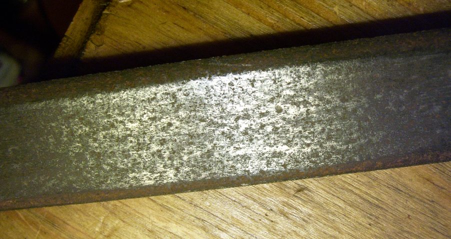

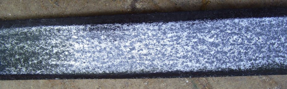

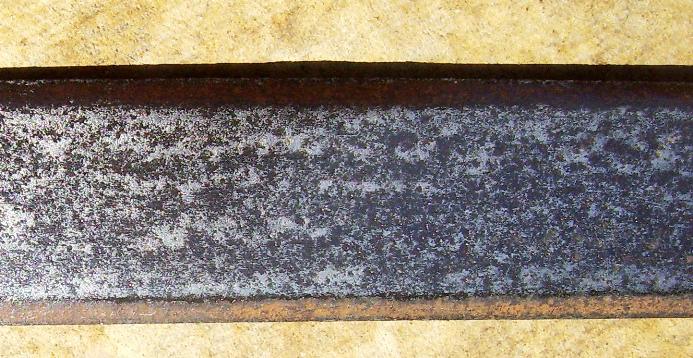

Hi,

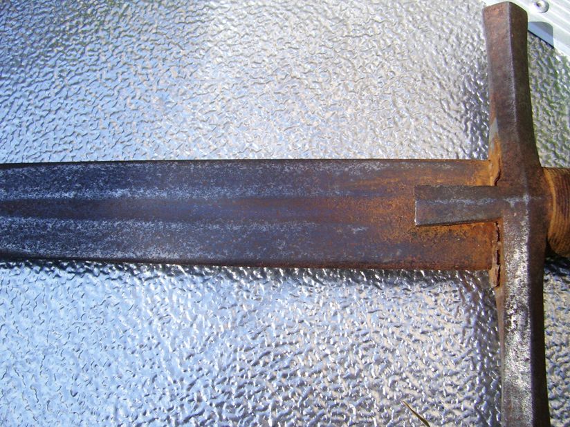

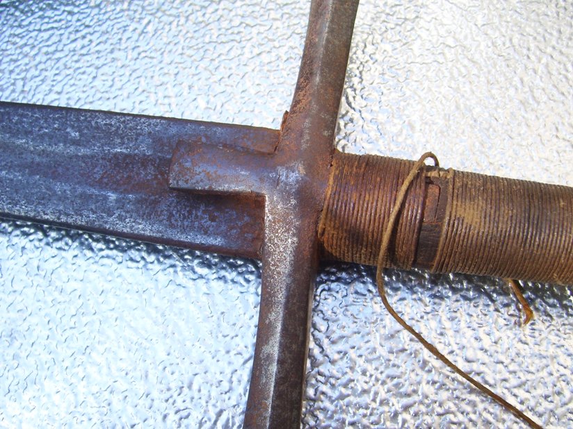

this Kaskara seems to have a very crude wootz-like pattening all over the blade (the pics do not show this clearly). Excellent temper and the edges are still quite sharp even though it was quite rusty. The blade is approx 4.5mm at the forte and the central fullers are forged....rather than ground.
I am not suggesting that this blade is made from some sort of course, wootz billet, but there is 'something' unusual. There is a 'bright' and 'dark' grainy effect as if there are two different grades of steel/iron. I wonder whether it is 'shear steel'. I remember reading somewhere that blades made from 'shear' were considered high quality.....but I cannot find the reference Evidence of re-sharpening of the blade....sometime ago. No markings.

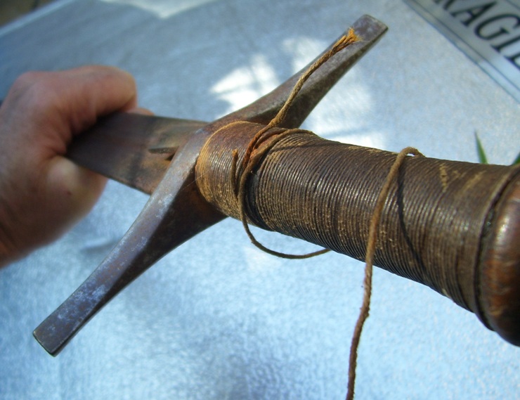

I believe the blade is much older than the hilt (re-hilts are extremely common due to climatic conditions) The cross guard also has age.
Any and all comments gratefully received, thank you.
Regards David

Maybe rub a section of the blade with a little oil and take another closeup ?
Really hard to tell pitting from pattern in the piccys .

Posts: 1,099
I agree that it is very difficult to determine the metalurgical details given how much pitting and patina are on the blade. To make a better guess, you can always polish a window in the blade and etch it to find out. However, given the low probability that it is wootz it might be prohibitive to find out especially if it turns out not to be wootz and then you have a clean window in an otherwise pitted and patina'ed blade.

Thank you all, for your comments, I will try and clean a window and post pictures. As I said before, I am certain this is not a form of wootz ...but helps described the grainy, contrasted effect.
Hi Jim, the blade is not uniformly the same thickness. At the forte it is 4.5mm ...distally tapering to approx 1mm at the tip. It is well made with a good temper...I believe a European trade blade. If this is shear steel ...likely British ? (Sheffield ?) ....or where other European suppliers manufacturing shear steel blades ?

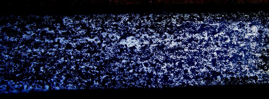

I have decided not to 'create' a window, it would destroy the overall patina of the blade. As a compromise I have lightly sanded an area and oiled it. The darker areas are not pitted rusted areas. One of the pictures has been tweaked with high contrast which shows the overall uniformity of the 'patterning'. You could argue that the patina could be 'creating' the pattern...but to have such a consistent patina (and therefore pattern) over the entire blade....both sides seems strange.
The only other observation that may be relevent .....is the condition of the blade edges. Under magnification the sharp edge is almost 'micro serrated' ...not by design ......but it seems by the structure of the blade. It seems that minute particles (on the edge) have either corroded or worn at a different rate to the rest....almost suggesting that the blade is not homoganised steel
