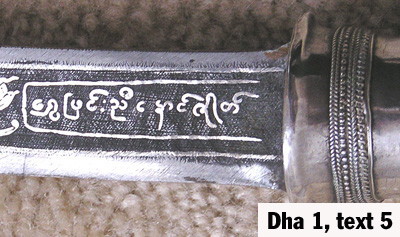

I have three dha with stories on the blade, and I was wondering if any of the texts gives the title/name of the story.

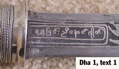

Here is the first one, hopefully not in Pali. I am assuming that the first panels on either side give the name of the story and/or something about the owner or maker. There is more text, but I won't burden you with it (for now ).

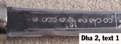

Here is the second. It is a modern, with fairly crude decoration. The same text appears at the forte on both sides of the blade.

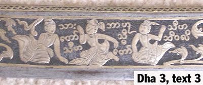

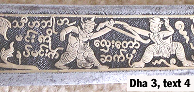

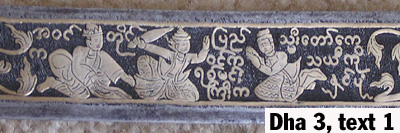

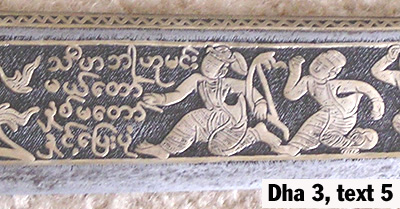

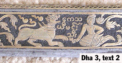

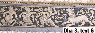

And here is the third. It does not have clear "introductory" panels, so I'm posting all of the text. For now I am only interested in knowing the name of the story being shown, if you can tell from the text.
Thanks in advance!

Dha 1 Text 1 & 5 are identical
Shwe Hpyin Nyi Naung Zat
Play / Tale of the Shwe Hpyin brothers ( they are Shwe Hpyin GYi & Shwe Hpyin Nge AKA The Taung-Byon brothers )
http://www.myanmar.gov.mm/Perspectiv...97/nat8-97.htm
Dha 2 Text 1
Maha Bandoola Zat
Play / Tale of Maha Bandoola
http://www.myanmars.net/myanmar-hist...a-bandoola.htm
Dha 3
The last story involves Thiha Bahu Min ( King ) and a couple of princesses as well as a Nat Min . Sorry don't know the story it refers to
Hope that helps .
