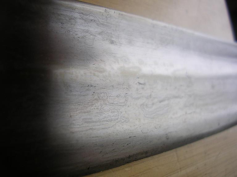

This is the old Tulwar blade, shown in the "mend a blade?' thread.
(Has a crack in the spine)
Should I give it an etch?
Thanks in advance!
Richard.

This is a pattern welded blade and what is showing now is fairly indicitive of what would be brought out or enhanced, a sort of open distorted lamination. I think Jens is fond of this type of pattern. What you will probably see is some lamellar activity along the edge and spine and the central portion of the blade will be the open, distorted lamination like what you see. An etch may accentuate some heat treatment to the blade as well which would show in changes in color tone. The blade seems to be in good enough shape, ie, no pitting or heavy oxidation that it should be fairly easy to etch.

Posts: 1,725
I'd say yes. That looks like a nice, "tight" pattern which should come up nicely, particularly if the features Rick predicts appear. Some pattern-welded Indian blades are rather unattractive when etched but, in my experience, those blades are not as fine looking as your's.

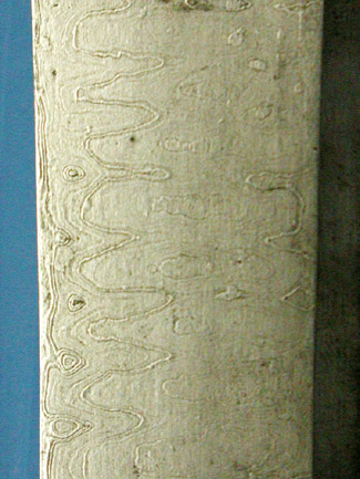

Pattern welded blades can be found in a big variation of patterns. Some of them should not be etched, but others I find very interesting, like the attached.
I would etch it to have a look, should the result not be as hoped for, it can always be removed again.

Jens, Your post popped up whilst I was answering the first two.
That is an amazing pattern on your blade! certainly would have been a shame to leave that one hidden!
Thanks for posting the picture.
