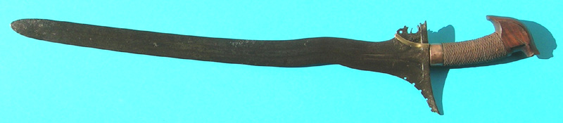

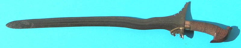

Hi all,
This piece comes from a private Dutch family; The weapon was confiscated by the Japanese during the Sumatra occupation in WWII. I need Your opinion about its origin. Moro or Kalimantan ?

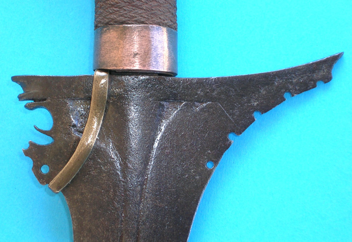

I would lean more toward Kalimantan, especially based on the blade fullers, the "trunk" area, and the chiseling at the base of the blade.

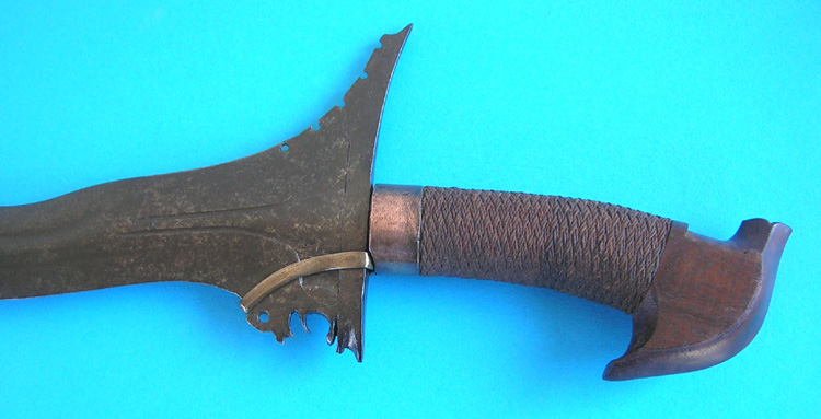

I remember that one - nice catch!
Are there any indications that the elephant's trunk broke off?
Old 21st February 2007, 01:26 AM   #4
Posts: 7,403
You know, Kai, that is a good question - missed that one.

Hi Kai,
To me the elephant's trunk seems intact.

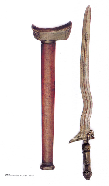

I'haven't Your knowlege about keris, and I didn't read most of the books You mentioned, but on page 16 of the Van Zonneveld book (traditional weapons of the Indonesian archipelago) there's a pic of a Kalimantan keris, acquired in 1893, that looks very interesting to me.
Paolo

Yes, it looks interesting.
AFAIK the swords in the van Z book is attributed according to collection area, not where they were made.
Michael
