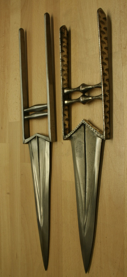

The dotted inscription on both sides of the side guards indicates that the katar at the top has been in the Bikaner armoury. The lower katar is marked with the Kishangarh armoury mark. That the katars are marked with the two armoury marks, means that they have been part of the weapons in the armoury, it does not necessarily mean that they were made there. They can have been, but they can also have been part of a looting, which means that they would have been made somewhere else, but I believe these to to be made where they were marked.

I have noticed that the Bikinar katars have faceted style cross bar grips and side bars that have less flaring at the ends. Is this a consistant trait found on a majority of Bikinar katars?

Many of the katars from Bikaner have a hilt like this one, but not all, they have different hilts and different looking blades, but most of the katars which I have seen from Bikaner looks like the one shown. The same goes for the Kishangarh katar, several looks like this one in the form, but others don’t.

On this picture of the katars it is with both parallel rather than upper and lower. Which one is which in this picture?

After the text was done, I tried to put the picture in, but it was too big, so I had to turn it, and forgot to change the text – sorry. The Bikaner katar is the one to the left, and it sounds like a tuning fork, for a long time, when hit on wood.
