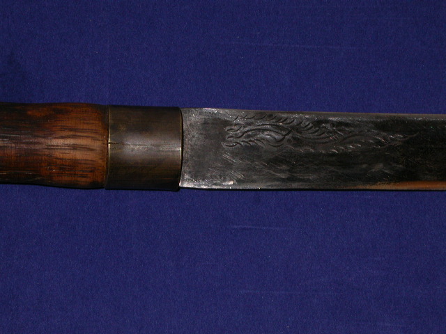

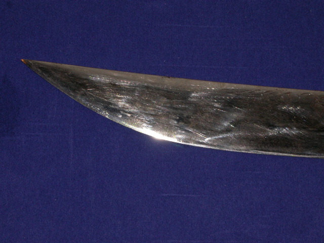

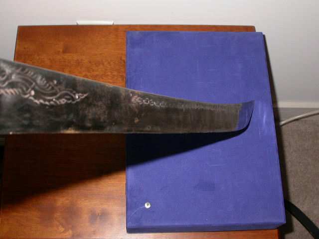

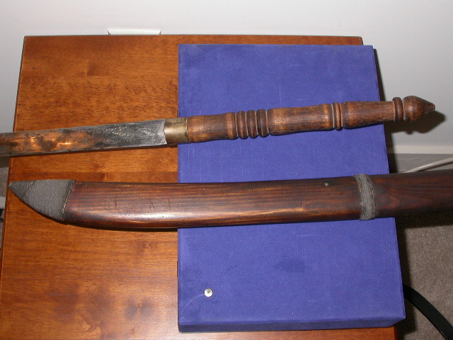

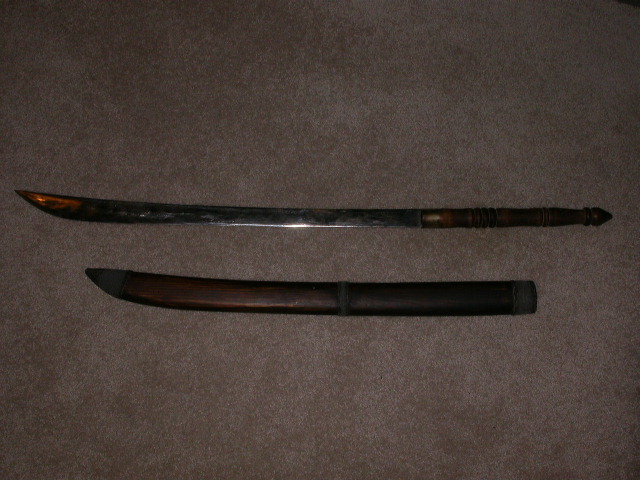

Hey guys! I came on this website a while back to find out some info on my newly purchased Thai Dha. (see attached)
Basically found out from the pro's that this piece is probably a high quality Aranyik piece, most likely functional, complete with a rare teak scabbard and quality metal blade w/ etchings. Is the blade for sure steel?
Either way, I am looking into cleaning up and refinishing the blade. Are there any cleaning techniques or cleaning products that will help remove the oxidation and small rust deposits??? I have used a few metal cleaners & polishes; they have done a decent job, but I am looking to get rid of the tough grit off without damaging or scratching the metal. Please help!

I tend to only clean active red rust off of mine and leave any patina. A cloth and light oil or WD 40 if there is no koftgari, if more is needed a very fine steel wool which is actually a soft iron and will be much softer than the steel in the blade
