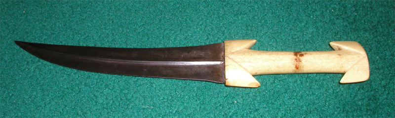

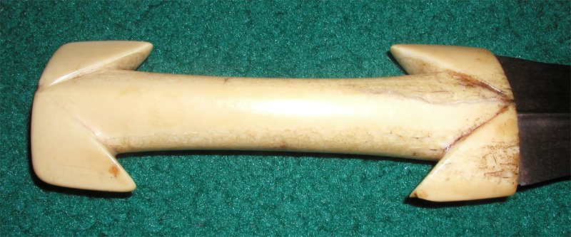

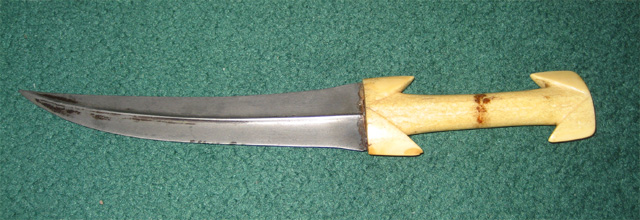

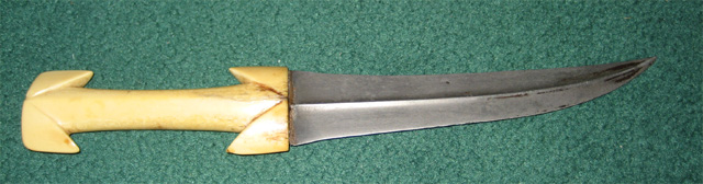

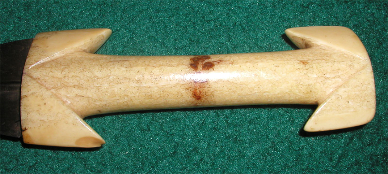

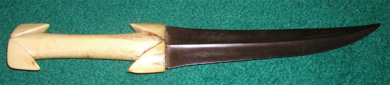

Hello All!
I recently bought this nice Albanian Jambiya at a local gun/knife show. I wanted one of these for a while and is now my favorite pice in my collection! It is good quality with a nice walrus ivory hilt and good blade. I was told by the person I bought it from said it might be watered steel but it is too darkend by age to tell. Should I clean it up and see if it is watered steel? How would I go about doing that? It is about 14" overall with a 8 1/2" blade and a 5" hilt. It had a small crack in one side of the hilt that I needed to repair with glue but other than that it is very sturdy with no loosness in the blade and the hilt is in good condition exept for the already mentioned crack. I think it is probaly 19th century, could anyone pin it down a little better? All comments are welcome!
Mark...

Nice jambiya Mark, congratulations. I think you should deffinitely check the blade. First you need to clean it, then wash it in warm water, dry with a towel and etch it. Vinegar diluted in hot water has worked for me. After you have etched it to a satisfying result, wash again with soap (to neutralize the acid, this is important), and then dry again with a towel and do not apply any oil.
You may want to search the forum for older threads on how to go about this, and I am sure you will get plenty of other opinions here too.

Beautifull thing... A most typical example of albanian jambiya. Gorgeus marine ivory hilt and probably a damascus blade. If you intend to sell it search no further, just contact me. )

I have grown to llike Albanian jambiya like this. I think the blade will come out wonderfully and I would not be surprised that it is wootz. Blade looks complete, not cut down. Congrats!

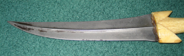

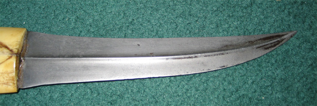

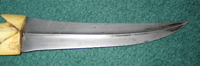

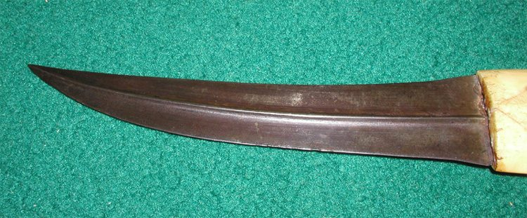

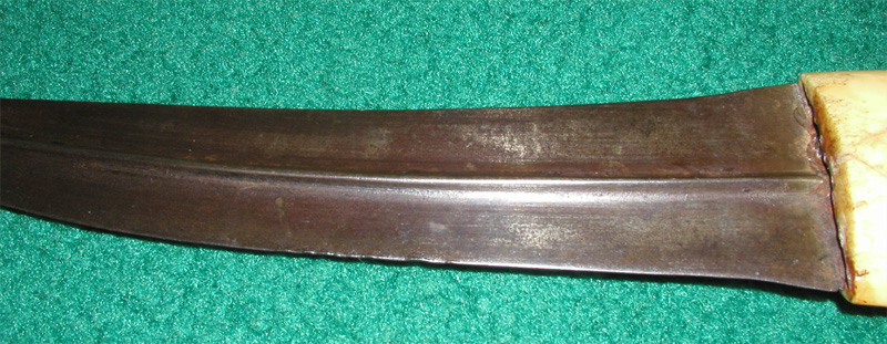

Here are the picture of the blade a pttern is there but it only came out slightly. Are these jambiya's found only in Albania or are thary also found in areas like Kosovo and Montenegro? Help Please!
