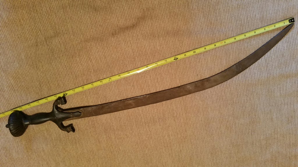

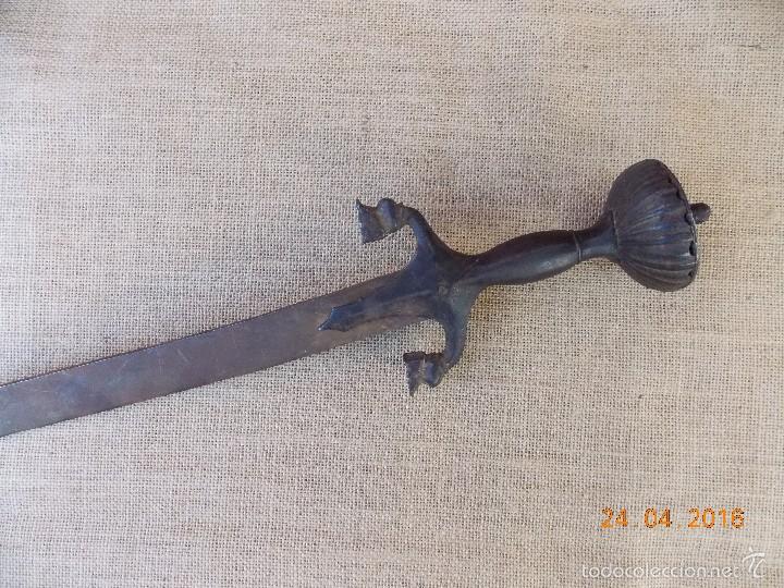

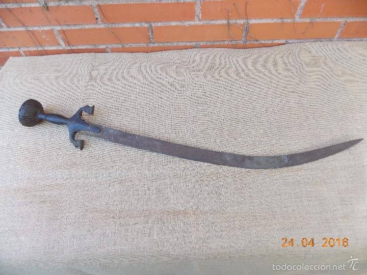

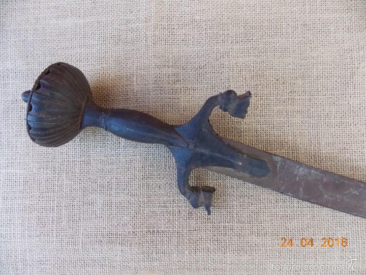

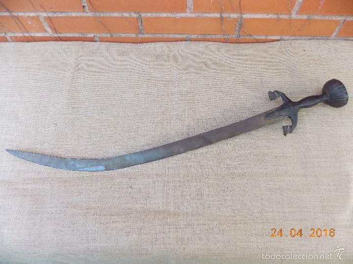

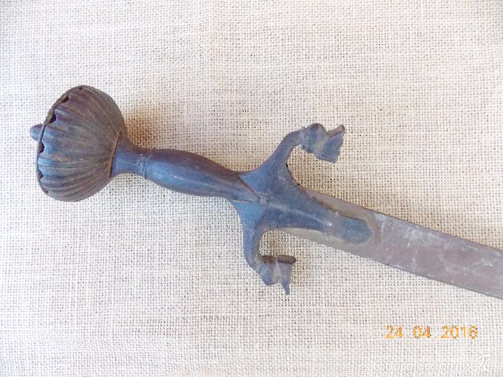

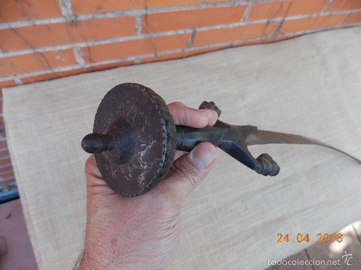

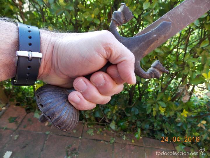

I just adquire this sword. The pictures are from seller, I hope received soon, I don,t know nothing about origin of the piece.
Could you help me? Age? real or tourist weapon?
Thanks in advance

I like these. Beautiful, practical swords. While these photos are not enough, I think the blade is crude with an odd curve that follows the Persian style. Spine in one of the pictures looks slim but more photos would be better.

Judging by the photos , a good pulvar . I think - the second half of the 19th century . Blade - Shamshir . Probaly wootz.

I agree with Alnakkas. The blade looks very thin and has a Turkish tilt to the curve. I don't think you will find wootz under the oxidation.

Agree with Lotfy and Ian.
First thing you may do is cleaning the blade: a lot of oil and steel wool. Then maybe polish an area and etch it. Be careful not to remove any markings hiding under the rust layer.
I am also not sure how thin the blade is: can you measure it close to the hilt? Usually, Afghani pulwar blades are pretty massive and often have rather elaborate fullers.
Will be interesting to see it after gentle restoration.

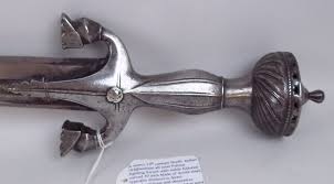

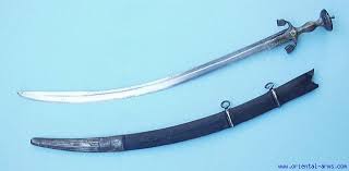

Maybe this helps a bit.

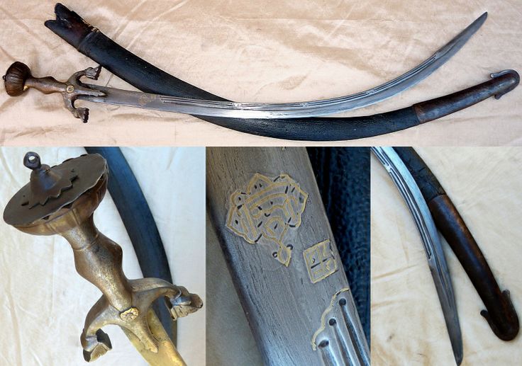

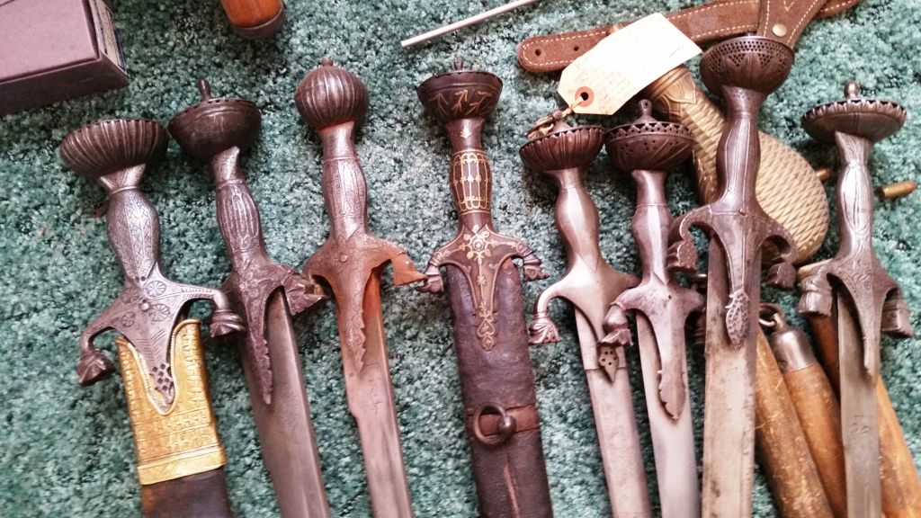

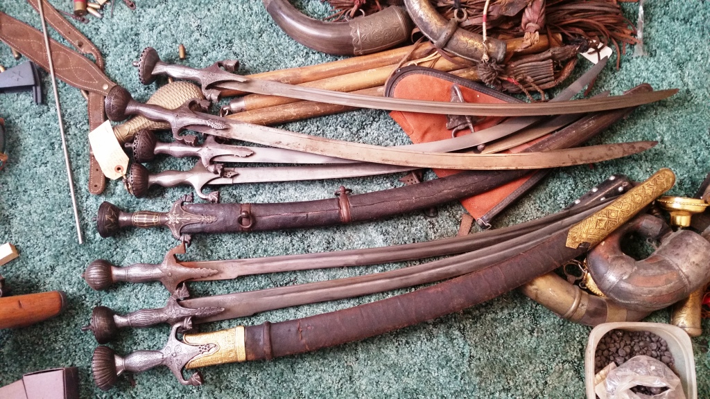

I have a few photos of examples to place...and hope you may all comment ..

The sword in the original post has either an unusually large pommel, or an unusually slim grip.
Nothing wrong with that, just slightly different!
Bit concerned about the blade shape and thickness though.
We will know more when Carlos has it in hand.

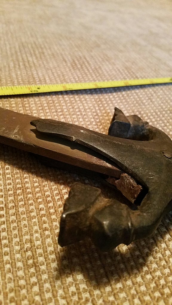

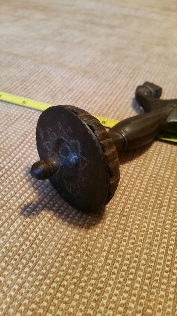

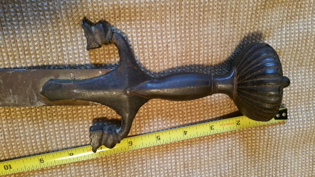

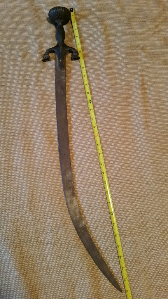

I have received sword my first impression is handle is older than blade. And blade is shorter than other pulwar I have seen.

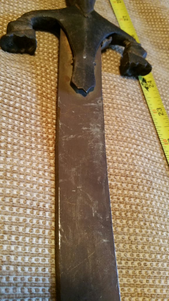

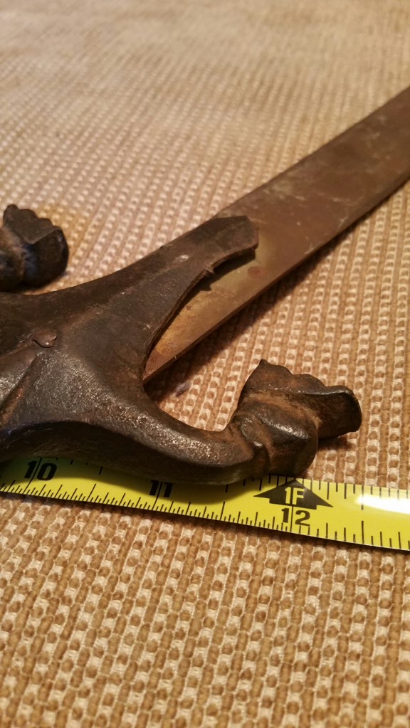

I think the blade is new, even though we can't see how thick it is.
Afghani sword as an overwhelming rule had their blades decorated in some fashion, at the very least they had fullers.
Most suspiciously, the rust on the blade is reddish and there is no rust under the langet, the most difficult place to clean.
Also, I have an impression that the blade is not sharpened. Am I wrong?
Sorry to say it, but if possible, I would have returned it to the seller.

To me, the blade looks suspiciosly flat. Also from the photos appears to have some strange bends/irregularities. Maybe I am paranoid, but it looks like crudely forged from band steel. Like the band steel was bent to give it the shamshir shape... and the bending wasn't very successful.

I tend to agree with the above posts.
The resin looks a bit suspect as well.
Nice old hilt though. :-)

sadly I have to agree, the blade look more as doubtful to my eyes. Could you post better pictures from it?
