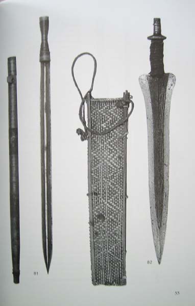

Freddy, sorry for the delay!!!! I had forgotten this thread . Anyway here we go: here is the picture of the sword with its scabbard. It's taken from the book "LAME D'AFRICA - M. Piccardi, L. Salvatici" tribe: topoke.
