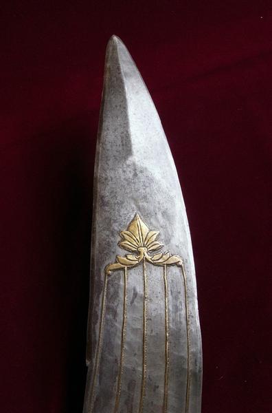

Indian Sword. 38" long overall and 3 3/4" wide.

My intuitive feeling is that Indian swords with profuse brass inlays are more likely to be tourist grade, aimed at dazzling the unsuspecting Westerners... Please surprise me !

Hi Ariel,
Usually I would agree. First, this is a substantial sword. Has a sharp edge, not razor sharp, but enough to cut with the weight of this piece behind it.
Also take a look here.
http://www.oriental-arms.com/item.php?id=2194
Not a definitive answer, but a good indication.

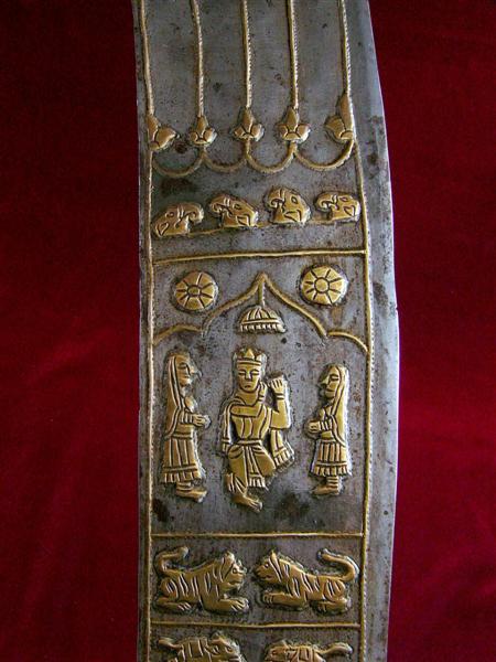

Hi Bill, nice sword!
"Sacrificial" comes to mind
I wonder why the executioner is wearing all those spikes and carrying a shield when his job is decapitating a (presumably) tied victim. Must be an interesting story there.

Thanks Emanuel,
He should not need protection against a tied victim, however there is always a question of a spiritual attack from the dead. Quite a concern, actually, especially if you were the one sending him on his journey!
I don't think that he is necessarily dressed for combat in a usual sense. For one thing he is barefoot which could indicate a desire for a good connection and grounding with the earth rather than protection from the physical weapons.
I do like the armor, but the spikes would be of marginal value against swords, spears, arrows, etc. But it might. if properly consecrated, keep a spirit away, at least in their belief system.
It is very difficult to even get a marginal understand another culture's symbolism unless you can dig deeply into their religion and psyche. Even then true understanding will likely escape you.

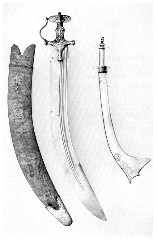

The Tegha on the picture is from Leth, André: Islamic Arms and Armour from private Danish Collections. Davids Samling. Copenhagen 1982. No 174, page 208 and 209. Weight 3.2 kg without scabbard, length scabbard incl. 101 cm, and width of blade at the base 8.3 cm.

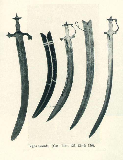

In ‘A Catalogue of Arms and Armour in the State Museum, Hyderabad, A.P., 1975’, they write that they have five Teghas, and they show a (bad) picture of three of them. I find it strange that they only have five, as the museum is in the area, where Egerton writes they were used, so I would have expected a lot more – but five it is.
#123, hilt 18 cm, blade 67 cm, 18th century. #124, hilt 18 cm, blade 84 cm, 18th century. #125, hilt 16 cm, blade 70 cm, 19th century. #126, hilt 23 cm, blade 85 cm, 19th century. #127, hilt 19 cm, blade 81 cm, 19th century.
What Bill is showing can very well be a Tegha, but there seem to be a lot of other sword types which are called Tegha as well.

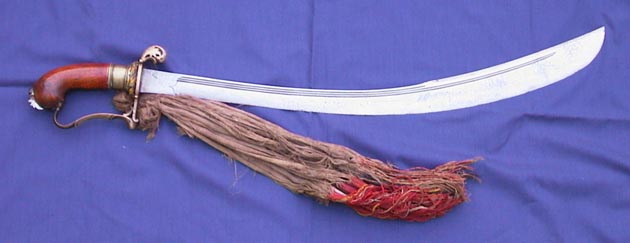

I know what you have here, and yet the blade shape reminds me of another sword from far-away China.
Oxtail saber (niuweidao). Qing Dynasty. Commonly known today as " the Chinese Broadsword."
Many of these niuweidao were for the relatively unskilled bloke as a "chopper."
My pictures show an above average sword. Most were cheaply made and mass produced.
