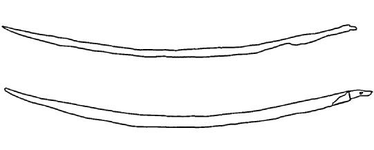

Technical question - how large should be the sabre's curvature for us to consider it a shamshir ? I am trying to arrange my material on sabres, and come to some funny conclusions.
All books I have follow Pletneva in measuring the curvature in cm (how far away the blade from the line that connects the hilt and the blade's end).
Can someone say if 15cm for a meter or so blade would qualify for a shamshir ?

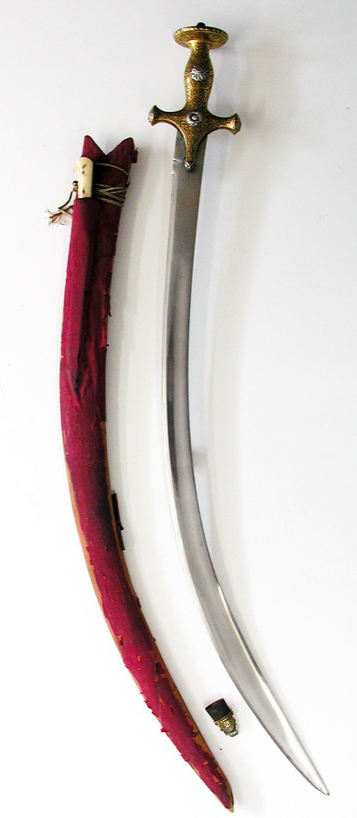

Then tell me, what is this?
Is it a tullwar or is it a shamshir?

Well in kukri we also run across this western need for single word pigion holing & naming labels,
But as always a rose by any other name would smell as sweet,
As long as we have the ability to use a sentace rather than one word to describe a weapon or tool I think thats the option I generaly prefer.
So many of them are highly individual & would escape round any exact catergerisations we imagined the label should match & Photos always help for clarity of discusian to of course!
Thats a nice heavily curved shamshir or perhaps more killj type blade with a lovely & ornate tulwar grip & typical Indian riccaso you have there Jens.
