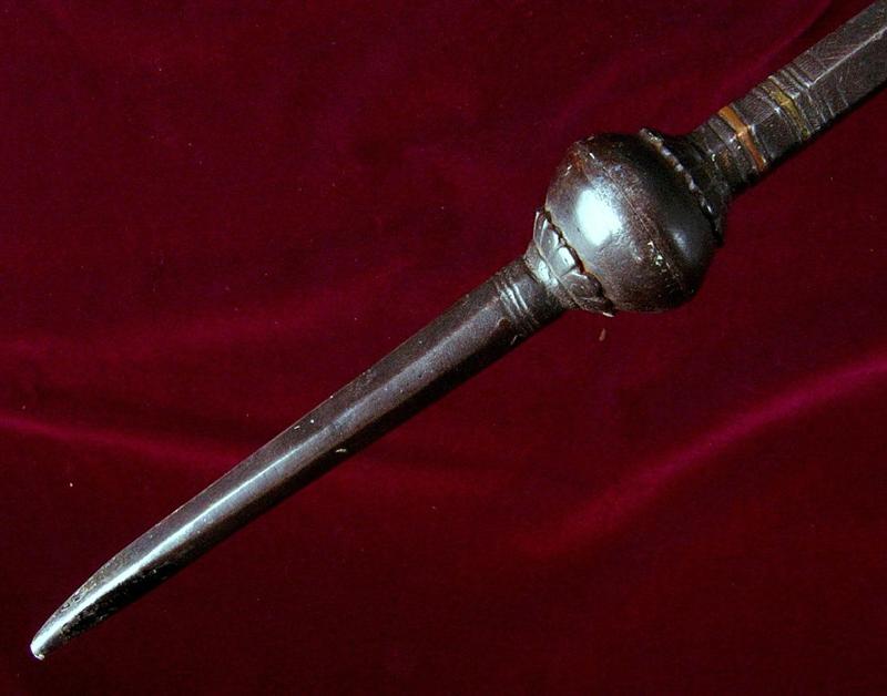

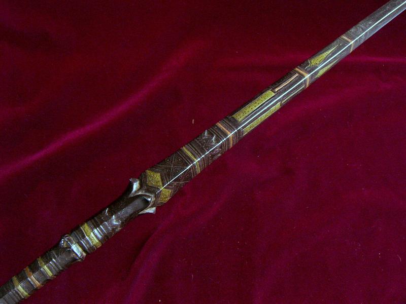

From the estate of a former employee of the Metropolitan Opera House in New York City in the 1920s. It was commonplace to use original artifacts during plays; as this piece was used.

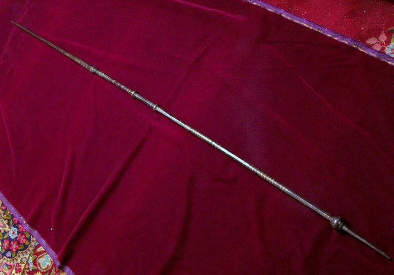

Spear is 75.5 inches long and about 1.5 inches at the ball near the butt. The head is about 26 inches long and is four sided. The shaft above the handle, the handle itself and below the handle is six sided. Then it alternates with round and six-sided to the ball at the butt. It is solid steel.
I suspect it is a version of a Sang or Sangu from central or south India. Possibly Rajput horse/camel spear.
Any information anyone can offer is requested.

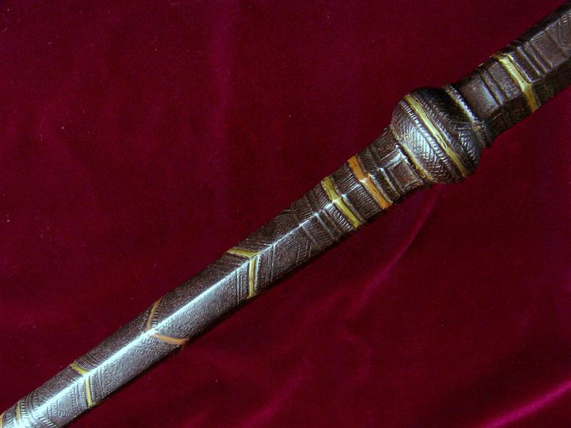

What an interesting piece!...I would agree with Bill...Central or South Indian, and yes call it a sang if you like. Isn't the decoration strange though, similar to decoration seen on good Algerian Flyssa Swords.

I know nothing of the weapons of India but this is absolutely beautiful! How do you keep finding these wonderful items? One thing though, this looks more like a javelin than any spear that I've seen. What is the weight?

Bill, looks like it is Indian, or Indo-Persian-Afghani. Very nice.

Beautiful example. I used to have one and sold it. I am betting this one is heavy, nicely balanced, and that its point and velocity would make short work of most shields and armour.

What a glorious thing. I love the decoration. Compere with this one. I think the African look becomes more clear.

I will bet my last £ that this is also African. The brass and copper inlay along with the engraving is African. West African sahara type of work. I must say that to my mind this is a superb and not common item. Beautiful.
