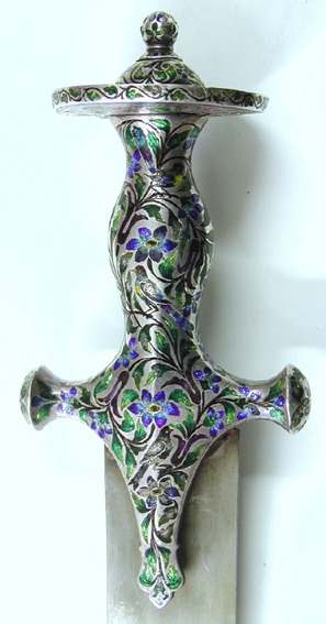

How old do you think this hilt is, and from where in India do you think it origins?
Its is silver with enamel, and as you can see the enamel is very fine, but before you answer watch the colours.
I am not quite sure myself, but I would like to hear other oppinions.

I will have a stab at it; Deccan Plateau, Hyderabad? No idea about the age could be brand new. Go on put us out of our misery.

the colours in enammelling has been studied but i have yet to read anything convincing, or anyone that is willing to commit past jaipur or lucknow.
the colours within your hilt seem lucknow to me, but i have never really looked deeply into the subject.
manuel keene wrote an interesting article called 'the enamel road, from siena,paris,london and lisbon leads to lucknow' which attempts to route the history of this style back through european sources. he does cote other places with similar colours, including tim's hyderabad offer.
i must guiltily admit i have only skimmed through the article, but did note that he puts a question mark after his regions, and also uses the 'mughal/deccan' description which is a little vague for an apparantely in-depth article. he also included the 'hyderabad' enammelled archers rings in the al-sabah collection. i have never believed these authentic and the insertion of them in his article put me off reading much further. its also interesting to note that the article itself was in a book that was partly sponsored by al-sabah!!
so, i should read the article and offer more, but i know you have it as well so shall continue to lazilly state 'lucknow' but remain open to other theories.
the hilt itself offers little clues, as the shape was widely used in both the deccan and the mughal north. i would happily give it a late 18thC date, but refuse to back it up academically (i'm just a collector, i dont need to!)
you obviously have an opinion, mr nordlunde, so come clean

It is most likely 19th century, but I think you are wrong when you say Deccan, Hyderabad. I think it is more likely Rajasthan/Mewar, due to the colours the different districts were specializing in, mentioned in Jacob and Hendley’s book ‘Jeypore Enamels’, and due to the fact that the finest centres for enamel lay to the north.
There are a few interesting things about this hilt. Mostly when you see a tulwar hilt it has the same decoration all over, but not this one, as the hilt, the top of the disc and the dome have the same decorations and colours, but under the disc the decoration and the colours are quite different, here it is clearly a water plant, single petal lotus’s most likely, with butterflies. I have often wondered when I saw a different decoration on the underside of the disc. Why was it made differently, so only the owner could see it, and then only when he turned the tulwar upside down? It must have been more expensive due to the bigger number of colours, as it would have to go more time into the oven for the melting process, so it must have had a special meaning to the owner. You now and again see the same change in decoration on hilts decorated in koft gari.
Hi Brian,
Another thing, which makes me say north India, is the transparency and the way the colours are fating, this was very difficult to make, and I think it was only made in the north. For a long time the enamellers could not make the past themselves, so they got it from Lucknow – but it was the furnace job which made the difference.

Beautiful work. I do not know anything about the colours or enameling centers. I was just guessing on the form of the decoration which is very different from the Northern/Kashmir enameled kard you post for discussion some time ago. Wonderful condition on the handle anyway.

am happy to defer to your theories, especially the date on seeing the pommel underside. i know the sword of course, but have a bad memory :-)
hendleys book is great (all of them, but the jeypore enamels that you refer to especially) but like egerton, he must be taken cautiosly. both he and egerton spent much time in india, studying a subject they were both obviously very passionate about, but neither spent much time in the south. also, both studied mainly the arts of the time, of course delving into the past where applicable. the south was never studied properly and only recently have many theories of the past been brough to task.
still, in saying that i am still happy to defer to your opinion, but would like to know where the rajesthan colours information came from (was this hendley?)

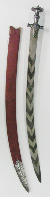

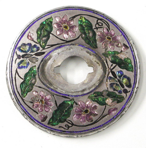

There is one more thing I should mention about the hilt, and that is that the dome can be removed and underneath it are two initials and a name written in the roman alphabet, it says “Made by V. J. & . Nathdwara”. Who or what V. J. is, is unknown, Nathdwara is an Indian surname and the name of an old town in Rajasthan about 100 km south of Jodhpur.

One other thing, the blade has an armoury mark at the back - the mark (meaning K/Ka/Kha) and the number 33.

do you fee that there is a remote chance the pommel saucer was decorated by either another hand or at another date?
only you can tell as this can never be seen in a photo. just asking because i find the difference in style (compared to the rest of the hilt) confusing.

It is hard to say if it decorated at another date, my knowledge about enamel is too fundamental to be able to tell. I would, however not think so. I think the decoration on the hilt and disc must have been made at the same time. When did you ever see a hilt and the top of the disc decorated – with a blank underside of the disc, ready to be decorated? Had they done it like that, there must be a few hilts still not decorated at the underside.
The two names are a puzzle, and it could be, that V. J. decorated the hilt and the top of the disc, whilst Nathdwara decorated the underside. This is a possibility, as I don’t think the same man did both decorations – although you can never know, as some artists can draw/decorate in different styles – but the decorations are very different, besides from the colours. Another possibility could be that one of the names is of the one who made the cutting in the silver and the other name of the one who made the enamel – only this would mean, that the same man made all the decorations. I have a feeling that the good Indian artists could decorate in many different ways – but I have yet to prove it.

Hi Jim, thank you for your answer. The Sanskrit letter on the back of the blade stands for Kha, Ka or K. The reason why I think it could come from an armoury is, that I have seen another blade with the same mark but with number 67 on it, and I doubt that a weapon smith would have numbered the blades he made.
The enamel work as such is fascinating, when you imagine the crude tools they had, the furnaces they used, and the fantastic work they made. The fact that many could not make the past they used, and had to buy it from Luchnow, without getting the same results must be due to the heating – or maybe to what they used for heating, so maybe the smoke could make a difference how the colours showed in the end.
The underside of the disc is a puzzle, and although I am no specialist I don’t think it has been made by the same one who made the rest, not only due to the colours, but I think the whole design looks different. But why was this very nice, but different, decoration ‘hidden’ under the disc, a place where no one but the owner would see it?

It seems as if the enamel hilted tulwar is not the only one marked with a KA and a number. I have seen another one marked in the same way, but here the number is 76. The hilt is slim, diamond shaped, and with a hand guard. Decorated in a thick gold koft gari floral decoration. The blade is watered on one side with one big fuller, but on the other side it is plain steel with two narrow fullers.
The number ‘3’ is interesting. It took me some time before I realised, that the numbers used in Sanskrit, Gujarati, Kutch and Devanagri, although many of them look alike, some differs a little. In only one of the four numerals the no ‘3’ looks like the one on the blade shown in an earlier post, and in Kutch, and only in Kutch, there is a little stroke under the number. The text on the disc has been discussed in other posts, but it is interesting to note, that towns Nathdwara and Udaipur are only about 400 km away from Bhuj, the capital of Kutch. Udaipur was known for its fine enamel work, and as Nathdwara is only about 60 km away from Udaipur, there is a possibility that the hilt was made in Nathdwara.
But back to the second tulwar I described. The number ‘6’ in Kutchi looks like the number ‘3’ on the blade turned vertically, also with a small stroke under, but the numerals used, when using the three other languages, number ‘6’ looks differently, but no ‘7’ looks alike in all four languages. This means that the enamelled tulwar and the one described must have come from the same armoury in Kutch. If they were made there is an open question, but to my opinion they must have come from the same place.
There is one other language where the no ‘3’ and ‘7’ looks like the one used in Kutch, and that is in Nepalese, but I think we can rule Nepal out.
