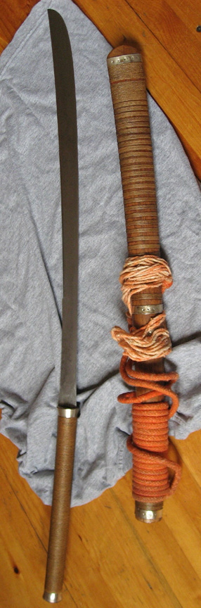

I recently moved and I'm concerned that the air is dry now that the furnace is on at the new place. Some rattan rings on the handle of one of my Dhas have come loose. Not too bad yet but the season is young. I was going to coat the hilt in mineral oil to give it some moisture. Will this work? Does anyone have any other suggestions? The environment here is very dry in the winter and humid in the summer.
By the way the Dha is one of my favs. Not the fanciest dress but REALLY nice in the hand. I'd say the blade is older than the hilt but it was definitely fitted to be used. I've always guessed that it was re-fitted about 60 years (or so) ago around WWII.
Thanks for any advice,
Shawn

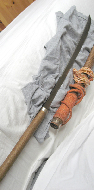

Here's some (bad pics)

Hi Tim. I have a few tourist pieces as well. There are certainly wide ranges and grades of quality. This one is all business though. I don't know if you can see top of the blade on my (low grade) photo but it is flat and very chunky with some file markings then a raised spine on the front 3/4's. And I know you can't see the hamon mark along its cutting edge. If so, there are some very well armed tourists out there.
