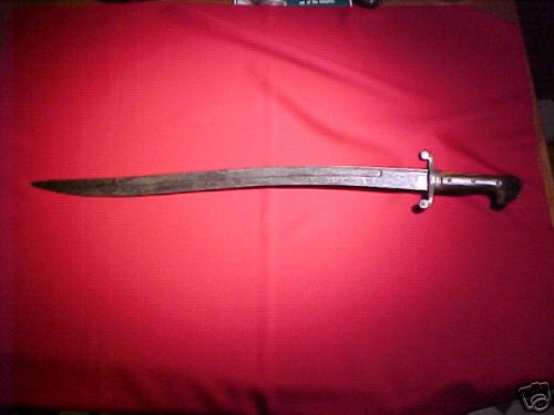

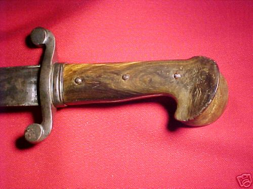

I wanted to bid on this yataghan but the seller ended the listing early: http://cgi.ebay.ca/ws/eBayISAPI.dll?...0447&rd=1&rd=1
It has a yataghan hilt, some sort of European cross-guard and a yataghan blade with a fuller that makes it look like the French Chassepot bayonet. Any ideas as to its origin?

Looks like a rehilted bayonet.

Hi Manolo:
I agree with Rick -- probably a rehilted bayonet.
When I saw your sword my first thought was the British P1856/1858 bayonet with the "button" finials on the guard. Although close, your blade has a T-spine, the fuller on your blade is wrong, and your sword seems to have a wider and less tapering blade than the British P1856 bayonet.

Rick, Ian, I thank you both.
You confirm my thoughts of a bayonet. I was unaware of the British patterns however, and only knew the French ones . It seems many countries adopted this yataghan-type blade.
Thanks for the link Ian, it's quite helpful...I'll start my own research into these bayonets as well, they're damn beautiful I think.
Now why would anyone rehilt these in yataghan fashion? Was this a common practice at some point, or is it just to deceive unweary buyers?
Emanuel

It is probably not a rehilted bayonet (another over-attributed source) but an original European sword made with a similar blade; even if identical to a bayonet blade, such variations were quite common as new goods, and are often seen amongs European cutlery. Such items were produced for military and civilian/private-issue markets. It appears to be Eastern/central European; I'd suggest Austria were it not for the highly developed ears. If we've never seen this individual before, I remember having simialr comments on something a LOT like it; one could do a search; something may have been discovered in that discussion; my library computer time is running short..............

Yes, old bayonets are rehilted (believe me, I know; I do it), but that is not reason to leap instantly to such conclusion for any dagger or sword with a blade similar, or even identical, to a certain bayonet, as there is the other thing and it still goes on, even (check a US cutler named Ontario and their spec plus knives). On another note, the original sword has a cross-section like no bayonet I've seen; certainly not like the one seen here. The blade is T-section AND has an additional fuller; the Chassepot and other similar bayonets (including interestingly some Turkish ones) has IMITATED a raised/applied-spine and a reinforced edge with a flat-bottomed fuller; they have only one groove; not the more complex situation seen here. I don't think this is even a blade that was ALSO used for bayonets; it's just a sword, IMHO; no sign of anything else.
BTW, I love the ferule, which obviates the need for a rivet holding down the bottom tip of the scales, the hole for which weakens so many blades (though this one still has a rivet closer than neccessary to the guard). This practice seems to have gone extinct(?).

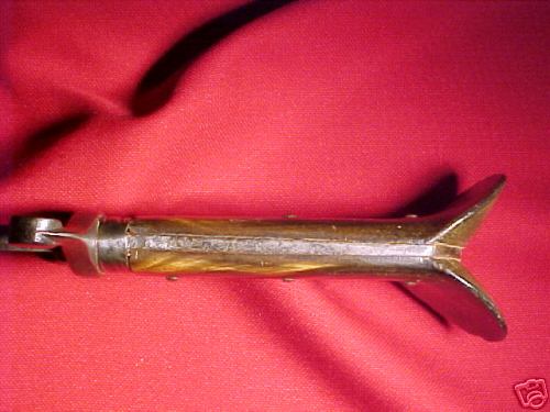

Now how about this one:
http://cgi.ebay.com/ws/eBayISAPI.dll...MEWA:IT&ih=019
I do not like it, but this is beside the point. I do not think this was ever a bayonet.

This last one is indeed ugly! It looks like a very badly bent bayonet to me. Look at this thread http://www.vikingsword.com/vb/showth...black+yataghan
The comments suggested a Turkish bayonet being altered to resemble the Laz Bicagi...perhaps that's the case in the above auction.
