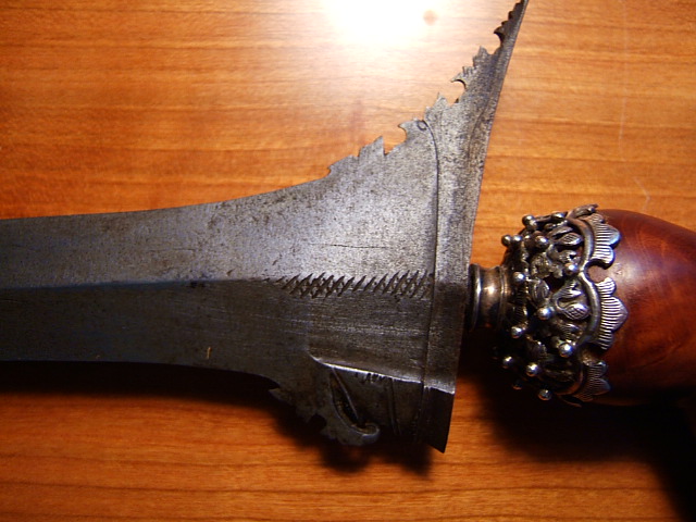

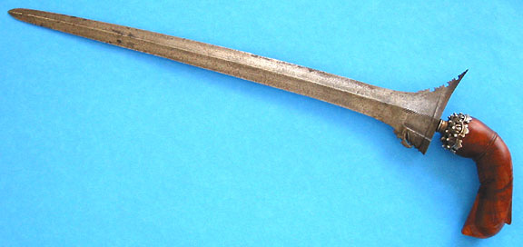

Hi All
I picked this keris up 4 or 5 yrs ago and thought it needed a revisiting
Lew

Lew,
Interesting blade. Looks like it's made from a file.
However, the blade is nicely shaped in the Northern Malaysia / Patani style.

One theory is that the marks were made from a vise?
Interesting theory. Possible, but unlikely. Unless it is done before the ganja is inserted into the pesi (tang). The 'criss-cross' marks are only visible at the thickest section of the blade, which is about the thickness of a thick file. The 'kriss-cross' portion near the gandik, is less visible possibly due to the filework done while shaping the gandik area.

If you look at the left side you will notice the marks appear at a high point just to the right of the Kembang kacang or Belalai Gajah. Do you think this was purposely done to provide a perch or a guide for proper for gripping the keris?

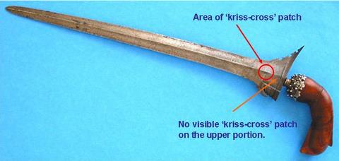

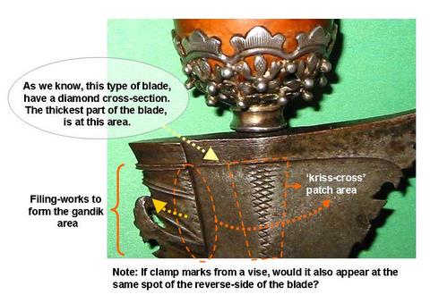

Lew,
Attached are your pictures with some illustrations to aid in our discussion.
(I hope you don't mind). Just to clear some doubts I'm having.
If you don't mind, could you post a picture from the top of the cross-section, with the hilt and hilt cup removed? By the way, what is the thickness at the
thickest part of the blade?

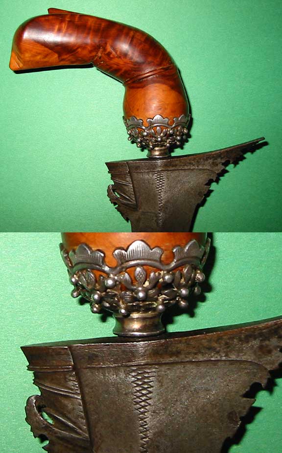

closeups of both sides. Sorry Kai the hilt is on pretty tight so I am not going to chance damaging it by trying to remove it at this time.
Lew

Lew,
Thanks for the clearer picture.
The blade's diamond cross-section should extend all the way to the base of the blade. In this example, it seems that the thickness is not enough to form the base properly, which is approximately 1/2" or 1.5cm (it does vary).
This is how the base should look like for this type of blade.
(Example, courtesy of BluErf's gallery. )
http://www.kampungnet.com.sg/modules...view_photo.php
From the first picture, there seems to be no sign of a temper.
Example of a 'visible' tempered blade, (courtesy of BluErf's). A two-toned finish.
Kind Regards,
Shahrial

I took the blade out is some good light and there is a dark line an 1/8 th of an inch wide running down the the length of the blade's edge so this is similar to san mai sorry but I can only see this when the blade is at a certain angle it will be very hard to capture it in a photo. So if this is san mai the use of a file as an outer skin is unlikely files were fully hardened in the 19th and early 20th century so I still think this was squished in a vise at some time. Btw where the diamond cross section ends is higher and thicker than where you see the cross hatch marks so I think that kills the file not being thick enough theory. So vise marks is now the most likely culprit

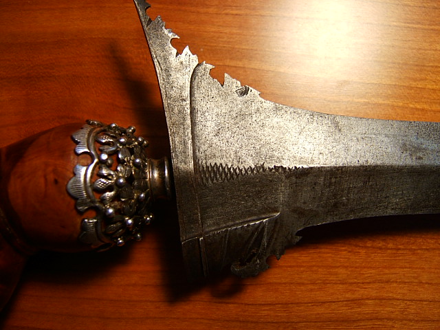

If those marks are from a vise jaw then the entire surface of them should be flat. Those marks appear to me to be incised. The only only type of vise jaw that could have made those marks are a vice jaw made from a file.

The area where you see the marks is flattened thats why I think it was done by a vise.

May I suggest that you look at this pattern under magnification, Lew.
There are criss-cross lines with a diamond between.
If the lines are impressed and the diamond higher than the lines, I think we are looking at a file.
If the diamond is impressed and the lines are higher than the diamond, I think we are looking at a vise imprint.
Have a look at the jaws on a metalworking vise and you'll see what I mean.
Regarding the different colour and texture of the edges.
A keris blade is not normally tempered. It is taken to critical, and then quenched to harden it. The tempering that reduces the hardness of a blade to minimise risk of fracture is not normally done with a keris blade.
However, there is another way to minimise risk of fracture, and that is to ensure that only the point and the edges go to critical, whilst the center of the blade stays below critical. This is not such a big trick to do, if you harden by passing the blade through a live flame, and quench as soon as the edges get to critical, which of course is going to happen a lot sooner than the center getting to critical, because the edges and point are thinner.The result is that only the edges have undergone the structural change that makes steel hard, and only those edges are going show the characteristic darkness, and long term erosion associated with hardened steel.
Result:- hard edges, softer center; a similar result to what would have been achieved if one had drawn.
I think Alan explained my comment above better than me.
I believe I'm seeing the diamonds being higher, i. e. a file...
