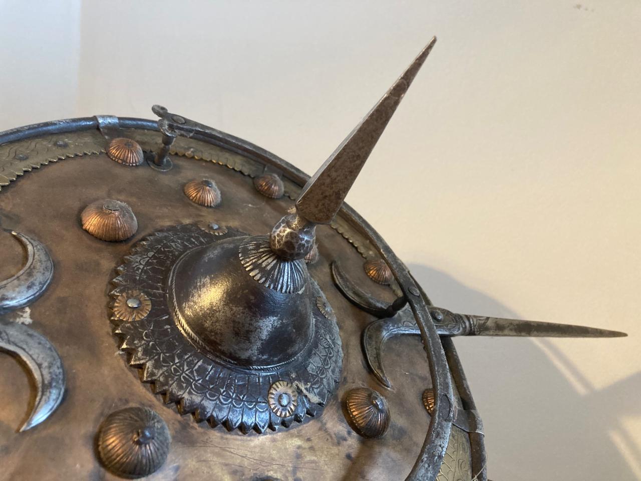

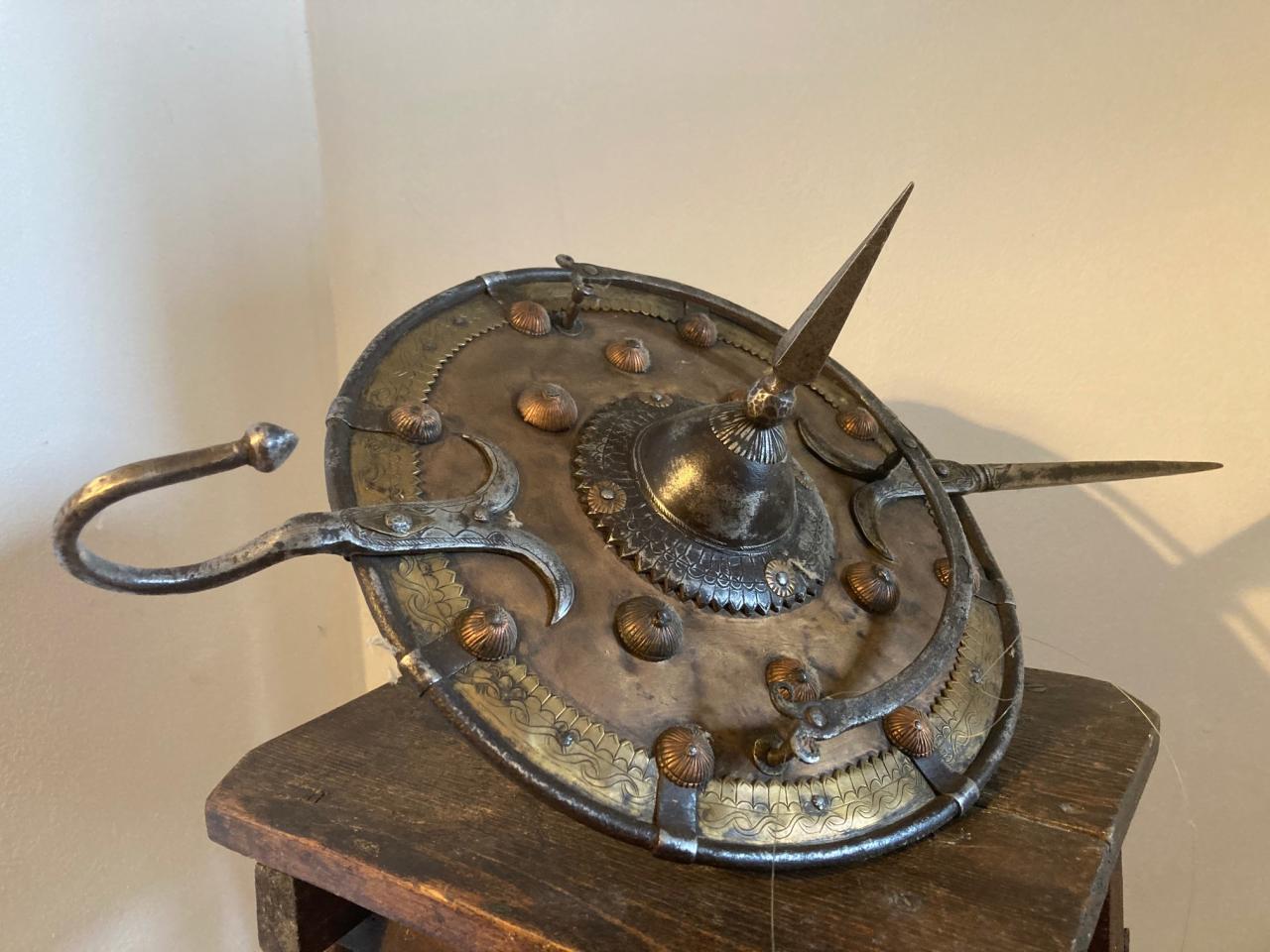

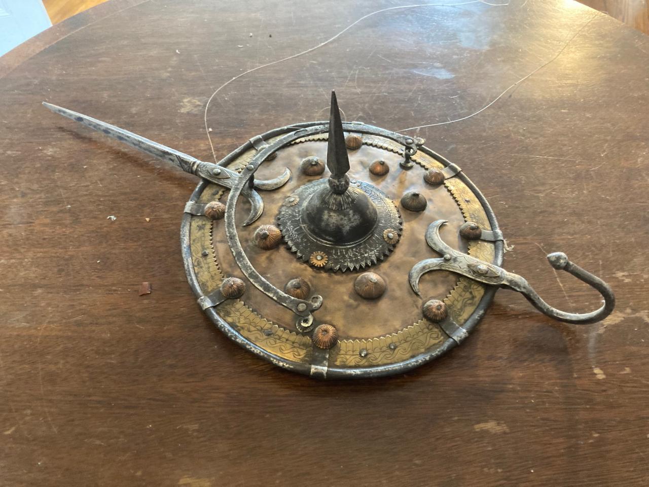

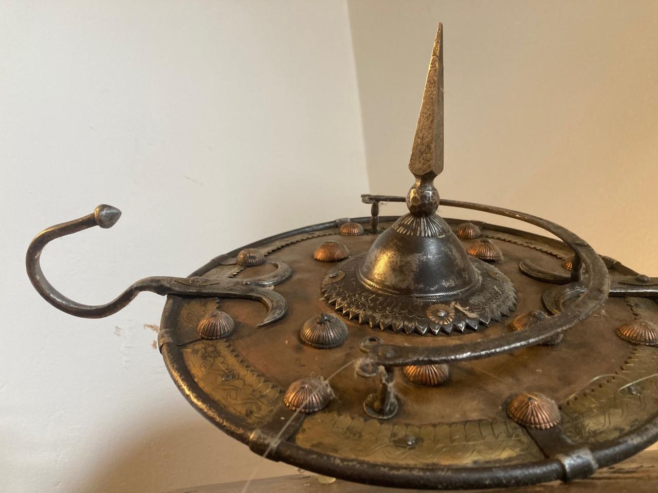

Hi all,
I picked up this shield from auction a few years back out of intense curiosity. Such an imaginative design, but is it practical?
Online research seems to place it from East India, with the people of Santal, Santhal or Sontal.
Mandarin Mansions offered up some fascinating insight into a similar shield of concave form, with some suggestion of it being a bullet stopper.
I've not found any pictures of a parry shield exactly like this one, other than past auction pics of this particular piece (it seems to have done some travelling).
I didn't have to fight hard to bag it at auction, which surprised me as although it's clearly not fancy, it's a pleasing example of combination/imaginative arms.

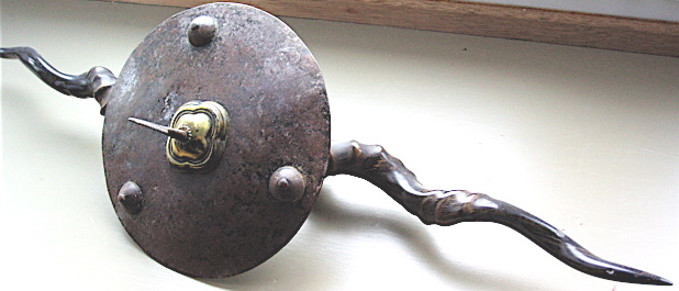

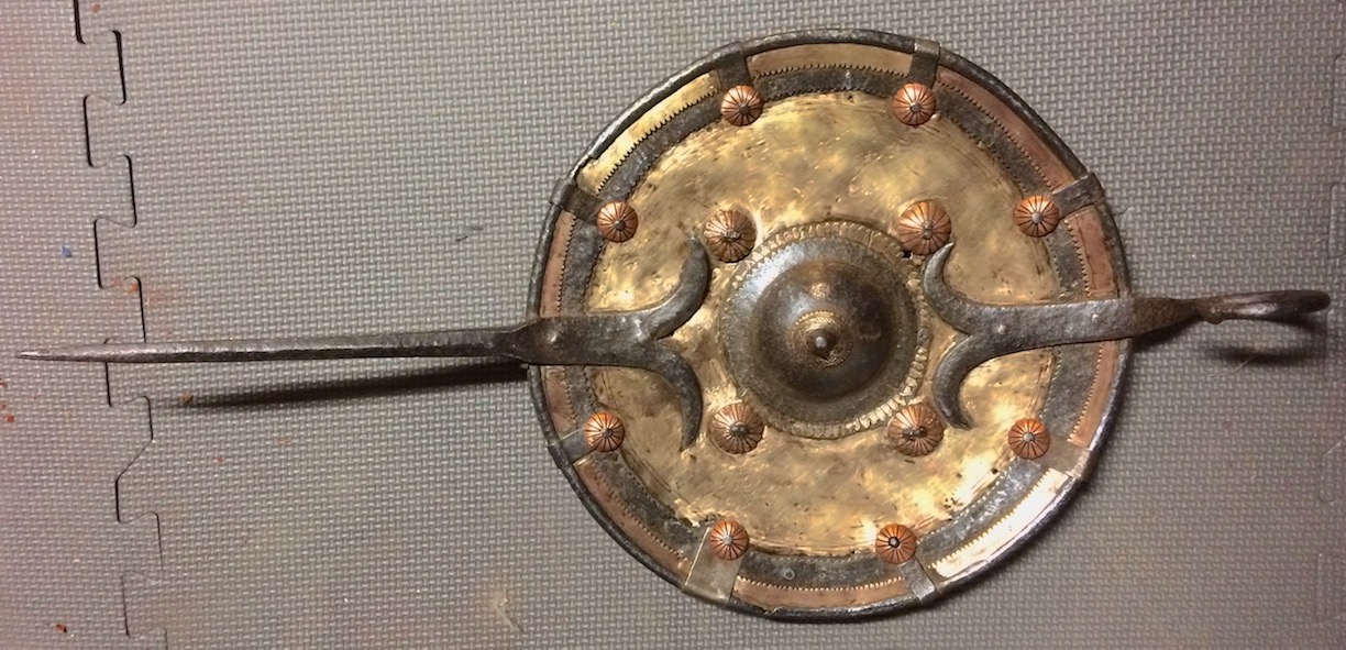

You have a nice complete, and spiked example there.
Here is mine for comparison.

Thanks for posting Battara.
Could I ask - is your example convex? Does the rim protrude out beyond the centre?
Osca is offline   Reply With Quote
Old 20th April 2026, 02:57 AM   #4
Posts: 7,405
Oh yes. Would have an interesting effect on attacking swords.
These are rare, and yours is a rare variant of the rare.

This is an absolutely fascinating example! and would seem of course perhaps to be 'one off' but for Battara's example posted (Thank you Jose!). This suggests that there must have been a certain convention for shields/bucklers with these curious added features.
Notable (and seen on both examples) is the hook, which rather than being a potential 'weapon' such as the spike and knife, would be perhaps thought of to snag or grab something, i.e. a weapon? This notion , while often suggested toward weapons features for such purposes, has not as far as I know, has not been proven viably.
Indian arms makers have it seems always been innovative, and the creation of combination arms has long been notably in place, it seems often to impress more often than to be effective in actual combat. Obviously not to say these features could not have been effective, however, in most cases, likely arms of this character were more for visual effect in certain events in the manner of gatherings of court notables etc. The British 'Imperial durbars' were the formal examples of these kinds of gatherings (1877, 1903 and 1911) and these brought the armorers of various regions to show their wares and these kinds of examples among others brought notable attention.

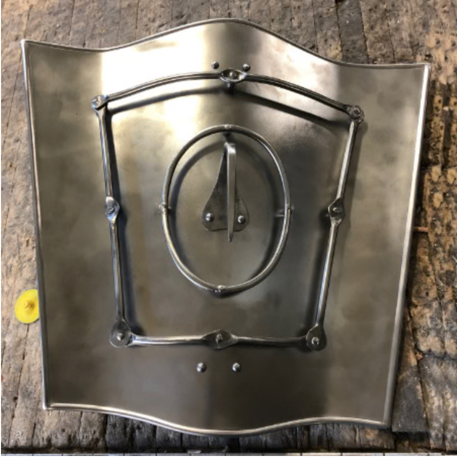

https://www.arms-n-armor.com/blogs/n...ers-and-targes

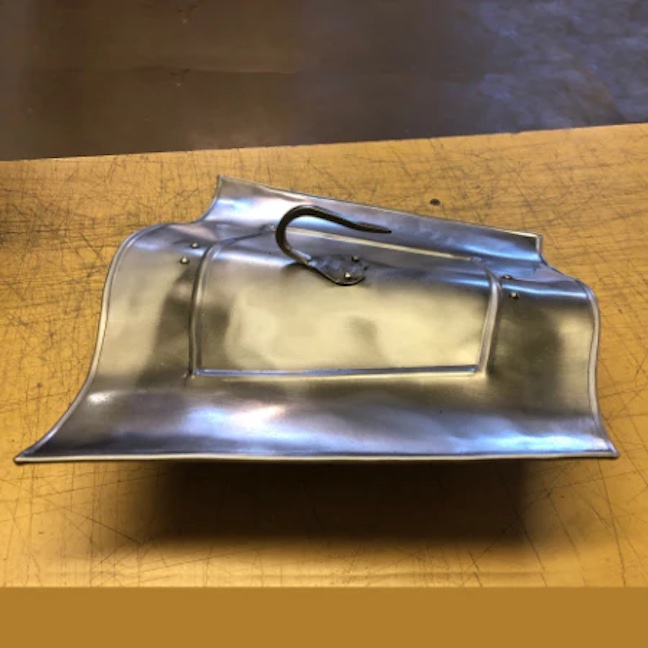

Old 25th April 2026, 01:02 AM   #10
Posts: 7,405
For our records:
Old 25th April 2026, 04:22 PM   #11
Posts: 10,860
Thank you Jose for entering the image, as noted for our records. The idea of these threads is to serve as an archived compendium of discussion, examples and material toward certain forms of arms through these. For those who use the SEARCH feature, as I do vehemently!!! these threads are a remarkable storehouse of knowledge!

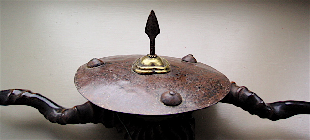

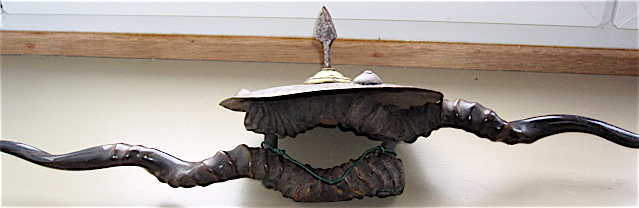

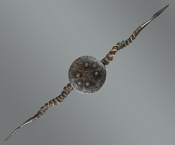

Hi,
My Madu style of buckler. Quite a basic example but on handling it I can see the usefulness of the concept of a small parrying shield with added pointy bits.
Norman.

Posts: 10,860
EXCELLENT EXAMPLE!!!
Would this be Rajput ? or can we be that specific? I like the way these horns are sort of stacked.

Hi Jim,
Apologies for the late reply, been away for a while. I've never been successful in determining an exact answer. Needless to say Jens would be the one that might give a clue but I haven't seen or heard from him on the Forum for a while. Hope all is well with you.
My Regards,
Norman.
Old 2nd May 2026, 08:14 PM   #15
Posts: 10,860
Hi Norman,
Thank you! Yeah, I think everybody is pretty busy these days, me too!
Actually it would be hard to assign any specific provenance to group or region on most Indian stuff with all the cross diffusion, whatever the case, yours is one of the most remarkable examples I've seen. Thanks again for posting it.
