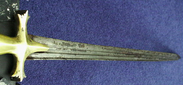

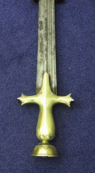

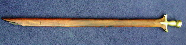

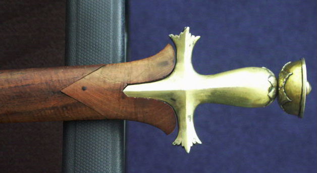

I got this sword from a Malay family in Malaysia. Hopefully to get your professional opinion on what kind of sword is this. Thanks in advance.

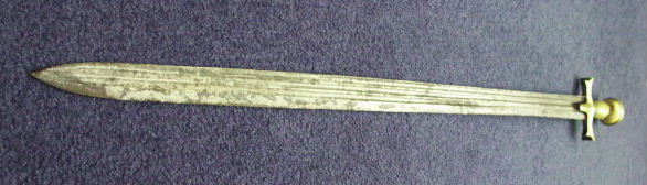

Default More pictures

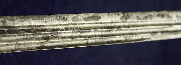

More pictures. Length in scabbard 36 inches, Length of blade 32 1/2 inches, width of blade 1 1/2 inches. About one quarter on top of blade is sharp (like the Malay Tempius) while the bottom edge is very sharp.

I'm no professional, but this is what I think.
The hilt, looks like a Batak Piso Pedang hilt. Normally the blade is curved. This example have a straight blade. The scabbard is unusual but was made for the blade, Malay-styled. Other more knowledgeable forumite can fill-in...
Old 1st September 2006, 03:39 PM   #4
I fully agree. Good catch. I certainly would not kick it out of my collection. I have a Piso Podang with old European straight blade: Portugese?
Is the blade plated?

The hilt has 'similar design' elements to the Tulwar.....but less restrictive...no large disc pommel. Is there any connection?
Old 1st September 2006, 06:00 PM   #6
This is a direct descendant. This hilt was brought to Sumatra by the Hindus. Elgood discusses an Indian sword with the same handle.

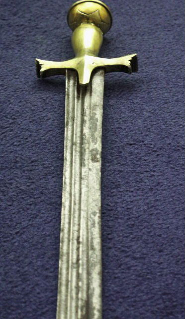

think this is definately rick's (rswords) territory, as i know he's done some research on these. they take direct influence from the early tulwar form of the 16thC (elgood shows a genuine moghul one in his latest book).
the blade looks as if its been cut down (the fullers travel to the end). wonder if the blade was taken from a firangi, as the style is of the same type.
i've always loved the shape of these things, maybe because i like early indian pieces.

Not unusual at all to have a Euro blade on these.

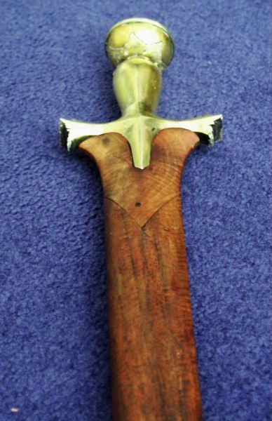

Thanks for the kind words Ian but I think most of what I could tell them has already been said. I do like the way the woods were mated at the mouth of the scabbard rather than making it all from a single piece of wood. A nice sword,

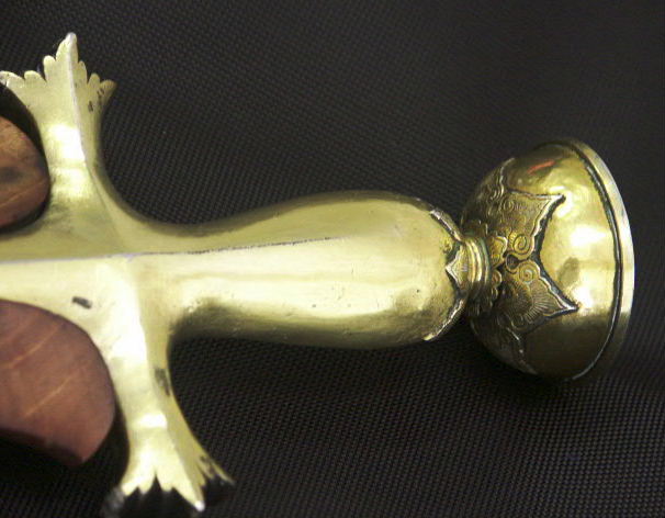

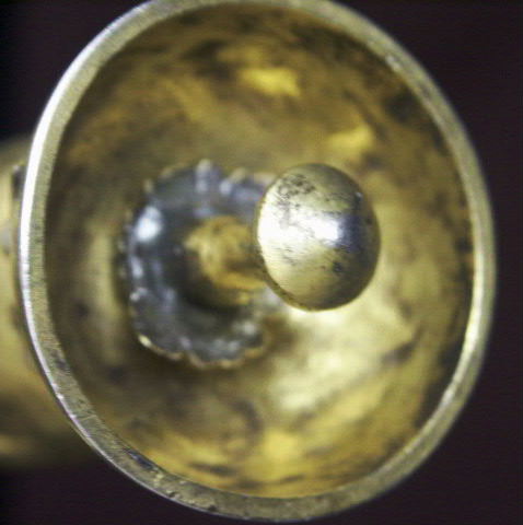

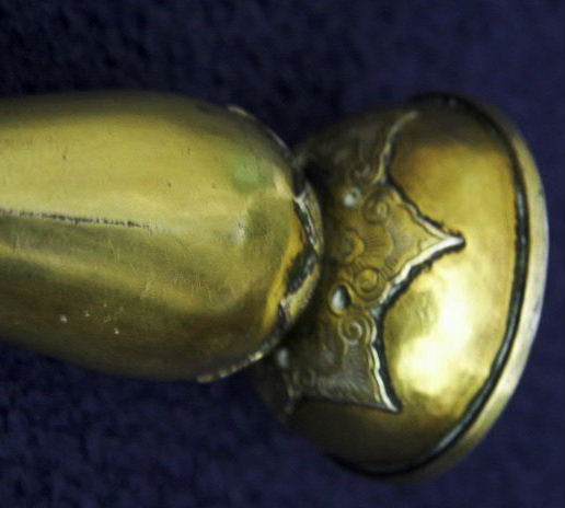

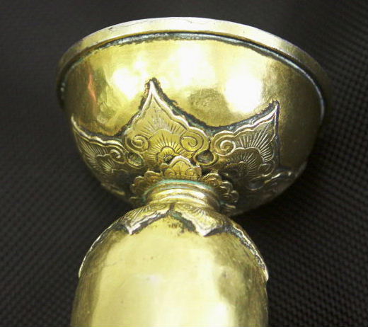

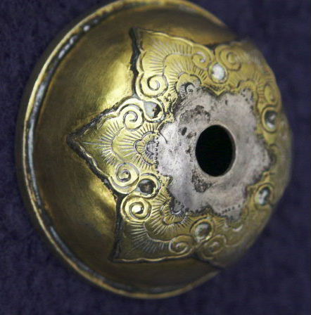

also, i had assumed this to be a brass hilt, as most were. but from the tang button and the detached pommel, it seems to be gilt. is this the case? what material is the hilt made from?

Well as I said above all I know has mostly been added. This is called a piso podang by stone and von Zonneveld , The curved ones are referred to by Gardner as "pedang shamshir" ( G. B. Gardner in KERIS AND OTHER MALAY WEAPONS). Piso may be a variant of the word pisau , and podang peudeung and pedang certainly have similar roots ( in my mind at least ) .
With Piso Podang the hilt is usually cast in one piece where the hilt of many tulwar are cast in two pieces and joined . They are known to have local blades, indian blades, european blades and even rarely wootz blades. These swords (Piso Podang) are most commanly found amongst the Batak in Sumatra. However, there are appearantly some references that do show Iban Dayak carrying Piso Podang. It should be noted that the Batak are non-islamic( Actually Batak is a general name for 6 groups with different cultural and linguistic characteristics, but they believe in a descent of a common ancestor) , and most references to them do not tell of their origin but do talk of the Hindu and Chinese influence. It is believed this sword form came through the Hindu influence as noted above

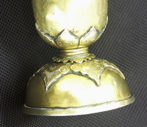

Default More pics
Here some more close-up pics of the hilt. This sword actually was acquired from an old Minangkabau family living in Negeri Sembilan, Malaysia. It was told that it was their only pusaka (heirloom).
mykeris is offline   Reply With Quote

The blade is straight and is 36 inches long in scabbard even longer than the ordinary batak's swords of only 27 inches. Dont you think, the blade was originally taken from any English swords or something else?

I think Rhys-Michael and the others have pretty well covered the established data on these swords from N.Sumatran regions and Battak tribes. I see what you're getting at though on the probable origins of the clearly tulwar type hilt. While the typological appearance clearly suggests associations with the tulwar, the cupped pommel rather than disc seems to indicate that there could be a possibility of influence from earlier hilts of the Indian subcontinent.

The blade on this example seems likely a military horsemans blade, and certainly European, thus could have arrived via these trade networks.
