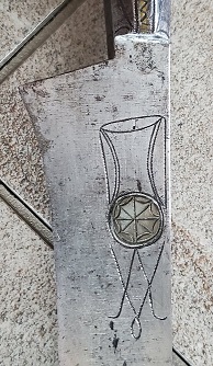

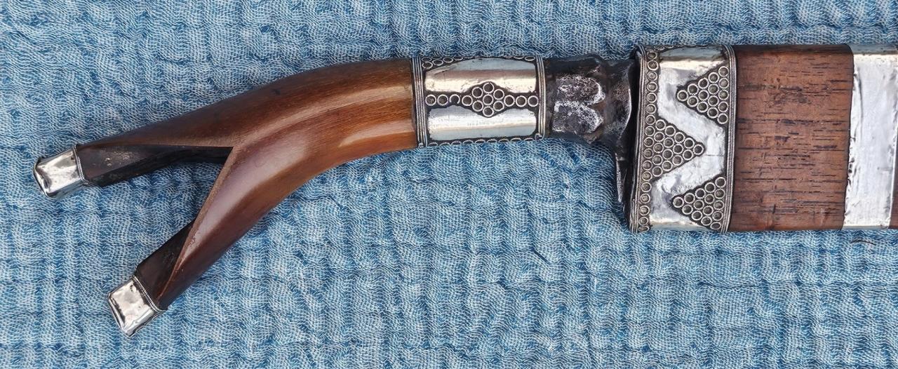

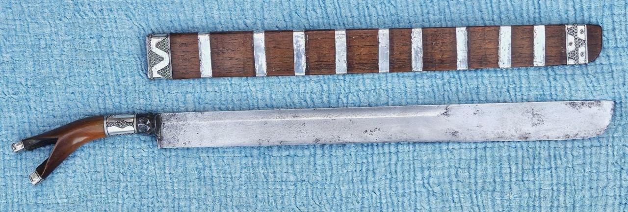

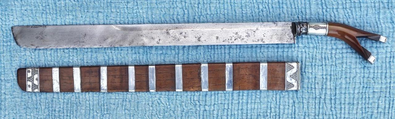

Yessss.... it arrived in good shape.
Took some pictures next to atjeh sikins for comparison.

A few daylight pictures.
Notice that the blade is a sikin, but much rougher in finish.
