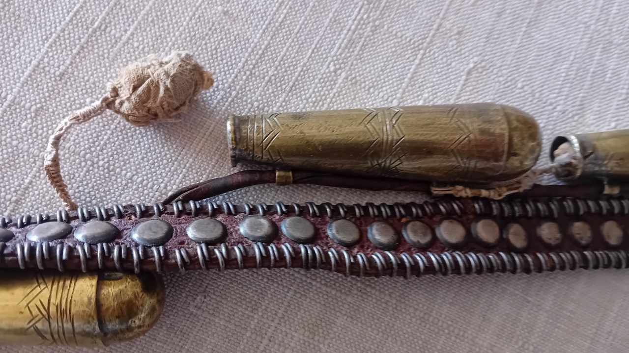

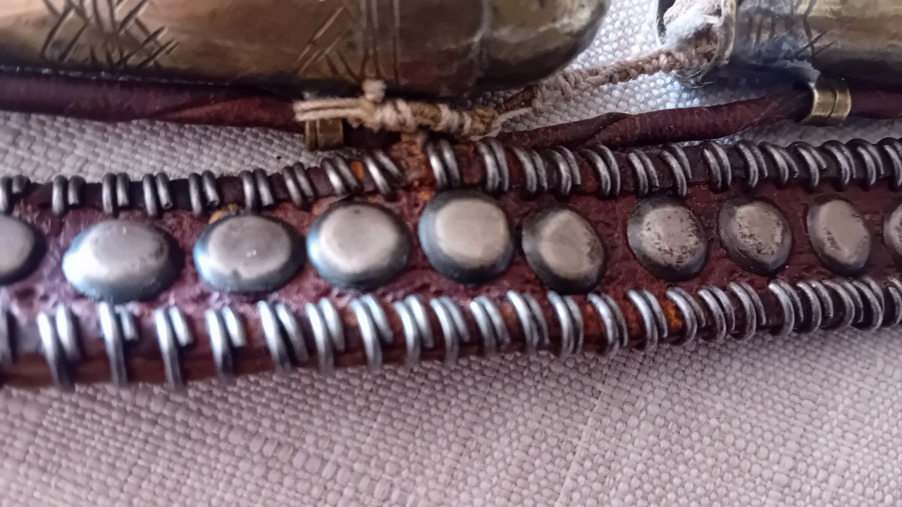

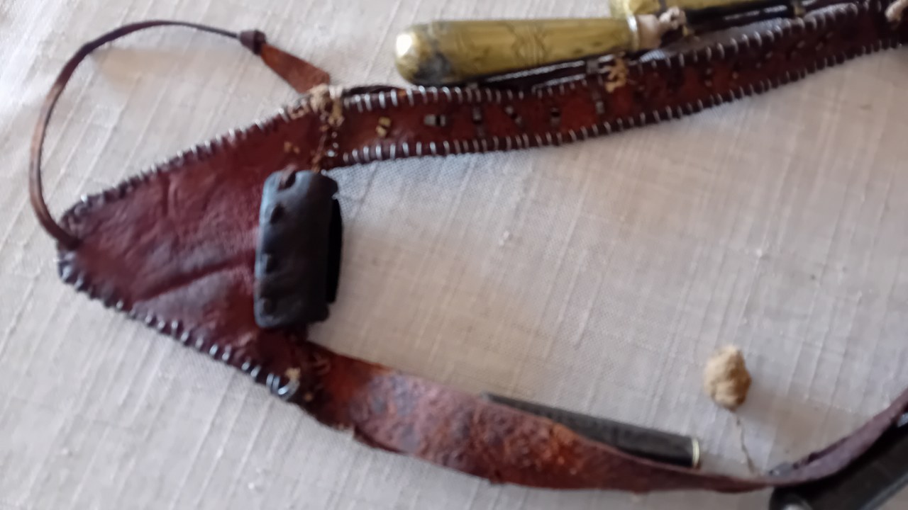

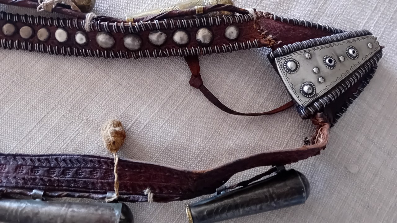

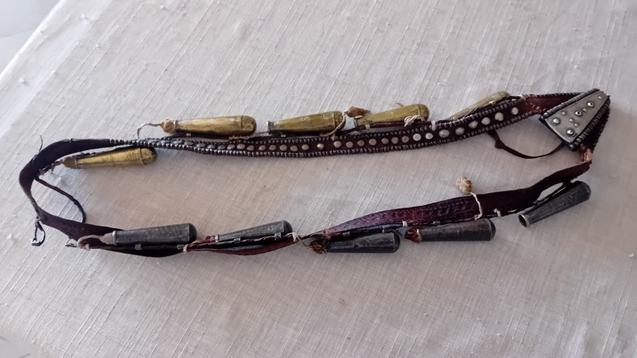

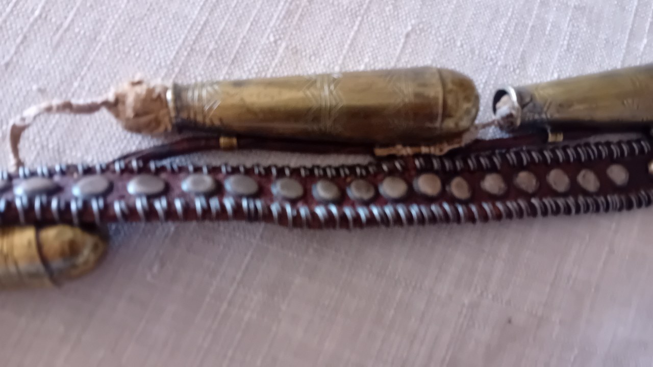

Here is some pictures from mine, the daggers are mine, and will be well detailled in my book inshallah
The set that display that same kind of work is sold by an auction house Ive asked for permission for my book, so please people dont share.., and obvioulsy algerian (note those 3 straigh flissa daggers), is to show that this work, dont necessary mean a "decorative" weapon, but just, in this era of algeria, a prestigious one.
